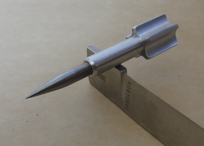

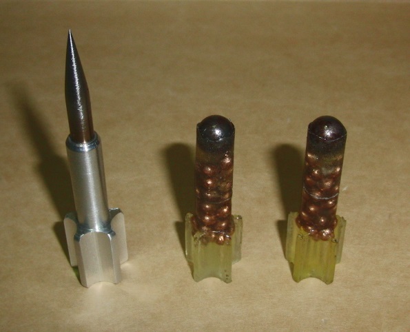

Hehe, that is looking sick!
Are you sure this isn't going to be another miniboy?
how much does the finished projectile weigh?
Hehe it didn't take that long to makeLabtecpower wrote:Are you sure this isn't going to be another miniboy?
Just over 18 grams, a bit light for a shotgun load but it should be enough. I think I'll make the others with brass bodies and delrin fins though.how much does the finished projectile weigh?

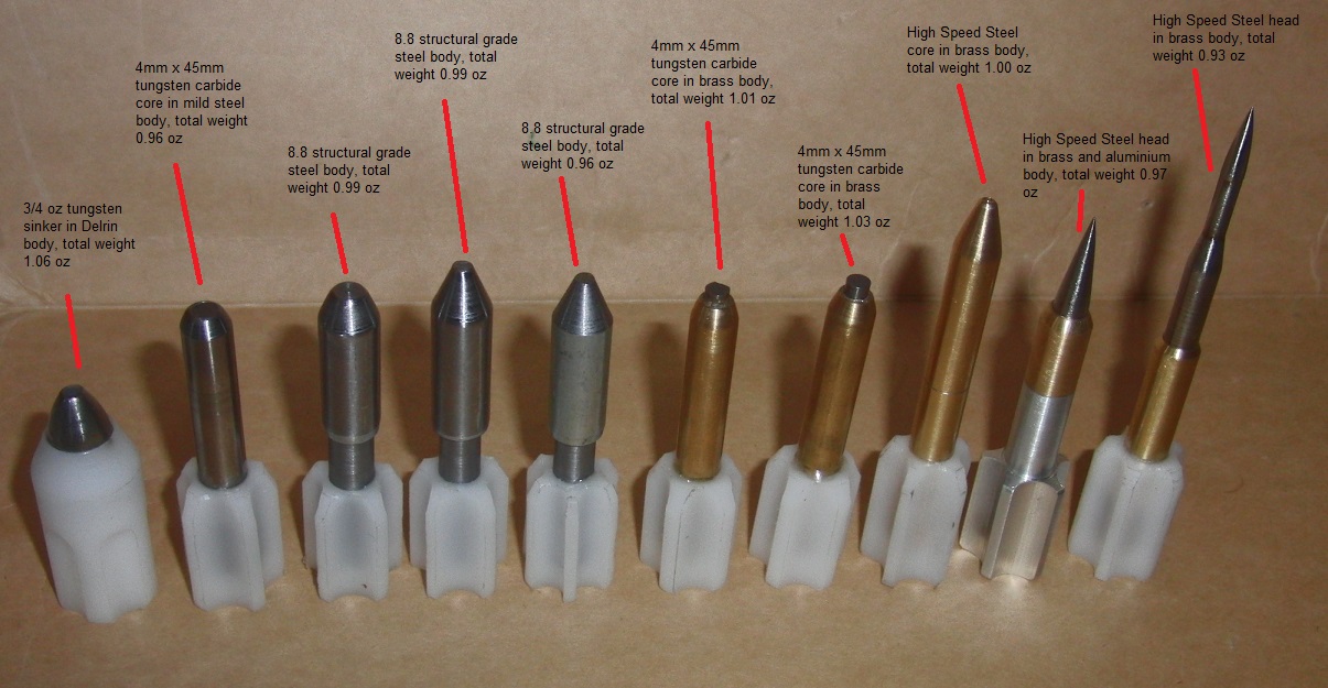

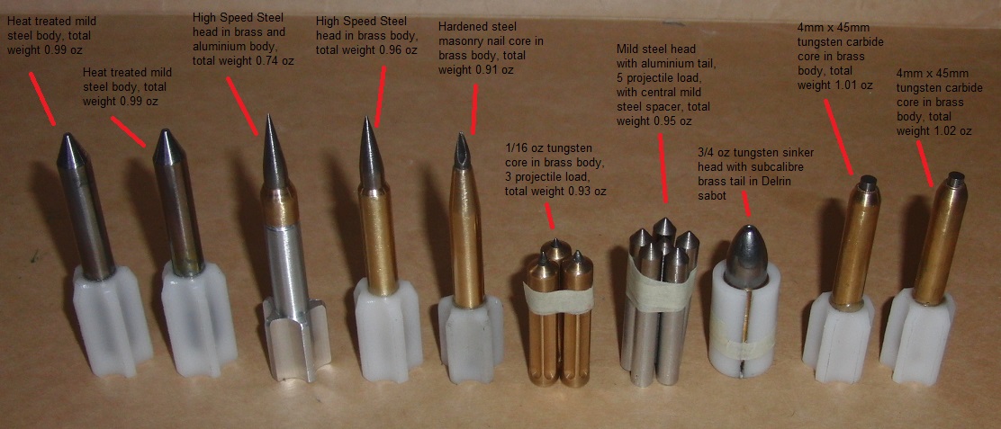

These are all for a 12 gauge shotgunLooks sick Jack, they better have a launcher that is deserving of such works of art...
I figured they could do with less improvised rounds...

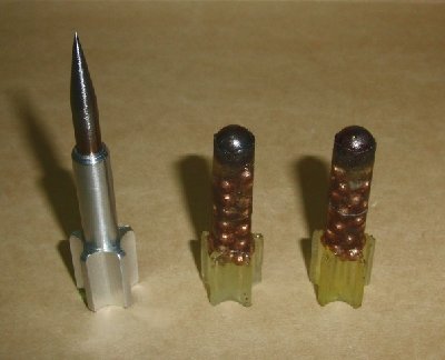

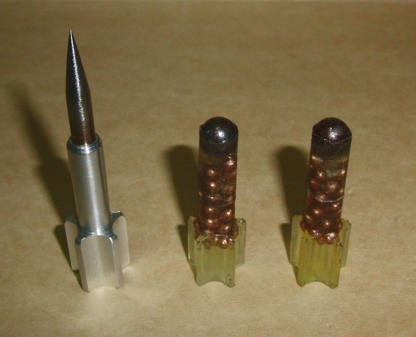

Way ahead of you there, see attached pic. They're a bit light though, around 0.6 oz.dart guy wrote:jsr, would moulding epoxy around the nails be cheaper?
The idea is that they would act like Frangible Armor Piercing rounds, where they would penetrate a hard layer and break up in the process having a shotgun effect behind it.
If you watch the video they tried lead slugs already, that's not a good idea for penetrating armor - in general you want your projectile to be harder than whatever you're trying to penetrate - although if it's going fast enough even copper will penetrate hardened steel.also i think that you should make a lead bodyed slug for demolition ranch and tell them to blow the livin crap out of the armor plate
