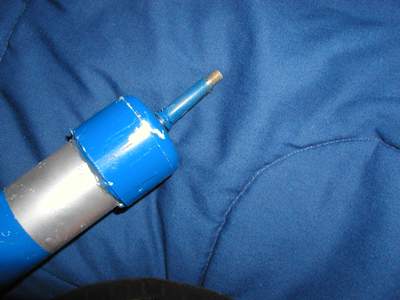

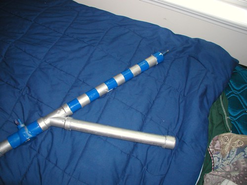

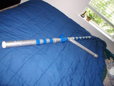

here is my ball valve pneumatic although its a ball valve it can shoot golf balls very far (much farther than my golf ball combustion) the golf ball barrel is not pictured here.

the gun
the gun

Nice DWV fittings!( don't take it past 65 psi)
Plastic ball valves are a bitch:(
but looks fun.
thespeedycicada
Posts: 429
Joined: Sun Aug 12, 2007 1:28 am
actually its sch 40 i have taken it to 90 psi
frankrede
Posts: 3220
actually you have no idea what your talking about and when I tell you its DWV, its because its DWV.
spud yeti
Posts: 1030
This looks like a decent cannon. Approximately how far can it shoot golfballs?
sch is just the wall thickness, so you must get pressure rated fittings, they two different things. Otherwise you might get some pretty silver and blue additions to your body in the form of schrapnel :? .
really good quote/phrase here
Panzerfaust
Posts: 129
Joined: Tue Apr 17, 2007 4:37 pm
Sch 40 does not mean pressure rated, you can tell by the shape that your fittings are DWV. Be carefull taking that above 60 ish psi... and never use it in cold weather. Also as frankrede said, plastic ball valves kind of suck. If you can get a meral on it will be much easier and faster openeing, which will improve your performance.
thespeedycicada
Posts: 429
It is pressure rated to more than 100 psi i think if it wasnt painted i would show you.As for the distance i dont know but its far and at 90 psi it can make a hole in half inch ply wood at close range.
spud yeti
Posts: 1030
We are talking about your fittings, not the actual pipe by the way.
frankrede
Posts: 3220
thespeedycicada wrote:It is pressure rated to more than 100 psi i think if it wasnt painted i would show you.As for the distance i dont know but its far and at 90 psi it can make a hole in half inch ply wood at close range.
How many fucking people does it take to tell you something? Get it though your head, your Wye is DWV, not pressure rated.
thespeedycicada
Posts: 429
ok sorry im still a noob with this.But hey i learned something! thanx
spud yeti
Posts: 1030
Its all good, maybe next time just be a little more accepting of the facts given :wink:
frankrede
Posts: 3220
thespeedycicada wrote:ok sorry im still a noob with this.But hey i learned something! thanx
No problem, just trying to help you out, as harsh as I might be, excuse me.
noname
Posts: 2698
Location: Bay Area, CA
Cut the Wye fitting off and replace it with a T and a 45* elbow if you still want that configuration. It is NOT Sch 40, as a matter of fact. DWV PVC fittings are now SDR 35, ABS is usually Sch 40.
frankrede
Posts: 3220
I have seen sch-40 pvc dwv noname. but that is beside the point/
mike1010
Posts: 197
Joined: Thu Jun 21, 2007 6:38 pm
actually i have seen sch-40 dwv too at home depot and it was solid wall and rated to at 200 psi for 2 inch but i still stay away from it. if you want to use wye's just make an abs gun and keep the psi below 60 then if you do take it up too high you wont actually kill yourself
