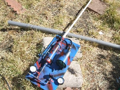

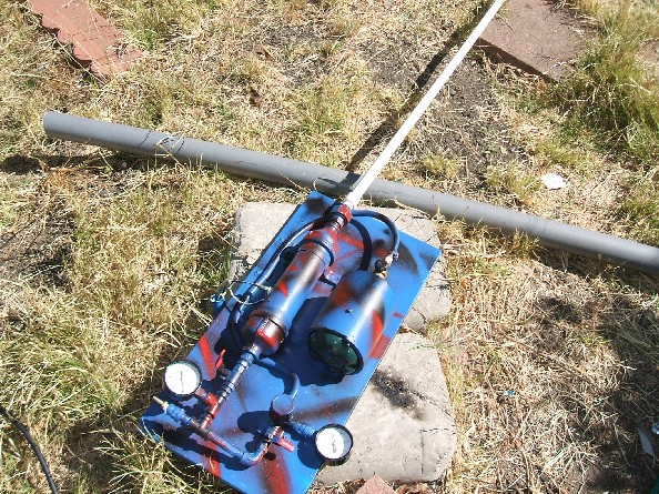

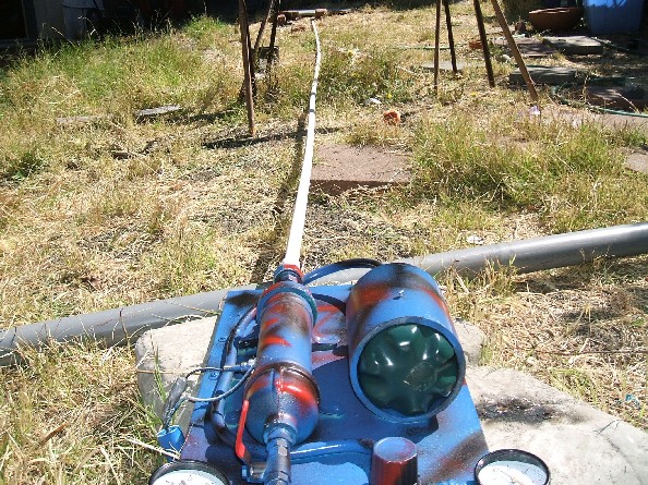

Just trying to get confirmation on this, because I'm pretty sure the gun is shooting supersonic but have no way of telling for sure. GGDT predicts that using an 8 gram ball bearing as a projectile, the gun shoots at 1700-2000 fps, depending on generous or crappy values.
Chamber diameter: 2"
Chamber length: 11"
Pressure: at least 575 psi
Temperature: It's like 2000-3000*, right?
Valve Type: Burst Disc
# of Valves: 1
Flow Coef: a good piston valve is like 40% or something, right? So a burst disc would be 50-60%?
Seat diameter: .7"
Dead Volume: .3 in^3
Barrel Bore: .63"
Length: 240"
Projectile Friction: Almost none, 1 psi or less
Projectile mass: 8 grams (measured on a triple beam balance)
Diameter: .62"
Initial Position: .5"
Does it all sound right?
I know it shoots a hell of a lot harder than with the 6 foot barrel; I can put a ball bearing through 5+ inches of wood. If I shoot without a projectile, I hear a sound like air being released, kind of like a quieter piston valve. With a projectile, I get a massive rifle-like CRACK! sound.

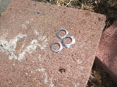

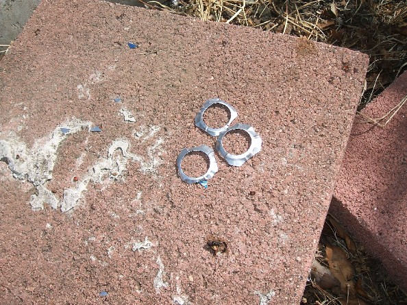

A triple layer of soda can burst discs holds 550+ psi in a 1/2" union.

Wow, I like it. I don't know about supersonic, hybrids aren't one of my specialties. I do, however, know that if you're putting a ball bearing through 5 inches of wood, I WANT ONE!
That barrel is crazy long and bendy, could you shoot around a corner with it? That would be sweet.

It's no ttoo hard to make one; just use steel and you won't kill yourself. I think I could shoot around a corner if I had a thicker barrel, but then it wouldn't bend, would it? :? The force from a ball bearing going around the curve would probably crack/shatter the barrel.
