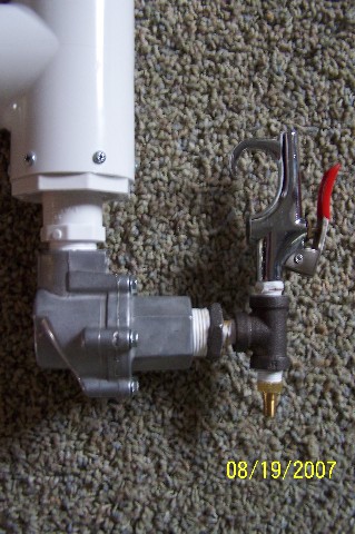

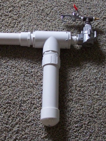

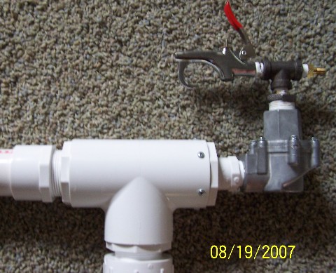

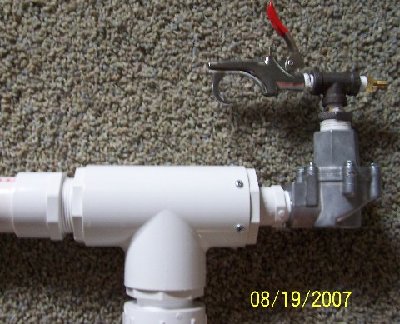

My new barrel sealing piston valve! Housed completely in a 2" tee, with 1.5" porting.

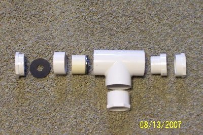

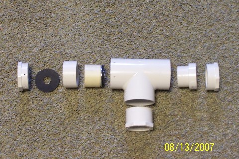

Piston:
1 1/4" Sch 40 endcap
2- 2" neoprene washers
1" washer
1/4" bolt
Filled with expanding foam (layer of hot glue on top)
Pilot:
~ 4 cubic inches of pilot volume
3/4" QEV
1/4" blowgun valve
Silicone grease was used to seal the piston to the barrel, 100% silicone was used to seal the back cap on. Bumper is a 2 1/4" x 3/4" neoprene washer.
I just tested it this morning, and it is perfectly airtight, and very, very loud! The small chamber in the picture is just a test chamber, expect to see something better in the future. Questions? Comments?

Very nice. I need to redesign my valve to be more like yours, cause mine has excessive piston travel...
Thank you for all the compliments. Origin, I spent many hours sifting through most of Spudfiles, only to find your How-To after I had finished the valve, which ironically was the exact same design as mine(with a different piston design of course)
However, my back cap seems to be leaking around the screws despite the silicone sealant, I will have to look for the gasket you told me about in one of your valve post.

Your gasket is the same as mine, you just need to make a new back cap that squishes the gasket more when the srews are in. You have less piston travel, and probably a better fitting piston than mine does which makes opening time alot better. I think I will build a new valve...

Did you just put the screws into the back cap, or do you need some type of gasket material to make them airtight? I'm building a valve similar to yours, but I think I drilled too large pilot holes

A gasket or O-ring is needed to make it airtightDid you just put the screws into the back cap, or do you need some type of gasket material to make them airtight?

The pilot holes I think are the holes drilled into the T before hand that you put the screws into later.spud yeti wrote:A gasket or O-ring is needed to make it airtightDid you just put the screws into the back cap, or do you need some type of gasket material to make them airtight?
Pilot holes? What part is this for?I think I drilled too large pilot holes
Yes, I used a neoprene washer to seal the back cap, along with silicone sealant, and the pilot holes for the screws should be small enough that it takes some effort to screw them in, and they leave grooves in the pvc.
