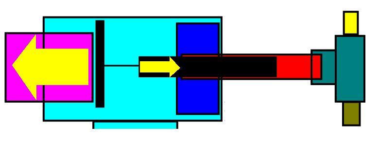

The force pushing the piston against the barrel is stronger than the force on the pilot side of the piston. Thus, it will never fire.
Look at it this way:
when the light blue area is pressurised, the yellow arrows show the force which the air pressure is putting on the piston. Since the barrel end has a larger area, there is more space for the air to exert pressure therefore a greater force.
This means that even if your pilot area is totally empty, the force towards the barrel will always be greater than the force towards the pilot, therefore as long as the chamber is pressurised the piston will never move.

The only way it might work is if you make it like this, with a long piston travel and two-part piston:
That way, the rear part of the piston will have time to accelerate and thus build up a force that is greater than the air keeping the barrel sealed.
