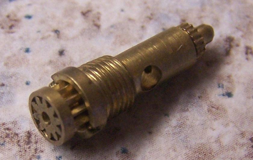

I recently discovered a great way to fuel minis, I think you guys will like it. You dont have to worry about getting a good fuel mixture, and if you do it right you dont even have to vent the chamber. It uses the Venturi system from a mini-torch, like the ones you find in gas stations (not a regular lighter, the ones that have a hot blue flame). The parts you'll need for it are the torch, a long-stem lighter (for the fuel canister and tubing), and a few small screwdrivers to disassemble the lighter.
First off, you need to seperate the venturi (just so you know, the end of the venturi is where the flame comes out) from the body and fuel canister of the lighter. Most mini-torches have a small phillips screw at the bottom, this usually will allow most of the lighter to come apart.

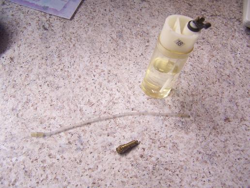

From there, seperate the butane canister from the venturi (usually connected by a small rubber hose), then unscrew the venturi from the torch body. If you did it right, you should have what is showing in the pic labeled "Venturi".
To use it in a gun, you'll need to drill a hole just a bit smaller than the threads in the chamber (Pill bottles will do great with these), then use a small wire stuck in the end of the venturi to guide it into that hole from the inside of the chamber. When you have it through, use a pair of pliers to twist the threads in from the outside. Connect the fuel hose to the small barb at the bottom of the venturi, and thats it.
Make sure the chamber isn't sealed when you inject fuel, the back pressure prevents the venturi from injecting the correct fuel:air ratio.
