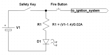

I am almost finished with my ignition box for my combustion, but there is one part of the box I can't seem to figure out. It has a keyed saftey switch and a momentaary firing switch. What I want to do is install a LED to indicate that the saftey switch is on. The power supply is 2 rechargeable 9v batteries, each supplying 170mA. I just don't know how to lower the voltage enough to supply power to the LED. If I use a voltage reg, the lowest I can get down to is 5v. The LED I plan on using is rated for 1.7v at 20mA. Any help/suggestions will be greatly appreciated!

you shouldn't need to lower the voltage for the led just lower the current, put a 1k resistor before the led and it should be fine (works out to be 18mA at 18 volts)

Almost all LEDs are ~1.4V devices. There are a few as low as 0.7V and some as high as several volts, but those are pretty rare.
Just wire a resistor and the LED in series after the key switch.
The value of the resistor is;
R = (power supply voltage - voltage drop of LED) / (current draw of LED)
"voltage drop of LED" is usuall 1.4V
"current draw of LED" is usually 20 to 30 milliamps
If your two 9V batteries are in series then;
R = (18V-1.4V)/0.025A = 664 Ohms
EDIT:
Ooops, left something out. LEDs are not usually run from athis high a voltage. So, you need to worry about the amount of power dissipated in the resistor and make sure the resistors power ratings isn't exceeded.
Power = (Voltage)(Current)
If the power supply is 18V (2x9V) and the current is 0.025A then the power dissipated in the resistor is (18V-1.4V)(0.025A) = 0.42 watts. The most common size resistors are only rated to 0.25 watts. At 0.42W a 0.25W resistor will get very hot. So, you should either use a 0.5 watt resistor, or you can use two 330 Ohm resistors in series, this give the need 660 Ohms, a voltage drop across each resistor of 8.3V and the power dissipated in each resistor is (8.3V)(0.025A) = 0.21 watts, well within the spec. for quarter watt resistors.
EDIT:
- led_circ.gif (8.05 KiB) Viewed 3427 times
