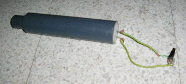

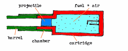

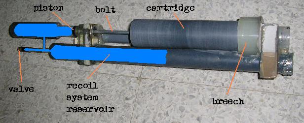

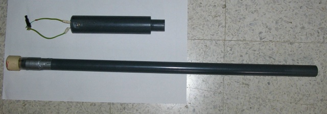

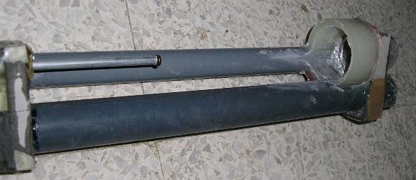

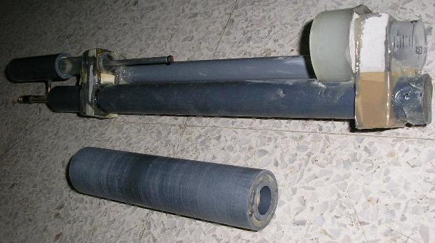

Just thought I'd host the diagrams and photos from my R&D into combustion cartridges here as they no longer appear in the archived spudtech thread.
v.2 breech at rest
v.2 breech at rest
3/4" cartridge v.2 with breech
3/4" cartridge v.2 breech area with pneumatic recoil buffer
3/4" cartridge v.2 construction

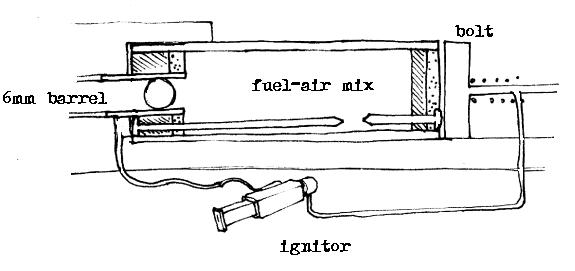

6mm co-axial cartridge design
6mm cartridge prototype
6mm cartridge design
breech area for 3/4" cartridge v.1 design
3/4" cartridge prototype v.1 with test 3/4" barrel

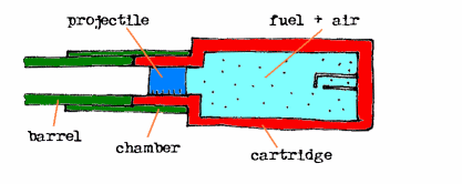

original cartridge construction
operating principle
operating principle

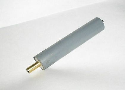

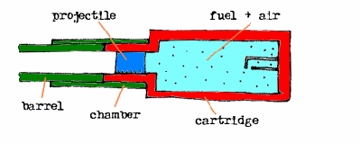

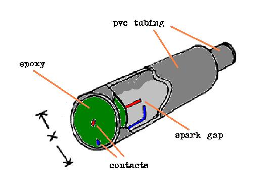

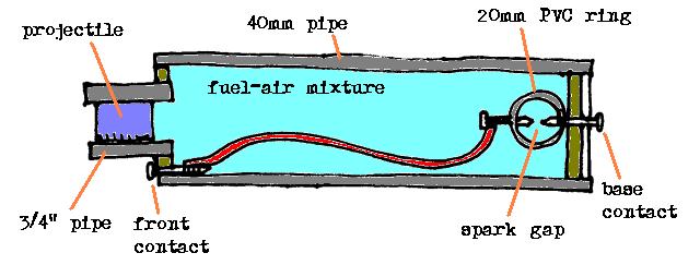

The 6mm cart was a real sissy of a round and next to useless but the 3/4" one worked quite well and was powerful enough to easily put a marble through 1/4" ply, plus it had more than enough energy to eject the cartridge.
I still have the prototypes but I had put them aside as the "coaxial" style cartridge requires a certain precision to get things aligned and working smoothly, it's something I couldn't achieve with my limited tools. With combustions you need cartridges that are larger in diameter than the barrel to get enough power so the problem is unavoidable.
I might revisit the idea in the future but for no it's happily gathering dust on the shelf.

How dus the ejecting of the shel work?
Posts: 26220
Been thanked: 352 times
If you have a look here:
Note how the on the closed side of the breech, it narrows at the end. The base of the cartridge hits the edge, and simply tips outward towards the open end of the breech.
How would you revisit it in combustion though, better precision and workmanship/quality/functionality?

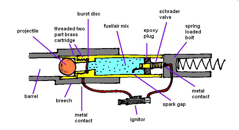

Ideally it would be a hybrid cartridge so it would have power to spare, but then it's too complex to make unless you had a machine shop.

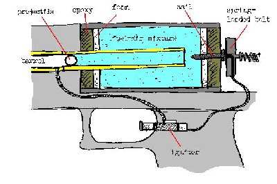

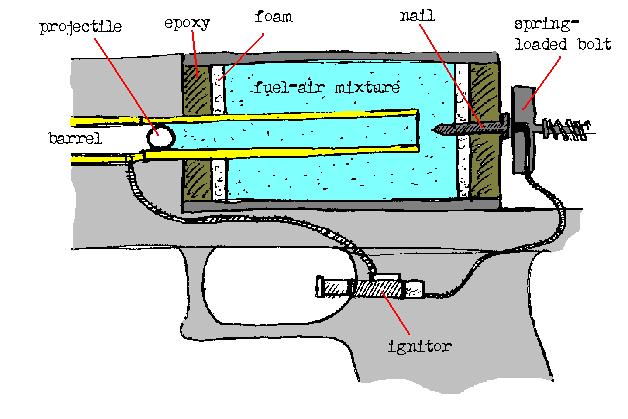

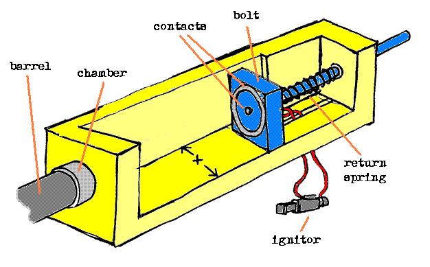

At hybrid level I see it as being powerful enough to work reliably in a firearm-style blowback configuration, my vision is something like the diagram attached.
Any takers with a lathe and machining 5k1LLz? :D
hybrid cartridge and action

Why not make it a oxy-propane hybrid so that you wouldn't have to have lathe skills?
Posts: 26220
FeLeX wrote:Why not make it a oxy-propane hybrid so that you wouldn't have to have lathe skills?
That's an idea...
FeLeX
Posts: 310
Joined: Sat Mar 10, 2007 10:45 pm
Just meter it out with a syringe and just inject it in there and put the marble in and there ya go. I mean it wont be that easy but a heck a lot easier then the traditional style.
Posts: 26220
My difficulty is that I'm not at all keen on working with oxygen, it's the giver of life and all that but nasty stuff when highly concentrated.
