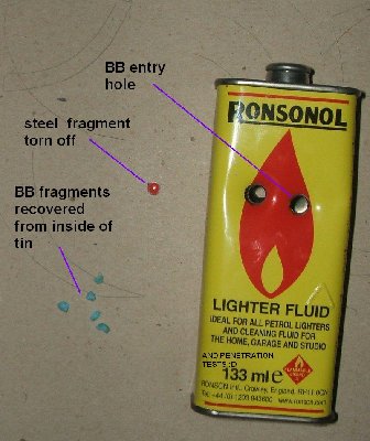

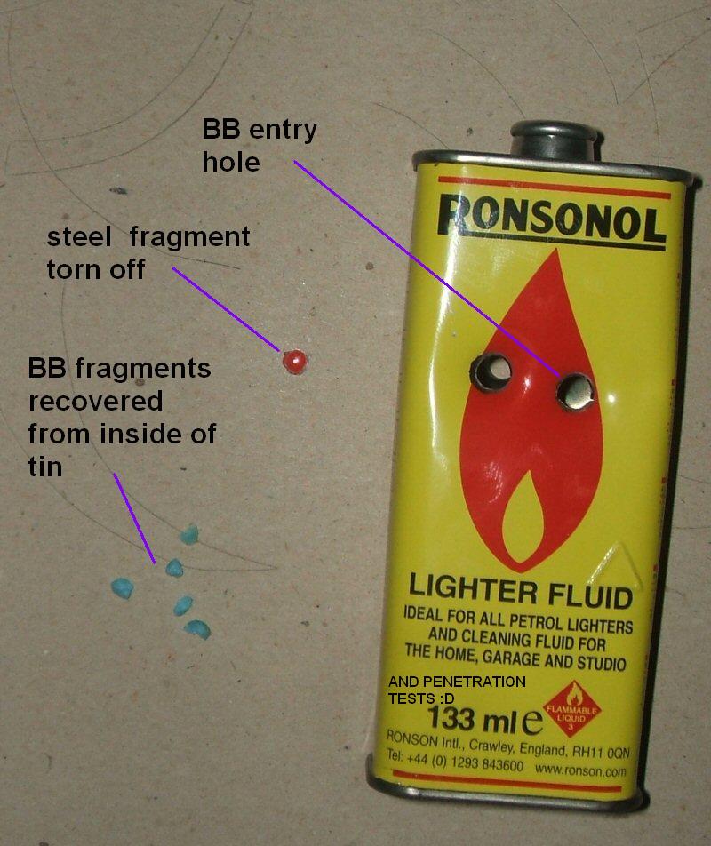

A high velocity impact will shatter a BB when striking hard objects, ironically I just did this myself with my
6mm burst disc launcher:
here's what was left:
