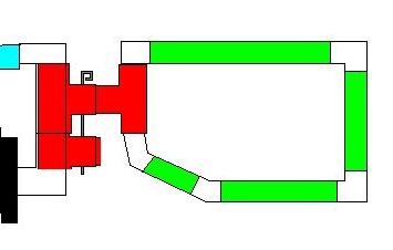

So after seeing Goat's Gun I finally figured out how to make my break action on my golf ball cannon work. See it here, http://www.spudfiles.com/forums/goats-gun-t7859.html.
In the past, I built a cannon that had a PVC folding stock. It worked out well except because of the size of the chamber it only folded say 150 degrees so it stuck out cockeyed from the gun. Not a huge deal but I want to make this one a bit more professional looking.
These pics show both the top view and the side view as planned. The two bend points are the red Tees that are sanded out so they slide all the way around the various pipes. There is no air inside the stock system.
My problem with this and the previous design was that I have no way of "locking" the stock in the open or closed positions so that it doesn't fold the wrong way or too far and can be changed quickly or for storage. Also the kick of the cannons would cause the stock to fold a bit when I fired.
The black is barrel and tank and what not, blue is valve. These parts make up the actual gun. The red is two tees both around their corresponding pipes that provide the bend points for the stock. The green is a fixed portion of the stock. Size and what not are not to scale and the design is just to show what is happening. Any thoughts about the design or any suggestions as to the locking situation would be greatly appreciated.

There is no leak, the tee that is attached to the vertical pipe is sanded/dremmeled out so it basically sleeves the actual gun. There is no air in the stock system.
@ Jack
That would work on the second joint attached to green part of the stock, but how could I do that with the first joint without punching a hole through a part of the gun carrying air?
Also seeing that stock you linked gave me some thought on a side-hinge for this thing. It would not only get the stock far enough over to fold up square with the tank and barrel but also give me one joint which is easier to lock. I will draw up some plans and post them on here to see what you and the others think.

Based on discussion earlier with Jack, you can see that we found a good way to lock one of the joints in the original design. Unfortunately, that doesn't help much with the second joint.
Remembering my good old days in the USAF, the most effective folding stock went to LEFT of the gun. It makes sense if you are right handed, your right never leaves the trigger even when flipping the stock around.
My major problem was that because of the diameter of the tank and barrel I had to get the stock a couple inches (I was thinking either 2 or 3 inch chamber, typical over-under or abit off center to the left to make room for the trigger) out from the center axis of the gun to make it fold all the way out of the way. The side hinge appears to do that.

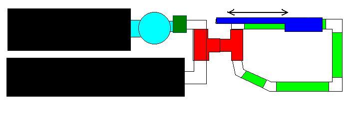

These two drawings show a side hinge idea. The side view would be basically the same as the side view from earlier posts, but the top view changes dramatically. You can see that Instead of a single line up to the valve I used two. That is not neccesary, but if I wanted to add on another 45 degree elbow to the stock, I could make a bumber for the other upright to stop the stock from over-swinging, thus possibly eliminating the need for Jack's locking mechanism.
The red part is again a tee that is sanded out to fit around the pipe carrying air. If I was to to do the bumber idea I could make the right side of the system so it is blocked off with no air movement and create a lock with a pin similar to Jack's idea there. Let me know what you think or if you have any ideas on making this work better.

Hi,
How about this: Split a pipe in half, but leave the last 10 cm or so. It must fit rather snugly around the stock pipe, but still clear the elbow fittings. Maybe you need to glue a smaller pipe inside the uncut section.
EDIT: Or just glue in a reducer in each end. Easy.
Aluminum would be really nice.
Somewhere on the gun, insert a sliding (or fixed) ring that the split pipe can jam into and stay in place. Or use zip ties, a hose clamp, or a band with one of those brackets for holding lids on containers, or whatever....
Regards
Soren
