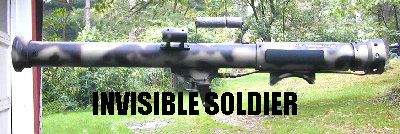

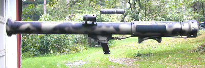

3" tube bazooka with piston control.
3/4 " alm. tube, 110 PSI

Awesome gun. Very realistic looking. Great paint job.

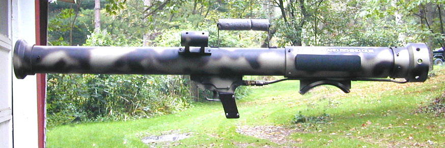

What are the barrel and chamber dimmensions? I assume they are inside a 3 inch sleeve, or if not how does your piston work inline?
Maybe I am just missing something. Coaxial maybe?

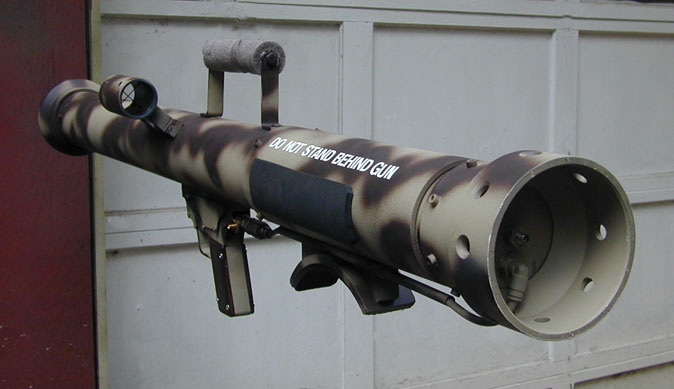

The barrel is 3/4" aluminum inside a 3" pvc pipe. The chamber is 3" pvc 14" long. The piston is spring loaded so you can load ammo first without charging, Very dangerous to charge first. I uses 110 LBS of air. The air release is in the gun handle.

That thing only has a 3/4" barrel :shock:
So the barrel runs coaxially through a big empty 3" sleeve? Does it have different barrels?
I expected something like a 2 inch barrel or 2 1/2.
How did you make the neat shoulder rest? It looks like a piece of 4 or 6 inch pipe. How is it attached? It is a great idea and really adds to the gun.

this is really great, awesome job dude and the paint job is cool. what kind of ammo do u shoot. could we see a pic of the business end? it even levitates! :D
