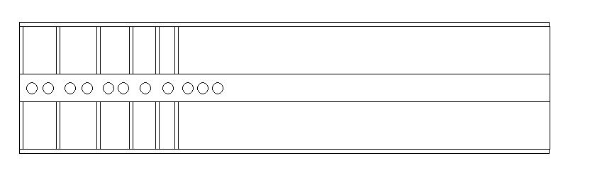

Why not have silencer integral over the whole barrel like this - it doesn't increase your overall length at all and allows you maximum volume.ALIHISGREAT wrote:i want to make the silencer detachable to make the cannon smaller for storage etc. so a 1m+ silencer (when you take into account the barrel inside the silencer ruducing volume) is just not realistic.

i would but i want powerjackssmirkingrevenge wrote:Why not have silencer integral over the whole barrel like this - it doesn't increase your overall length at all and allows you maximum volume.ALIHISGREAT wrote:i want to make the silencer detachable to make the cannon smaller for storage etc. so a 1m+ silencer (when you take into account the barrel inside the silencer ruducing volume) is just not realistic.
- Posts: 26220
- Been thanked: 352 times
If you're using the same barrel length, be prepared to lose out on some performance. The ideal (within the real of home workshop craftsmanship) integral suppressor should look something like the attached diagram, and stuffing sound absorbing material into the chambers should increase its effectiveness.
The thing with compressed air as a propellant is that the air pressure doesn't derive from heated gas as with firearms so it's more difficult to silence, particularly when using large volumes. A 0.22 rimfire rifle with a good silencer can be practically inaudible, but an air rifle producing similar ft/lbs would require a massive silencer by comparison.i would but i want power and surely the full barrel silencer would reduce power by quite alot because the air pressure behind the projectile would drop significantly more earlier in the barrel an reduce performance. it would work better as a silencer though and i will probably use it ona future cannon to see how quiet i can make one, a pnuematic could probably be almost completely silenced by a fell barrel silencer

I assume the "action" or valve is to the left in your picture close to the holes. Correct me if I am wrong.
Would it work to move the ports closer to halfway up the barrel with larger baffles toward the ends and smaller baffles in the middle? Would this be less effective?
It seems to me the farther I can get my projectile in the barrel before stealing its propulsion, the more power I harness. I know that only ports in the end of the barrel will be useless because the air won't have time to dissipate into the silencer, but at halfway there is still time to capture the majority of the air. Then a set of ports at the end of the barrel to catch the last little bit. Does this make sense?

yes it does, another way could be to use shaped baffles to redirect the air back wards and have the holes near the muzzle but have a full length silencer.williamfeldmann wrote:I assume the "action" or valve is to the left in your picture close to the holes. Correct me if I am wrong.
kind of like my crude punctuation drawing! excempt obviously the shaped baffles would not stick into the barrel they would just redirect the air back into the silencer chamber. and if that was a whole barrel the holes would start wher the astrix is.
No, the valve is actually on the right in this case - the idea is to let the projectile pick up speed before as you rightly pointed out robbing it of its motive power.
There are some integral firearm silencers where the porting starts at the breech as in the case of the HK MP5SD but the intention of this is to deliberately reduce the performance of standard supersonic 9mm ammunition in order to keep the bullets subsonic.

ahh i still could not do a full length one because of my breech loading setup
