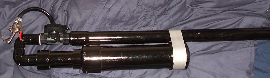

Well my gun is pretty much finished, I might give it another coat of paint if I get a chance and I'm still waiting on a green laser laser pointer which I'll use for aiming but apart from that shes done.
The 40mm barrel is 110cm long and the 80mm chamber is about 40cm. All the pipe is class18 (~Sch80)
I've only shot it at about 70PSI probably with a bike pump, but I'm going to buy a little compressor today. All shots in the video are potatoes at around 40PSI except the wooden steak.

This cannon look quite nice. I would replace the reducer (is that a reducer?) with a reduce bushing and replace the tape with a hose clamp.

how big is that sprinkler valve flow wise?

mopherman wrote:This cannon look quite nice. I would replace the reducer (is that a reducer?) with a reduce bushing and replace the tape with a hose clamp.
I can't find a hose clamp big enough anywhere. How on earth would I swap the reducer for a reduce bushing when its all glued? And why would I want to? Is a reduce bushing stronger or something?

Cut it off, 99% of the time bell reducers aren't pressure rated, bushings are.

Lentamentalisk wrote:how big is that sprinkler valve flow wise?
25mm or one inch

MrCrowley wrote:Cut it off, 99% of the time bell reducers aren't pressure rated, bushings are.
That reducer is class 18 or PN18 or something close to american Sch80. The parts are from a specialist plumbing store not bunnings or some hardware place, they look double or triple the thickness of DWV.

Nice gun, my first sprinkler gun was very close to that. Great job, the reducer does look like it isn't dwv. So I would say over one of the cleanest over under's with a sprinkler valve ever. :D
More pressure! You should be taking that to at least 150 psi, buy yourself a decent strirrup pump and exploit the power potentail ;)

spudgunnerwryyyyy wrote:I would say over one of the cleanest over under's with a sprinkler valve ever. :D
Wow thanks :shock: :o :D , this is my first proper pneumatic I had a dodgy little ball valve gun ages ago but the cops took it. I might try to make some kind of piston gun next, now I've got the hang of it, I have 60cm of class 18 80mm left over and a few other bits and pieces.
