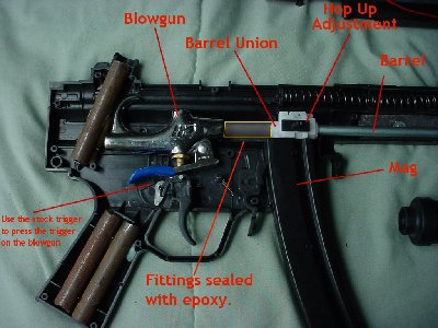

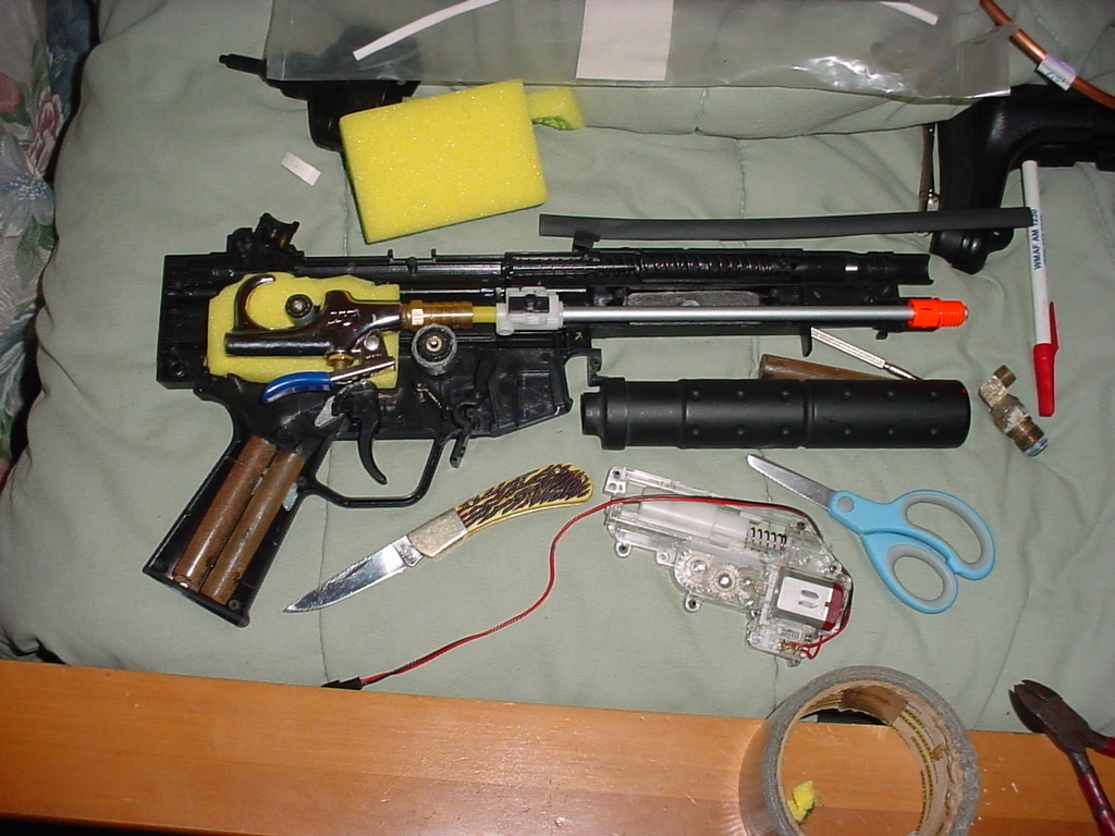

I'm going to try and keep mine simple since I've never built any type of strafer before. I'm just going to replace the gear box in my MP5 airsoft gun with a regular blowgun. I'm going to mount it in such a way that the stock trigger on the MP5 can be used. I'm using the stock barrel union/hop up assembly to feed BB's into the gun. I think this will work quiet well and should keep me from doing any major mod's to the gun itself. I'm still debating on how I'm going to power it, but I would like to try propane if it can feed the gun fast enough.
I've pretty much drawn out what I want to do on a picture I've taken of the MP5 with the blow gun inside it. If all goes well the only think that will look different will be a small quick connect fitting on the rear or in the handle.

very impressive, i suggest modding that blowgun. previous experiments with stock blowguns and airsoft bbs we rather pathetic only got fps in the 200 range.

Thanks for the incouragement guys. I'm laying everything out now, I should have everything I need to get it setup tonight. I would like to try Co2 if I can get it to fire and don't have any problems with the bb feed.

@ Singularity, I would definitley like to try modding the blowgun if it will leave bigger welts..

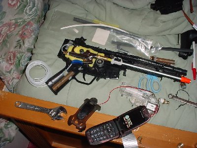

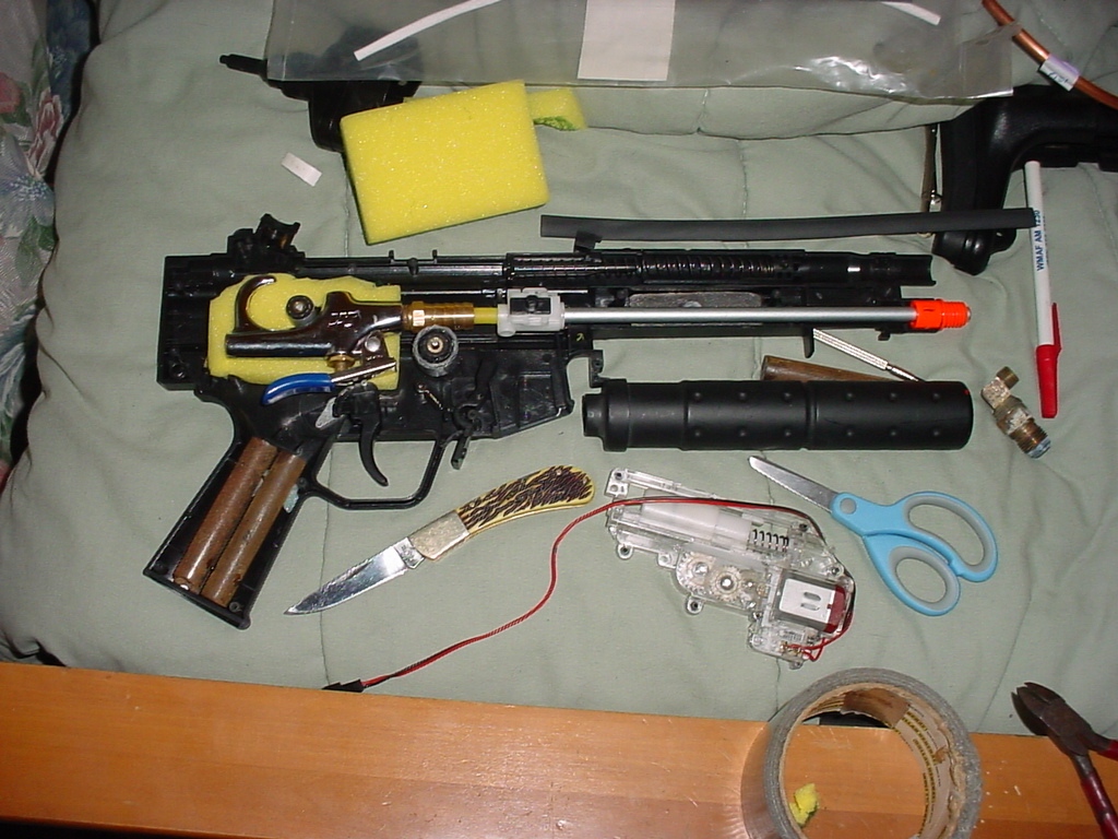

I think I have the trigger setup pretty good now. I used some hose barbs, dremeled them in half, then stuck some hose on them and rapped them in duct tape. I increased they're diameter with tape until they pressed against the gun's trigger just enough without pressing the blowguns trigger. It doesn't fully depress the blowguns trigger but doesn't miss by much.. I'm going to sandwich the blowgun between two sponges to make sure it stays straight.
I like the idea of the custom trigger but carving it up so that the spring will return it will be a PITA... If I have any trouble it will more then likely be the trigger setup or ammo feed.

Thats the cool thing about it. You can take an el cheapo airsoft gun and turn into a coke can penetrating spray and prayer. Right now that's wishful thinking but I think it will perform better then the plastic gearbox that used to power it.

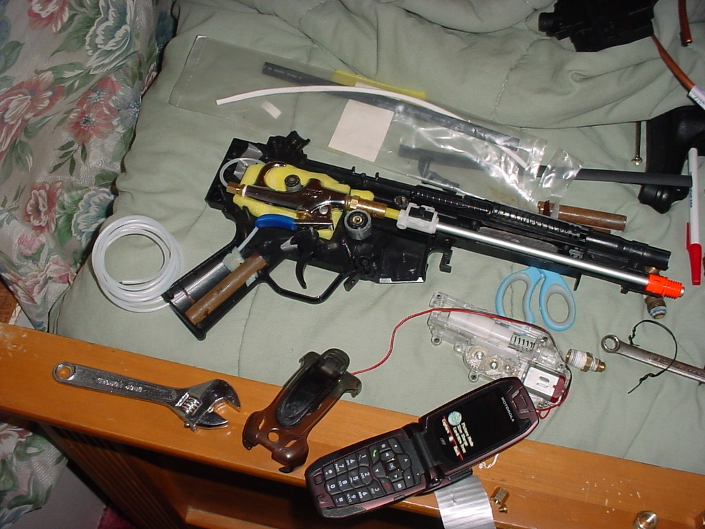

I just happen to have an old mechanical oil pressure gauge kit, so I used the fittings and hose from it.. The hose is super tiny so that will probably be my downfall if it doesn't shoot very hard. I will have to get some more fittings tomorrow to get it hooked up to the propane bottle. I've done everything that can be done inside the gun so i will put it back together and take some pics. I'm glad you guys like it, maybe we will get to see a new generation of strafer's.

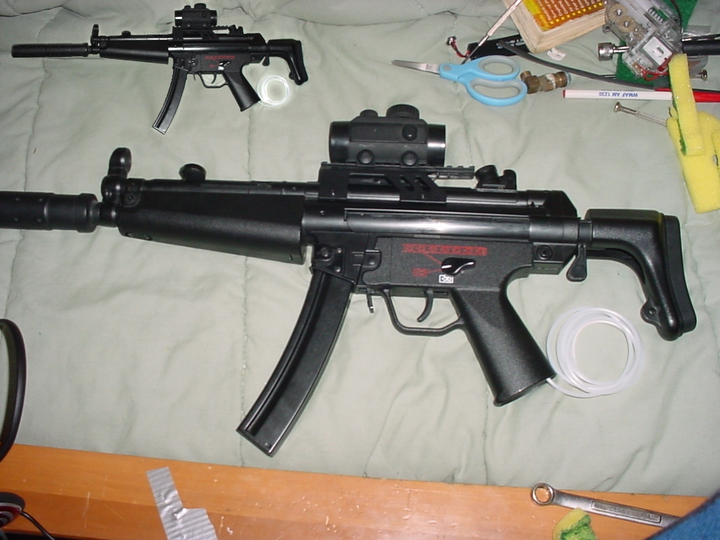

Dornep: I love how you used the original trigger, and I only have two things I'd like to see added: a stock(of course) and a longer barrel hidden by a fake suppressor, mimicking the SD version.
He does have one, it's retractable...windshrike wrote:@goose_man: Thank you so much. Do you happen to know the exact name of the part you bought?
