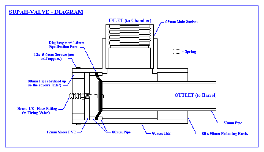

This is not my design, I was going to post it to help anyone that is intersted. So I will post the man's name who did the picture shown once I find the site.

wow benstern thats a little harsh. octane thanks for the diagram, im still learning how to make valves, havent made one yet but really want to. seems like i never have the right material. very detailed drawing.

benstern, thats not true, ive never seen that diagram. sure, ive made piston valves before, but not with that design.

seems to be a nice design but thats now how a supah valve is made. i have pictures of a supah disassembled and it looks not like that. and a supah uses a piston not a diaphragm...

How would you go about making the diaphragm and what would you use for it?

supah valve is a chamber sealer not a barrel sealer, if i've read all those posts correctly.
nice easy diaphragm-in-a-tee valve.
might have to go get some 1 1/4 stock for a new sniper.
here is the site:
http://www.geocities.com/advancedinvent ... ansspv.htm
and a quote
Here are some schematic drawings of my Supah-Valve. I don't know if this is how the real one works, but I know for sure that it does work, and work it does !!! It is really easy to actuate, just a piece of high-pressure rubber tubing leading to your Blowgun, a couple of hose clips and you're done. Just pump it up and pull the trigger. Sorry Joel (from Spudtech, Inventor of the Supah-Valve) I just had to put it up. My one has the Inlet and Outlet around the other way for Safety, Comfort, and the main one - Strength.
That's not the real Supah Valve by the way. The real one was disassembled by Rmich I think and he took some pics for us, and there is a real diagram as well.
