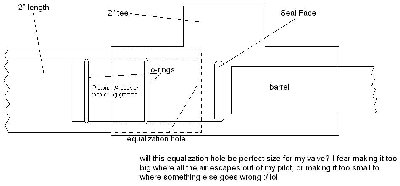

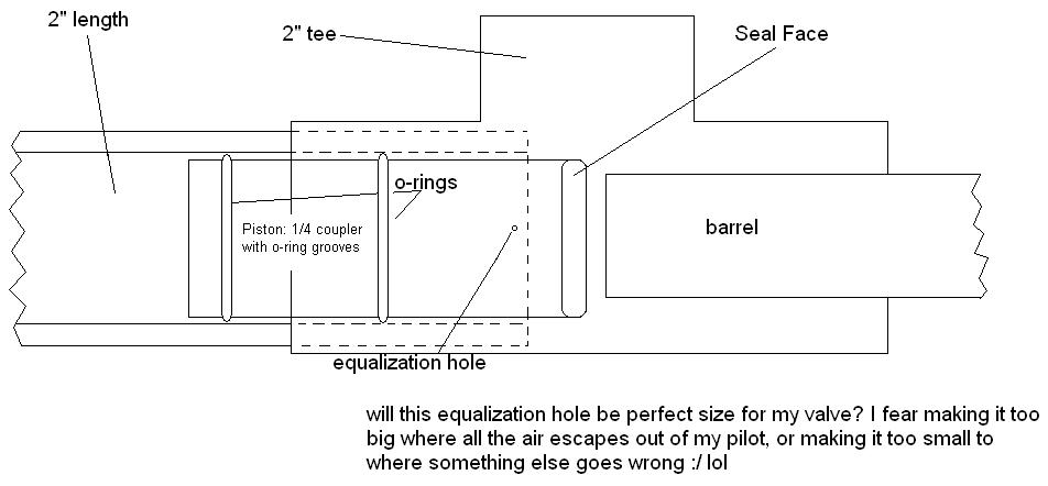

okay my last attempt at a barrel sealer was unsucessful but i am trying again. this time i will use .5in for the chamber and a bb barrel. before i start i have some basic questions. does the piston have to be an air tight seal or do i want some room around it? next can .5in pvc hold 300 psi ( 600 written on pipe )? This may be a stupid question but can i fill it with a shock pump or do i havve to use high flow source? thanks.
Your piston needs to be tight enough to be moved forward when you pressurize the pilot area. You can make it airtight but it will need an equalization hole to allow the chamber area to pressurize.

The piston needs to be a very good seal for the gun to pilot properly. If you are using O-rings, then as Dornep mention, you will need to add an equalisation hole, or have a check valve around the piston to allow air to reach the chamber.

Shock Pumps can seal home-made pistons effectively, as long as the piston is well lubricated, as their flow is relativly low. A spring could help with this, depending on the volume of your chamber.

For a BB barrel, the piston only has to move back 1/16 inch so your pilot volume can be tiny enough to be piloted by the schrader you're using for filling.
If your equalisation hole is too big, your launcher won't fire. It can't really be too small, if you're filling with a bike pump you can afford a pinhole sized hole and not realise the difference. If using a compressor, open your filling valve for several seconds to make sure your chamber is under pressure. In regard of the above, I would lean towards the smal - 0.5mm or so should suffice.gwoloshyn wrote:Is this equalization hole good size?

I would have my equilization hole coming out the top of the piston just outside the barrel diameter. The barrel seal acts as a check valve. I use a 1/32nds hole in my piston.
