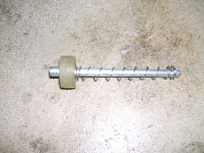

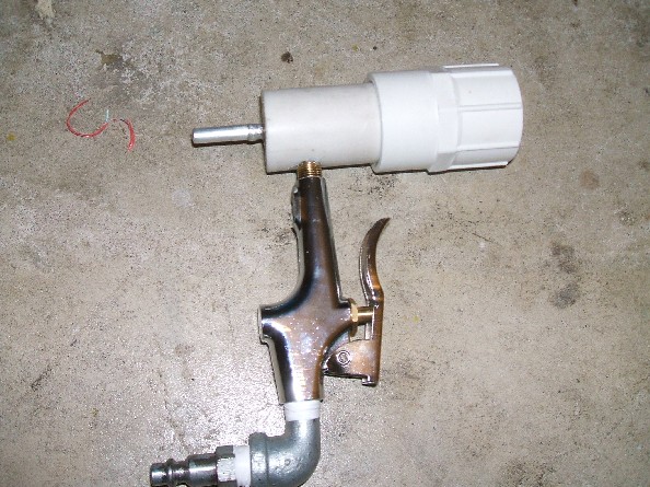

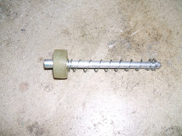

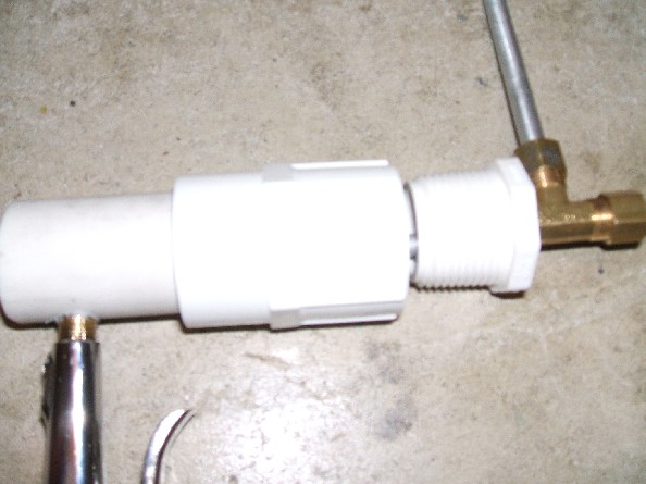

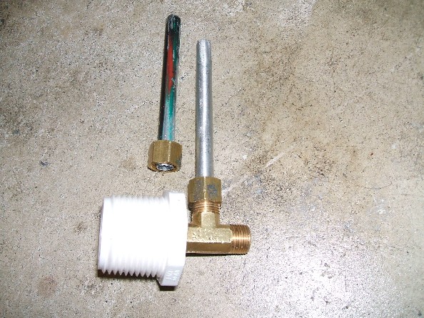

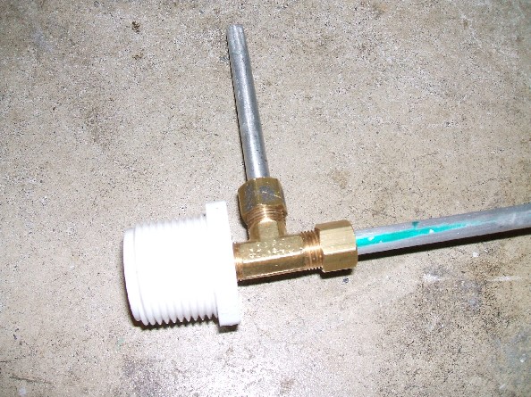

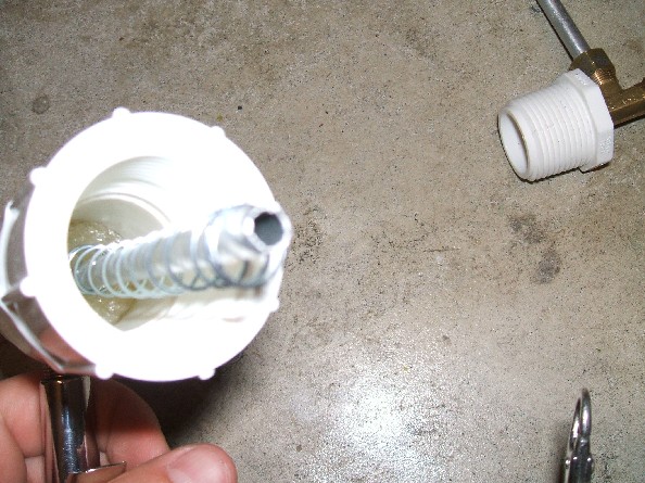

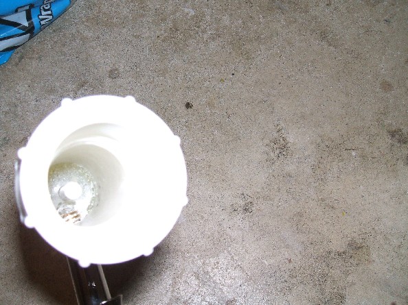

This is my second 6mm semi auto, but this one actually works. It was very surprising to me, because I can never get anything aligned perfectly. I haven't shot with the barrel yet, but hooked up to unregulated propane, it can dump a 20 round mag in less than 5 seconds and shoot the BBs about 10-15 feet. This gun would be extremely simple if not for the blow forward bolt. A single shot version of this would be a piece of brakeline, a blowgun, an elbow, and a quick connect.
Instead, it uses (going from gas tank to barrel)
Propane tank
Propane Adapter
Female QC
Male QC
1/4" street elbow
Blowgun
1/8" close nipple
3" section of 1" Sch 40 PVC
1/4" aluminum rod
Solid Epoxy as a plug in the back of the PVC
Solid Epoxy bolt, with 5/16" and 1/4" brakeline
Spring
1" female adapter
1" plug
5/16" compression T
A couple mags made from a compression olive, nut, and 5/16" tubing
5/16" brakeline sleeved over 9/32" brakeline
I may add a stock to the gun, which is why I have part of the aluminum rod sticking out the back. I may also add a small BB shotgun underneath the barrel, as well as a rifle scope on top. I will almost definitely paint the gun (flat black).
It's not as cool as Jack's clear syringe for a blow forward tube, but a plastic syringe costs me almost $5.

looks great. I would have used a longer barrel because of the slow opening blowgun. does the bolt ever jam inside that tee?

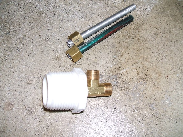

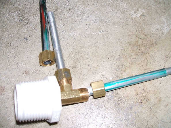

I forgot to mention the little hopup/ball stop. It's a tiny sliver (literally) of a rubber gasket which protrudes from the top of the T.noname wrote:I haven't shot with the barrel yet

The barrel is 30" long. I guess I forgot to take pictures of how long it actually is.mopherman wrote:looks great. I would have used a longer barrel because of the slow opening blowgun. does the bolt ever jam inside that tee?
The bolt has never jammed, but it occasionally knocks the 1/4" aluminum rod back. This is also why I'm not shooting it right now; I'm waiting for the epoxy on the rod to dry so it stays in place.

Adding a new hopup, the bolt spit the old one out.
Attached a new brass barrel that isn't bent like the previous aluminum one.
