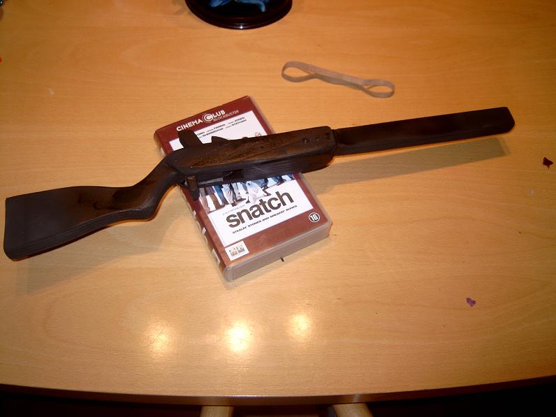

meet the incredible...RUBBER BAND POWERED SHOTGUN!!!
Ain't she a beauty??<br />&amp;quot;my most powerfull gun to date&amp;quot;<br />Not quite this time...still a fun project.My son loves it!!( although he asked me if I could make him an AK47 aswell.&amp;quot;dad I want the soldier rifle too!!&amp;quot;)<br />Paint still drying in the pic BTW.<br />Ofcourse it's flat black
&quot;my most powerfull gun to date&quot;
Not quite this time...still a fun project.My son loves it!!( although he asked me if I could make him an AK47 aswell.&quot;dad I want the soldier rifle too!!&quot;)

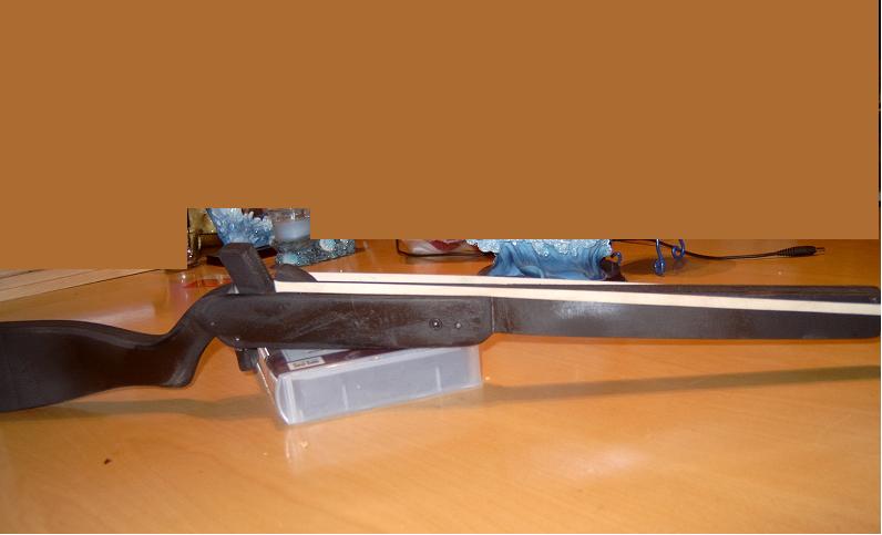

LOCK AND LOAD!!!<br />All charged up..are you getting ready to duck yet??
LOCK AND LOAD!!!

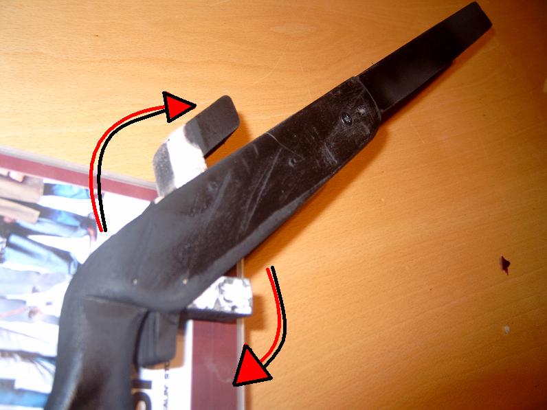

and this is what happens when shot.<br />The action is very smooth and does not cause any wear on the rubber bands.

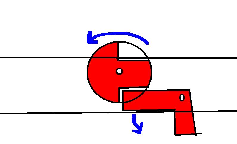

Pretty cool trigger mech. Can you go into a little more detail into how the trigger works?

this is the basic idea...a roller and a stop.It can take huge amounts of force and still have a smooth triggerpull..<br />when the trigger is pulled, the block can rotate freely.No snagging or wearing on the rubber band ( or bowstring) I just added a &amp;quot;hammer&amp;quot;on the top side of the roller for looks.
when the trigger is pulled, the block can rotate freely.No snagging or wearing on the rubber band ( or bowstring) I just added a &quot;hammer&quot;on the top side of the roller for looks.

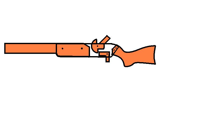

This is the plan.<br />Use 1/2&amp;quot;plywood for the center pieces ( sand the action so it is slightly thinner)<br />Use 1/4 inch plywood for the sides.<br />You can now replicate you favorite guns and shoot your friends with it!<br />Use eyeprotection!!
This is the plan.
Use 1/2&quot;plywood for the center pieces ( sand the action so it is slightly thinner)
Use eyeprotection!!
