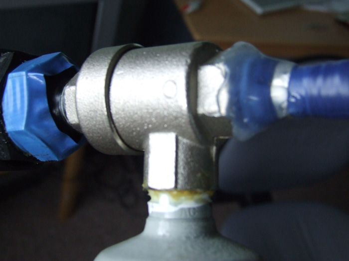

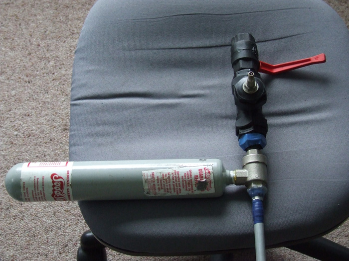

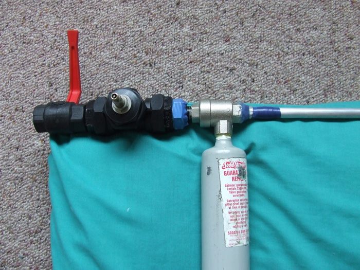

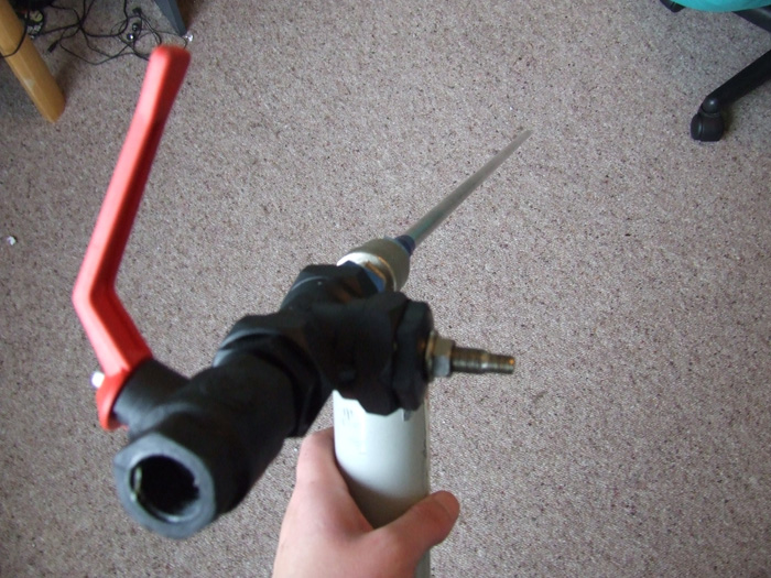

Now on to the gun. I didn't want to wait to next week to get fittings so I searched around for stuff that I could use at home. I had an old sodastream co2 canister so I used that as the main chamber, might be a bit small, buts its enough for now.
Luckily the thread was the right type and size so it connected nicely to the QEV. The opening in the cylinder isn't that big so I might drill it out at some stage to increase air flow.

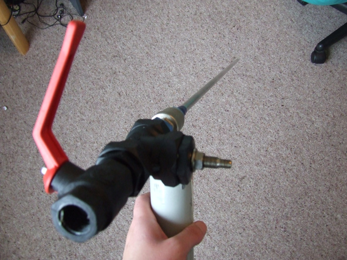

I cobbled together some "Hanson" fittings that were lying around and the bits of my last cannon to make the charging and exhausting system. I know its too big for this size gun but its all I had. I managed to crack the ball valve case while screwing it on, piece of plastic crap. But I just used the other end that was ok and it works fine lol.
I didn't have any fittings for the barrel. I wrapped electrical tape around the end of the aluminum pipe that was to be the barrel until it was the right size to be screwed into the QEV. It actually screwed in quite tight and straight. I secured it with hot glue. I haven't had any problems with it so far, it doesn't leak at all, but Im just waiting till the projectile jams and the whole barrel blows off lol, but it should be right.
Like I said I've had it up to 150psi with no problems, the valve works good as and it keeps its pressure. I've been shooting bits of wooden dowel out of it and it seems to have a bit of power. Need to find something better then that though, something that will fly straight and have a bit of weight.
Specs.
-Barrel length is 1meter and diameter is 10mm (internal).
-Chamber volume I estimate to be around 400ml.

Seen Extras?nz_cannons wrote:"are you having a laugh?"
Anyway, Nice gun. When you pull the ball valve trigger does the gun jerk up and around a bit?

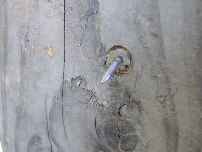

Damage pics or video would be sweet.

Um, nah it doesn't move around too much huh. The ball valve is not very stiff to move and that heavy cylinder helps to keep it stable.
Will try get some damage shots up later today.
