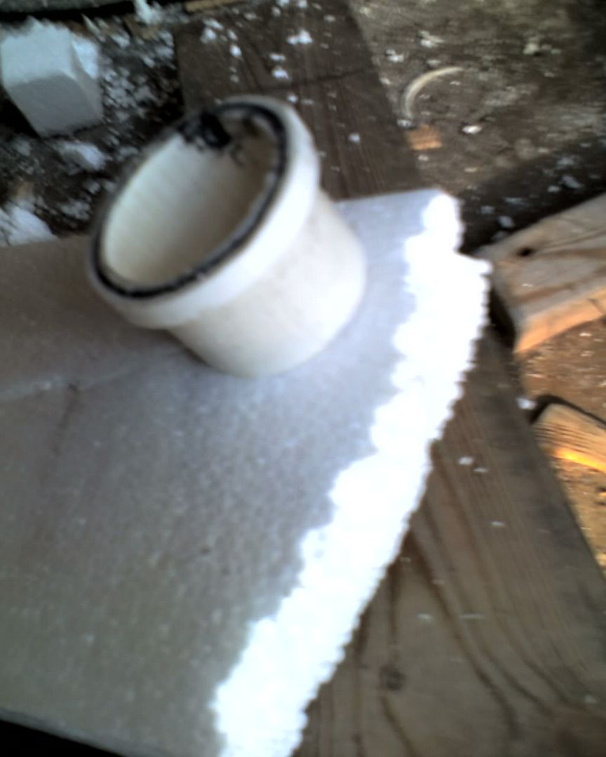

I was making sytrofoam wheels for my science project and i thought of using one of them for a sabot or wadding.
Heres some pics of how i made them...
Grab a piece of your barrel...

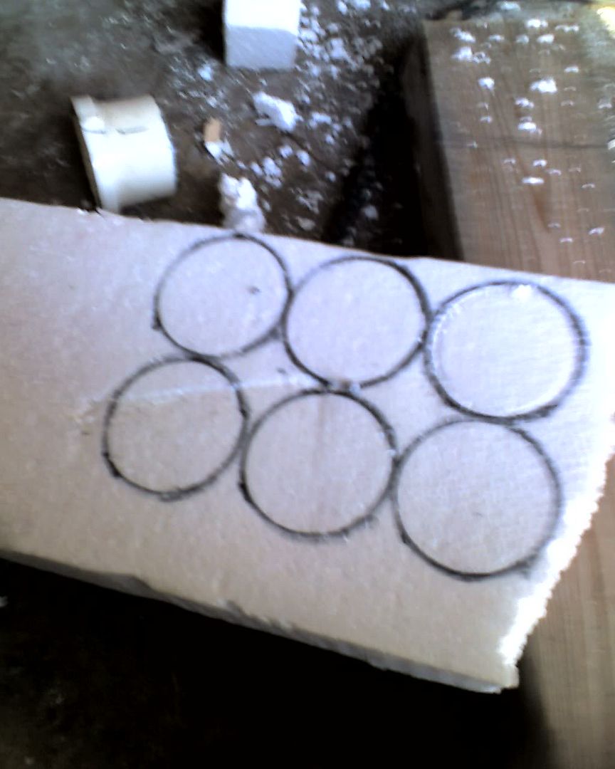

Trace with a marker...

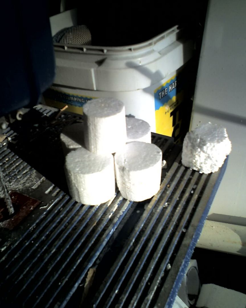

Cut with a bandsaw...

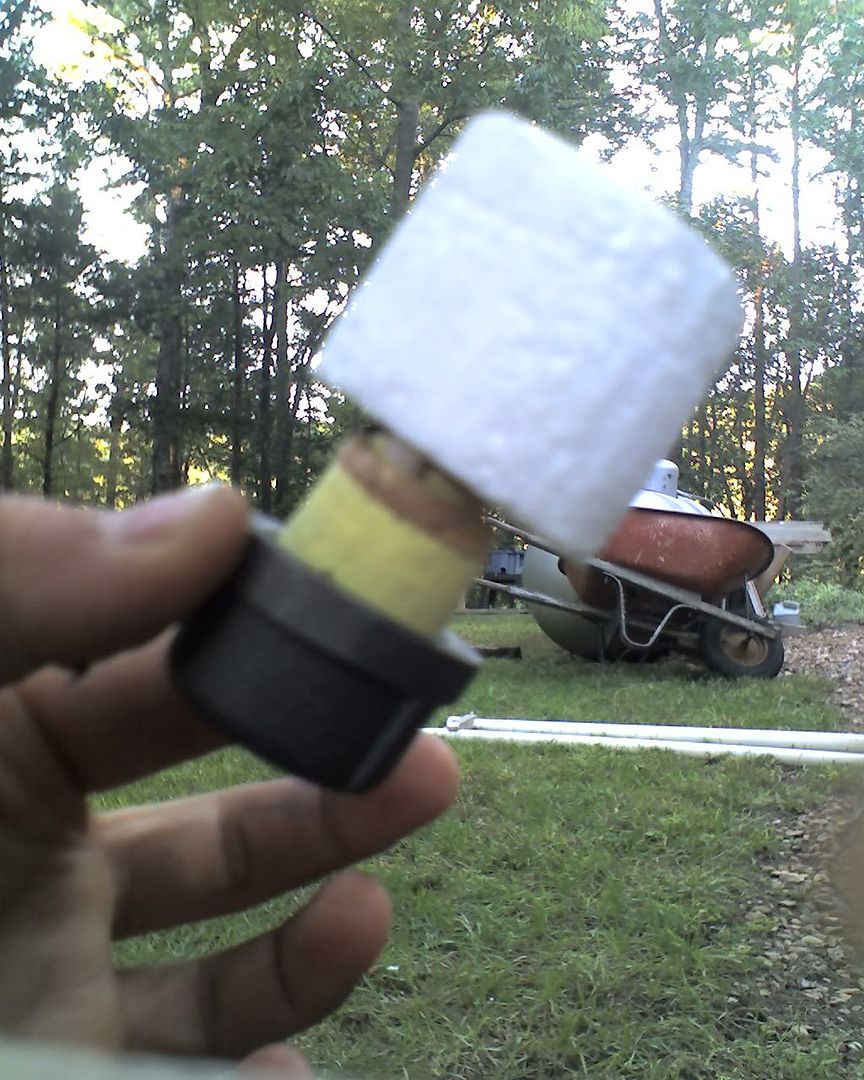

Glue items in or on the foam

rather than use a bandsaw for foam I prefer to take a piece of barrel material and sharpen the edge similar to a hole saw:

I, too, think that the bandsaw method is too time-consuming, leave that for tougher sabot materials like plywood. What Jack suggested is good, as is a short bit of barrel and a hammer in case things get tough(heavy blunt objects solve everything!!!).

With foam, sharp and fine is the key ;)

@ JSR, I tried that but it just ripped the foam unevenly, maybe finer teeth would work. Gotta love tanks!
I don't use teeth, I just get it down to a fine edge like a muzzle knife - though this usually works best for metal barrels.

It comes out as 3 pieces usually, only once I was able to reuse one.
Next time I go to wall-mart I'll pick up some of that hard foam windshrike was talking about. I'm sure I'd be able to reuse it at least once hopefully.
