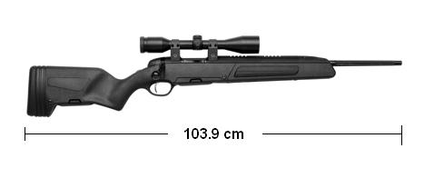

i wan to make a stock out of wood for my bb sniper in the style of an l96, styre scout tactical, or m40a3 but i can't find dimensions anywhere for any stock

i like my stock with a 14 1/2" length of pull, a 3/4" drop at heel and a 3/4" drop at comb. this would be more common for an assault rifle such as an FAL than a sniper.

Have you got a ruler and a calculator?
- steyr_scout.jpg (7.84 KiB) Viewed 3679 times

that was going to be my last resort loljackssmirkingrevenge wrote:Have you got a ruler and a calculator?
You can do it fairly easy with image editing software.
Crop the side view in such a way that the ends of the image are the muzzle and butt end of the rifle, resize the width of the image to the actual length of the rifle then print it out in its actual size. Tape the resulting sheets together and you have a full size template of the rifle.
Ruler and calculators are for the weakjackssmirkingrevenge wrote:Have you got a ruler and a calculator?
But seriously, go up to a mirror, hold an imaginary gun as you would want to hold the finished product. Then get a friend, or use your other hand with a ruler and roughly gauge the distances. Then if you feel the need, cut the stock out of some ply wood as a template, adjust it as you feel the need, then you have a template for the stock.

i went with the ruler and calculator method and made myself a nice cardboard template. also do you think a 1/4" qev would have good enough flow for a 6mm barrel? 1/4" is around 6mm isn't it so maybe i would have to have a 1/2" qev?
