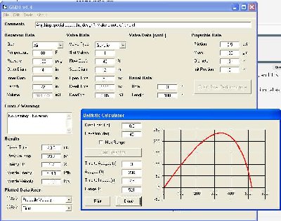

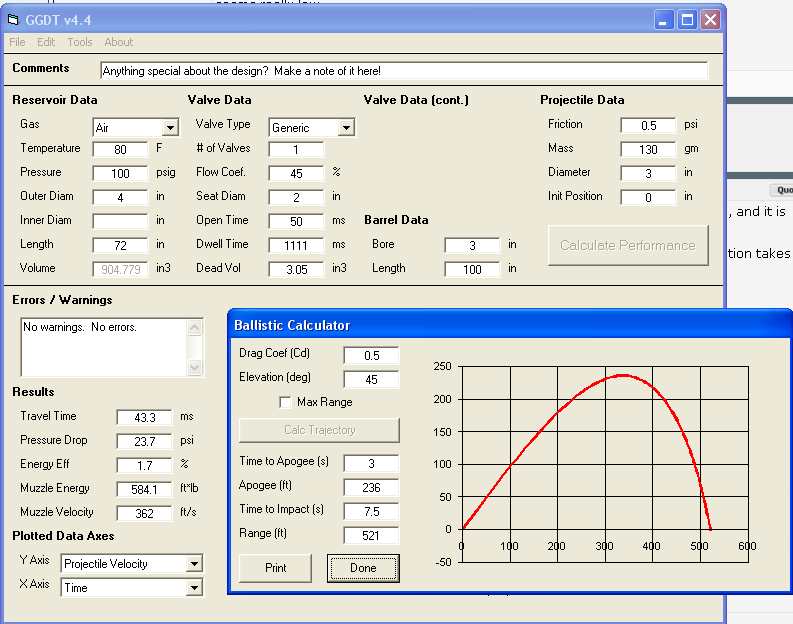

I have a a air cannon that i want to change a barrel from a 2" to 3" piece. I currently have a 7ft piece and would make the 3" 8-9ft long as well.
My chamber is a 4" diameter with a distance of 6 feet and using a 2" ball valve
i want to launch little pumpkins that weigh about 120-130 grams
At about 80 psi or 100 psi, what should i expect for a range, GGDT says only 380 feet, which seems really low

Well, that actually seems about right, since the valve you are using is a ball valve, and it is also quite a bit smaller than your barrel, but I could be wrong.

I never thought that going to a 3" barrel would reduce performance and distance in half

Well, the projectiles speed comes from air pressure. A larger diameter barrel will cause the air pressure to drop faster per unit of length down the barrel. This creates a slower projectile.bruno6491 wrote:okay thank you

It's not as simple as that, a larger diameter barrel also increases the base area of the projectile and since (force = pressure x area), your pressure (for the same valve) would be reduced but there would be more surface for the air to act on.Marco321 wrote:Well, the projectiles speed comes from air pressure. A larger diameter barrel will cause the air pressure to drop faster per unit of length down the barrel. This creates a slower projectile.
Ball valves are really the lower end of valves, you'll be amazed what a difference a fast opening valve will make. If you're not willing to go through the effort of making a piston valve, why not try and get your hands on a 2" or so sprinkler valve? Modding it is childs play and believe me, you *will* see the differenceThe piston valves look really complicated to make, so i might stay with a ball valve, since i already have everything cemented together, maybe for my next cannon
Would a piston valve really add that much more distance vs a ball valve?
I know.... I was making an edit to say that and how increasing chamber volume but keeping pressure the same would also increase speed, then my computer crashed for some reason........ and if forgot about it........jackssmirkingrevenge wrote:It's not as simple as that, a larger diameter barrel also increases the base area of the projectile and since (force = pressure x area), your pressure (for the same valve) would be reduced but there would be more surface for the air to act on.Marco321 wrote:Well, the projectiles speed comes from air pressure. A larger diameter barrel will cause the air pressure to drop faster per unit of length down the barrel. This creates a slower projectile.
I have been meaning to make a post about this for a long time so here it goes. Since the more area exposed to the air pressure means more force, but with increased surface area weight increases, making the projectile slower. But slower doesn't necessarily mean less energy, it will have the same kinetic energy (since kinetic energy is dependant on speed and mass ). Does that mean there is a theoretical optimum C:B and pressure for a projectile of a certain surface area and mass?

This is exactly why sabots are used - you're increasing the surface area, but at the same time keeping the weight low in comparison by using lightweight materials to support your sub-projectile.Since the more area exposed to the air pressure means more force, but with increased surface area weight increases, making the projectile slower.
As far as I'm concerned, for pneumatics the optimum is as much as you can afford. In practical terms, the more pressure then the more power you're going to get - same goes for chamber volume, though this tapers off to a point where the increase is barely noticeable.
thanks so much, i am learning why this is not as powerful and also the pumpkins are fairly light, like a 120 grams, so they should be capable of going about a 100 yards, a 2" sprinkler valve is quite expensive, so i am going to pass, but i will make a piston valve on my net building, probably after winter.
