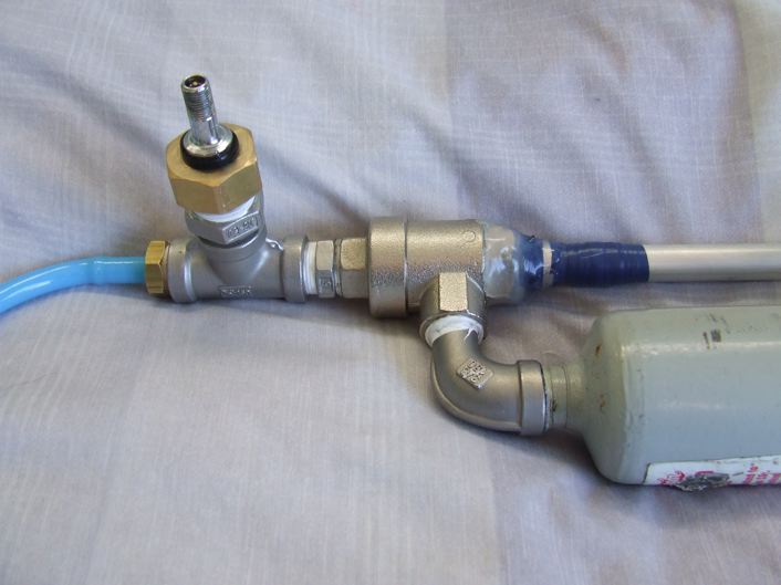

After building my first gun around my newly purchased QEV and whatever parts I had lying around I set out to construct something a little better.
My main focus was to reposition the main chamber and decrease the pilot volume, as well as relocating the exhaust valve.
I went to the store and purchased the components I needed, surprisingly the stainless steel fittings (very nice IMO) were about the same price as the brass, so I decided to use them.
I only used a brass end cap because it was easier to drill through, and I don't think there were stainless steel screw in barbs. The stainless steel, as well as not rusting, is also a lot harder, which means the threads will take a bit more abuse then the brass would.
I'm not sure exactly what type of tube I used, but it's high spec and can easily hold a lot of pressure, as well as looking pretty mean.
The schrader valve I got for free from a tyre/wheel place. I couldn't find a fitting that it screwed into so I just drilled a hole in the cap and used the nuts it came with to hold it in place, it seals ok, no obvious leaking.
The barrel is the same one as on my last one, rather thin walled aluminum tubing. The wall thickness is only 1mm which I think is a little too thin, I would like something a little heavier.
I had to use the same method of attaching the QEV to the barrel as last time because I couldn't think of a solution at the time, it's all good though. Its reasonably strong and doesn't leak.
The ball valve is really smooth to open and close although it still puts off my aim when firing the thing.
I usually take it up to around 170-180 psi using my air compressor. I think the only thing limiting it is where the tube is pushed on to the barbs.
Although they would probably hold to a lot higher pressure, the air compressor has a similar setup using that type of tube and barbs, so if the gun doesn't go then that will (or the crappy tyre filling device will, I go off the scale on it's built in pressure gauge).

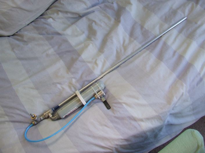

Specs:
-The barrel is 1m long with a 10mm internal diameter (0.4 inch)
-The chamber is the same as the last one, about 400ml I would guess.
-QEV is 3/8 inch variety
Pros
-The QEV works a lot better with a small pilot volume, it goes off with a bang and you feel the recoil.
-It's compact.
-Reasonably powerful for it's size I guess.
-Can take high pressures. (High for what I'm using)
-Triggers well, using a ball valve seems to work nicely.
Cons
-Difficult to aim without a stock to keep it steady.
-Moving the ball valve puts my aim off.
-No safety, can be accidently set off when removing the filling thing from the schrader.
-Has to be muzzle loaded.
I will eventually come up with something that rectifys these problems.

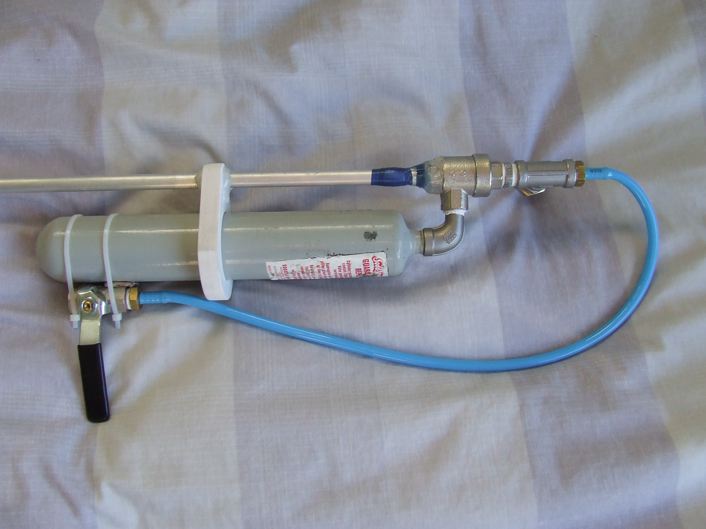

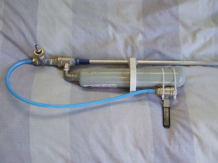

The filling system.
The filling system.

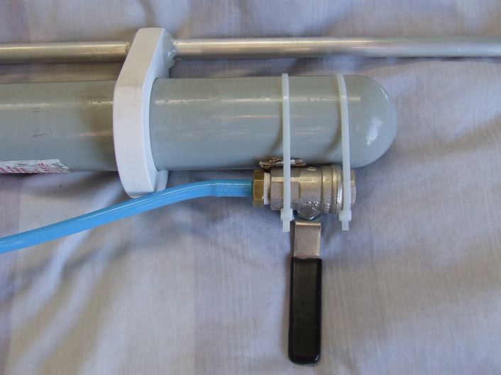

This is the only way I could think of at the moment for attaching the ball valve to the gun. It works ok and doesn't move around at all.

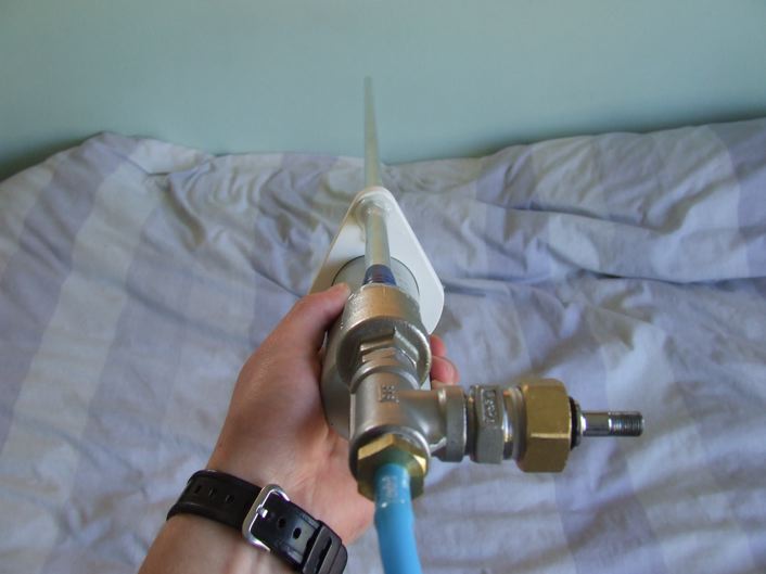

Shot along the barrel. Quite easy to hold I reckon.

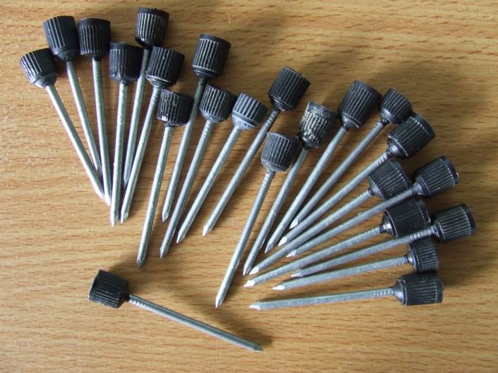

These are my standard ammunition. They are 50mm nails pushed through a tyre valve cap. <br /><br />The valve caps are a perfect fit for my 10mm barrel (although some need a wee trim).<br /><br />After the nail is pushed in I fill the caps with hot glue. <br />These work extremely well, they fly nice and straight and can easily be mass produced.<br />I'm working on how to make them even better but that will come another time.

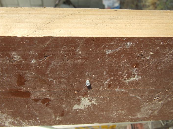

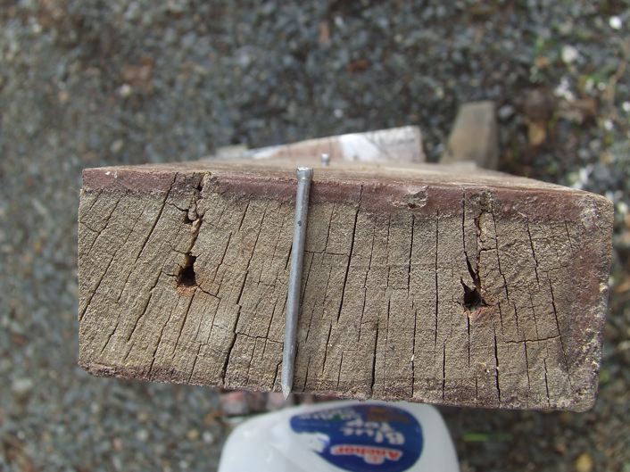

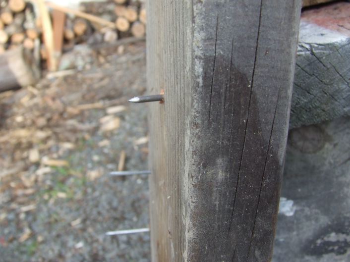

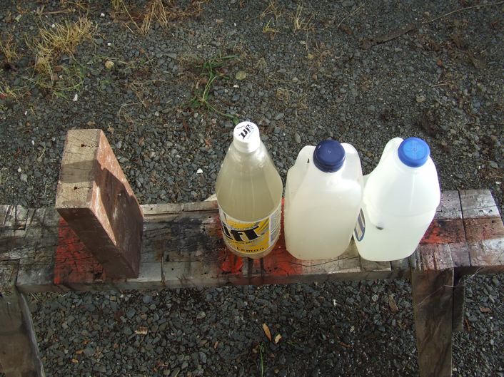

I shot a dart through the 3 bottles of water and it still embeded itself quite far into the wood. This was from about 4-5m. I also did one with 6 filled bottles with results about the same ( dart was sticking out about 15mm more).
Thickness of wood compared to length of nail in dart.
Close up of nail in wood after going through bottles.
This pic shows the darts that have gone right through a solid plank of wood, about 30mm thick, the small ones allmost come right out the other side.

How far away from the plank are u shooting?5meters or did you sneak up on it and fire at point blank
Novacastrian
Posts: 1603
jackssmirkingrevenge wrote:pilot...volume...too...big.... must resist...commenting... gah!
*ahem*
looking good :D
Glad someone else noticed, and was rude enough not to comment on it! :lol: :lol:
battlemonkey wrote:How far away from the plank are u shooting?5meters or did you sneak up on it and fire at point blank
He said 4-5m.
nz_cannons
Posts: 51
Joined: Tue Sep 04, 2007 10:17 pm
Cheers, um, yeah was about 4-5meters away, they still rip through it. The bottle is a CO2 gas cylinder from an old sodastream machine.
I don't get it, how could the pilot volume be too big? Seems about as small as I can get without just connecting the ballvalve straight to the tee. I wanted the tube so I could position the ballvalve where I liked.
battlemonkey
Posts: 137
Joined: Sat Sep 22, 2007 3:42 pm
i kinow what you mean, a cannon has to feel right when you fire it otherwise its really hard to aim
1) With JSR, the pilot volume is never too small
2) You could shorten the hose a bit, it has some slack in it.
Novacastrian
Posts: 1603
Or use smaller id hose with appropriate fittings.
