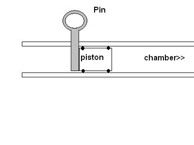

Here's an out-of-the-blue question; Do you think you could get o-rings on a piston to seal at 500 psi?

It's a simple valve idea that could you could try before you make custom flanges. Basically it's just a piston that is held in place with a pin, so when you pull the pin out, you are releasing the pressure and the piston will act as a sabot for whatever projectile you are using.
you mean like this?
A pin would allow lateral movement that would lock it in place and prevent it from sliding up without impractical force, that's why I chose a bolt.
