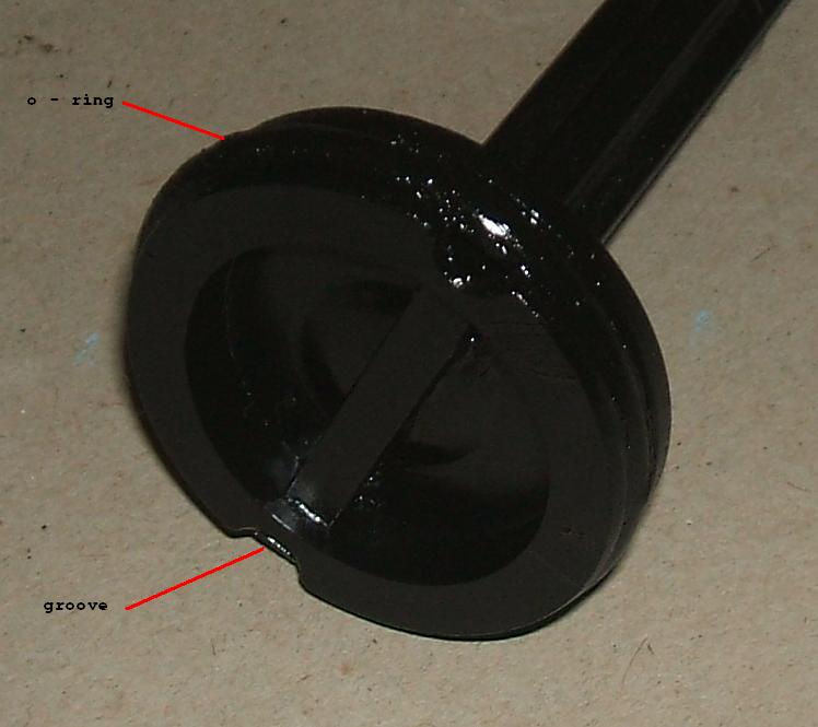

Novacastrian wrote:without the need for machining
This is I believe one of the shining virtues of epoxy casting, in that unlike a machined component, you need only basic hand tools to get a durable and precise result.
Your method sounds like it would work, however I would suggest a slight modification to the design that would reduce drag and remove the need for an equilisation hole.
It would basically function in the same way as the piston head in a bicycle or foot pump.
