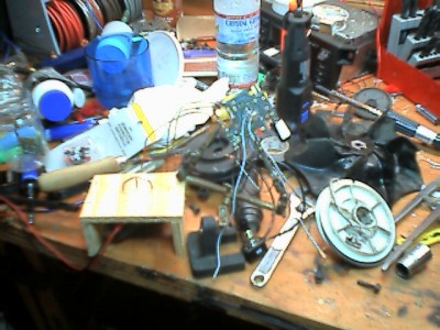

deathtodeer666
Posts: 126
Joined: Sat Sep 03, 2005 12:57 am
Location: mars alabama
here is a pic I took with the worst digital camera ever the red blur is the light I took out and out on wires the grey wires are the trigger and charging buttons,red is the ignition wires and black is to the led,I might put in a discharging switch and a battery on off switch.

Technician
Posts: 57
Joined: Wed Dec 14, 2005 8:03 am
Location: USA, Ohio
deathtodeer666 man I give you points for having a work-bench with such character. I really thought that mine was the only one that looked like that.
