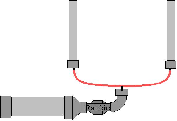

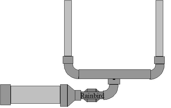

So my friend is DJing a party on New Years and I've been commisioned to build a confetti cannon for the event. What I want is a twin barrel system that fires one shot from each side of the dj booth, and both barrels are powered by a single large pressure chamber. A high confetti capacity and launch height would be nice as well, since we'll be in a hotel ballroom.
I'm thinking it's going two have two 4 inch barells and a 6 inch pressure chamber. I plan on using an unmodified rainbird valve so it can be fired with a button and I have one laying around.
Since not alot of pressure is needed to launch the confetti, my first thought was to hook the two barrels up to the chamber using pressure tubing. However, I'm worried that the tubing will be too restrictive.
Hooking the barrels up with PVC is not very practical, however. I have no idea where the barrels will be positioned or how far apart they'll be. The only way this would be practical would be if I mounted the cannon in the air on a big 2x4 stand.
So what are your thoughts on the design?
Will pressure tubing provide a sufficient volume of air to launch the confetti?
Oh, and I also planned on using a large bike pump to pressurize the chamber, as it only needs to be done once and i dont want to lug around a compressor. How hard will it be to pump up, lets say, a 3 ft long chamber made out of 6" PVC to a sufficient pressure?
Thanks for your time, looking forward to hearing from some more expierianced cannon builders.
PS, I've attatched rough pictures of my two proposed designs
With piping
With piping
confetti cannon 2.jpg (12.62 KiB) Viewed 6948 times
With tubing
With tubing
confetti cannon 1.jpg (12.87 KiB) Viewed 6948 times

The tubing would be very restrictive and probably launch confetti about 2 feet. I would go with your first design. For your pump I would say you could do it, just make sure everything is airtight.

I don't think the tubing will give the desired results. You could always purchase another valve then place the chamber in between the two barrels, and having both valves on the same circuit to trigger simultaneously.

c19o - That's kinda what I figured would happen, especially if I go with two 4" barrels :lol:
Novacastrian - Well first of all, they'll be next to the DJ booth, which will be sectioned off with caution tape. I'll also wait untill about 10 minutes to midnight to pump it up, and leave the wire leads disconnected until ready to fire.
hubb017 - I'm not too worried about the orientation of the valves and the piping. With two valves, I would be worried that an inconsistency in the opening would cause one of the shots to be a dud. Also, If I had two valves I'd just forget all this routing garbage and hook a chamber up to each barrel... Now that I think about it... Thats starting to seem like a much more atractive option. I'm going for parts on tuesday so I'll check to see what i can get a rainbird for.
I forgot to mention that economy is a big thing here, since my freind isn't paying for it and this isn't going to recieve much use. I'd love to hook up some piston valves and just run the tubing to an exhaust, but that's too time consuming and is probably overkill for some confetti.

Looks to me like you have DWV fittings on that drawing. You gotta change that.

I agree, stay away from the tubing. Even one inch fuel line is going to be very constricting for a four inch barrel.
Rainbirds or any valve aren't going to cost a lot. And they are handy to have around anyway. I would get a second valve and build two identical launchers. Then they could be fired simultaneously or at different times.
