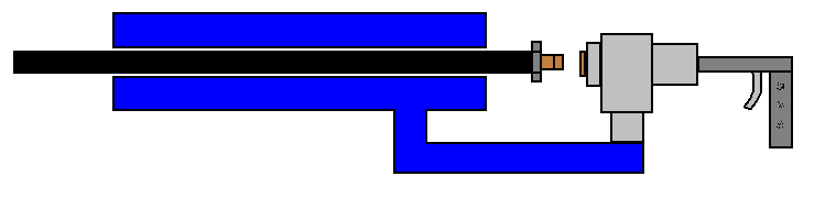

Give me a minute... I'll draw up a diagram of my new Fish Killer plan. Ever heard of a Klein Bottle?
Edit: Ok here is a horrible diagram of my new gun which I'm going to build as soon as the parts get here....
Basically it consists of a coaxial chamber. Outside pipe is 1.5", inside pipe is 1/2" sch80. There are reducing bushings at either end connecting the two. It's completely closed off except for a reducing tee which is part of the 1.5" chamber. From that tee is a 3/4 line which connects to a 3/4" QEV. The outlet of the QEV borrows the same quick-connect breech as my FK1. So the blowgun barrel slides through the 1/2" inner pipe to meet the QEV.
Hard to explain... but basically what I'm doing is eliminating the over/under and having the barrel slide right through the chamber.

thats a great idea. im using full metal for mine though. i think its against fourm rules to say what im planning. lets just say i was bet that i couldnt make something as powerful and accurate as a .22...... i want to own that bet in the face, and with style.........
and as for the barrel inside chamber thig, i was thinking aboug this quite a bit once, exept it was a coax with a cross in the middle of it........
and as for that link, ive been looking for that. its the breech loaded coaxial!!!!!!!!!!!! its how Sgort made his shoulder fired coax......
