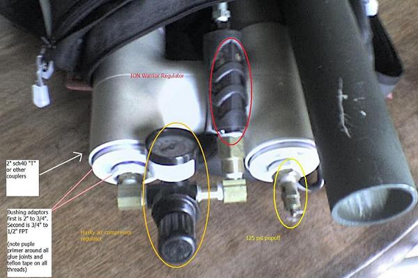

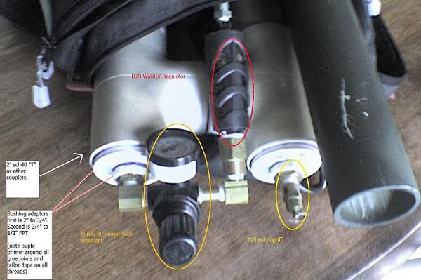

to use it on a field you will have to be able to chrono it at 230fps or lower, and you must show that it will shoot consistently at that velocity. what you will need to be field legal is a reg , this will control the psi and maintain a consistent velocity, most fields also like to see a safety popoff valve used especialy when using pvc , a popoff valve will prevent the pressure chamber from biulding up to much pressure and exploding. everything you will need you can find at home depo , reg, pipe, fittings, latex tubing , all can be found at home depo . this pic is only one of many ways to atach everything , maybe it will help you out.
