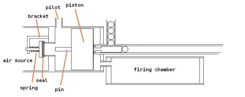

Piston/Hammer Valve combo
Kinda sorta like this?

Assuming the yellow thing is some sort of check valve (referring to JSR's diagram), it looks like it will work, but how much air will be released through the secondary valve? Will it be enough for consistent shots?
The yellow thing is meant to be a schrader valve.
Technically, a schrader valve is some sort of check valve, correct?
Not chamber sealing though. Rather a barrel sealer in a T with the chamber under the barrel. A brass T would connect the two chambers and have a pump attachment and blowgun or other exhaust mounted under it.
In your diagram, is it just a schrader connecting the pilot to the second tank? The drawback to that is that I doubt the piston will reset fast enough to conserve air. The piston will likely smash the schrader too hard and striking the pin would take some precise work. Even then, how much air is going to come through that tiny opening? It will be like a mouse fart in a hurricane.
I was thinking a much larger valve to be struck open. Something like hard rubber ball faucet sealer with a spring behind it. Something that could take a whack and allow a good blast of air around it for instant piston reset.
Good thoughts though. I'll take a better look at your post and the opinions on it..
I just used the schrader to illustrate the concept.
Are we saying that it's air from the secondary chamber that refills the pilot and main chamber of the piston valve area?
Exactly. Every other idea seems to involve somehow trying to temporarily close off the inlet that fills the pilot until it is exhausted. Why not eliminate that problem and have it so that it triggers normally and then basically an internal shot of air resets the piston rather violently. Surely a piston moves back with sufficient force to unseat a rather large valve, even if there is a lot of pressure holding it shut?

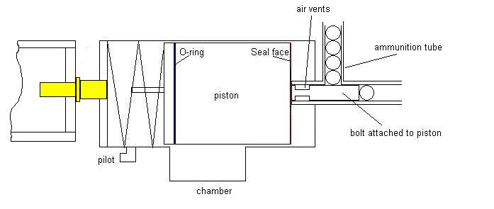

so basically...
- auto_pistonvalve_747.jpg (25.88 KiB) Viewed 6582 times
Yes, that's pretty close. The materials I have to work with(copper and brass fittings) would have the secondary chamber looking more or less like a soda bottle with a rubber ball inside it and a spring behind it. The piston/rod would hit the ball.
If it was filled from the pilot area I think you can see how it would fill the front and back chambers through the same source. Then the two chambers would be balanced and hopefully the two "shots" will tend to keep them fairly equal. Eventually an imbalance will prevent the piston from being able to open the rear valve. That may be prevented by experimenting with piston and rear valve dimensions.
What do you think?It sure looks feasible.
looks like it would work, I would add a pipe from the air source to the firing chamber though.

Yeah, good work Hawkeye. I like your solution of only opening the refill valve at a certain time, rather than trying to get it to close at a certain time. THat's ingenious. I had thought of incorporating a large valve in the piston so that when it moved reward, it would open and allow air from the chamber to fill the pilot, and then a spring would return the piston. I suppose you might cross those designs and connect the two reservoirs together to make one, I don't know if that would be good or not.
I can't figure out how the system will respond to pressure drop. Like you said, making it work would probably involve a lot of fiddling. The secondary chamber size is another variable, as is the pilot valve flow. I guess someone will just have to build it. I might be your man, if I had more money to drop on copper+brass. Maybe I will anyway, I'm kinda bored.
