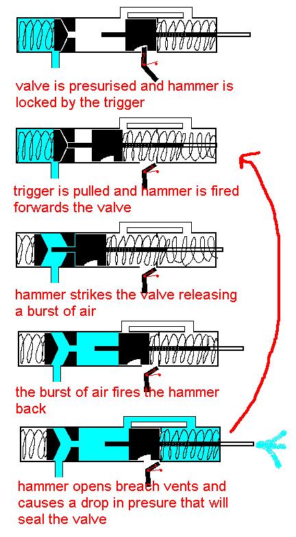

heres yet another of my bbmg designs i havent pur the breach on the design or much of an explaination becuase its pretty streight forward.
i think im gunna make an electrophumatic one next
a new design
Yes I love the out-of-the-box thinking! I have a problem with using the such a small hammer (make it bigger to prevent from bending). A little fragile of a design if you will, but ya it looks good. If only I had a lathe! Looks good Jalord.
cheers pimpman, its been rattlein around in my head for a while now so thought id post it. i dont usualy post my designs untill im completly convinced by them but i thought id post this and let people point out problems whilst there more obvious (they tend to be harder to spot when it nears completion), 4000 heads are better than 1

That is a really nice design. What would the bb feeder be like? Would it be a hopper like a paintball gun? I really want to try to make this but do not have the tools to work the metal. Again great design.
cheers urban ninja, the feeder could be a hopper or a mag, the rod that moves back and forth on the right would be inside the barrel and simply opens and closes the hole to the hoper

Ive been thinking about your design and was just wandering would you have an air chamber that you precharge so it is portable, or would you have a tank with a regulator
? It would be good if you had it with a precharged chamber, like a paintball one. That way you would not have to carry the tank if you wanted to move whilst shooting.
