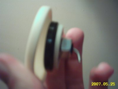

What exactly did it mean by bending the guide rod?P: Your sprinkler valve has a guide rod and you don't know where to mod it from.
A: You can usually put the brass fitting into the valve next to the guide rod. A few members have modified the valve where the guide rod is, and have bent the guide rod so the diaphragm doesn't fly off.

I have used valves with guide rods and never bent them. If you don't have to, don't.
As far as its meaning, I would think its talking about bending it in the form of an "L" to keep the 'phragm in place when it moves.
You dont have to bend anything. just drill and tap in a place that doesnt interfere with the guide rod. Good luck

I'm not completely sure I can tap it somewhere that doesn't interfere with the guide rod though.
The valve is kind of small.
Got a picture of the valve? We can help you find a place

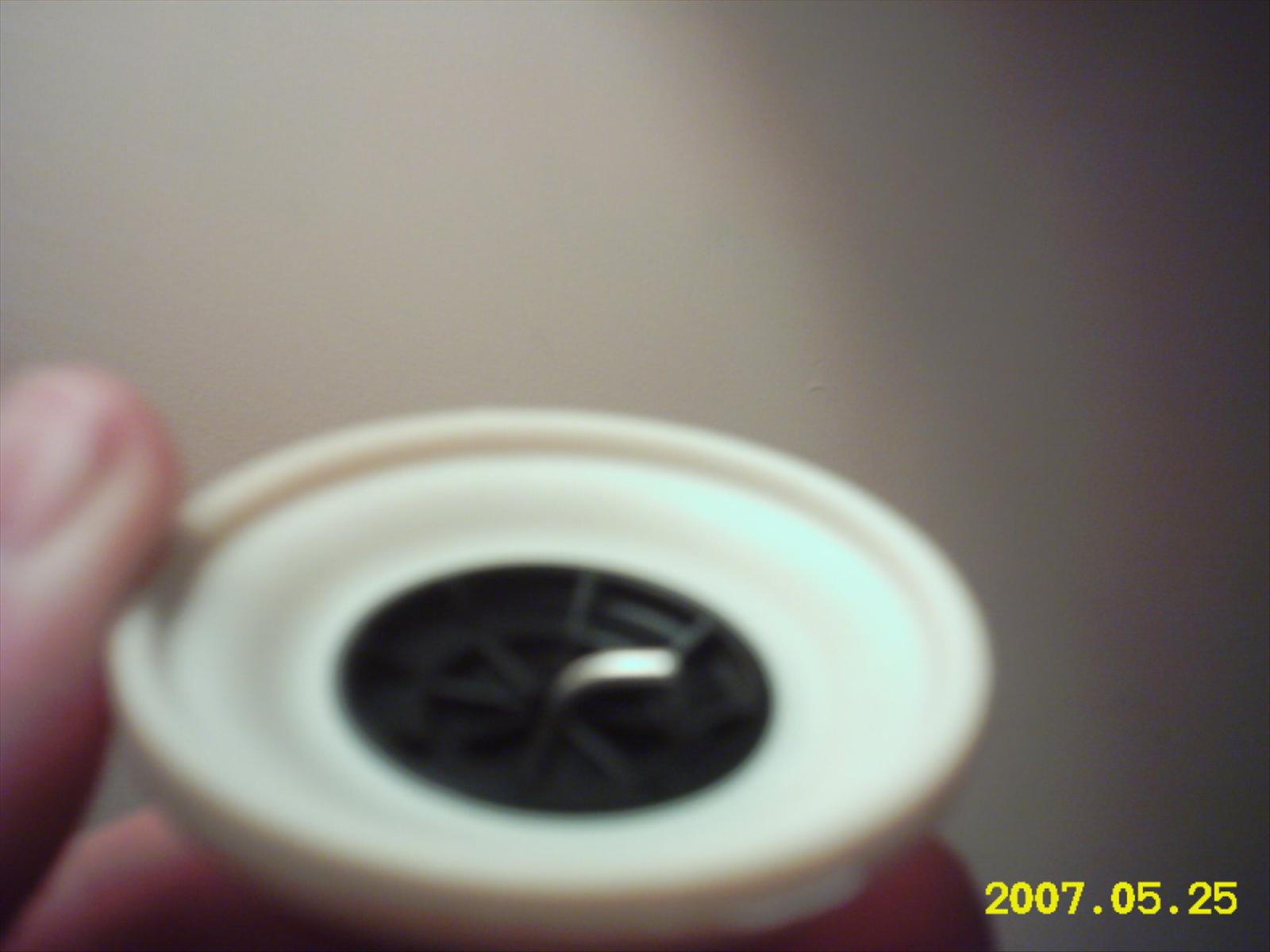

Theres a picture of the valve.
Edit: Could I fill up one of the holes where the solenoid used to be widen the other one, and just put the hose barb there?

My valve is slightly different, but im sure you can do the same to your valve as I did to mine....
1. bend guide rod so it looks like an L.
2. insert guide rod into phragm.
3. bend other side like you did to the previous side.
4. tap hole in the center of the valve for you hose barb...
