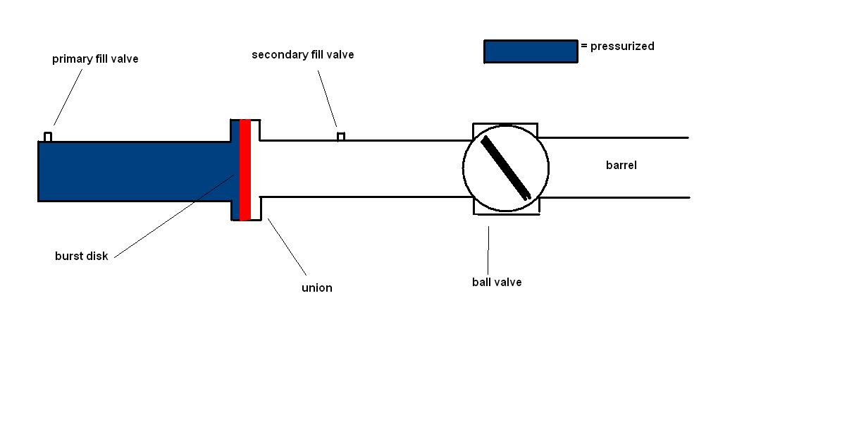

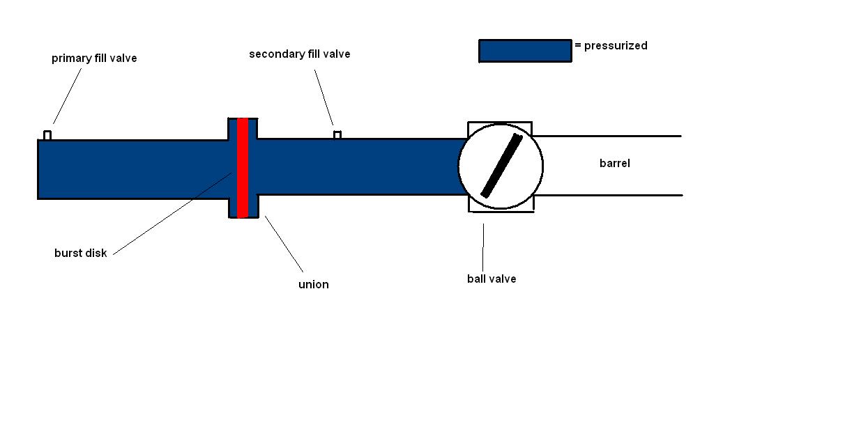

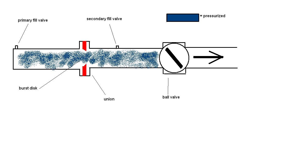

i just had an idea
what if you did what cicada was sayin and put the burst disk in front of the ball valve but as you're pressurizing the space behind the burst disk pressurize the space in front of but behind the ball valve, then you could take the burst disk to higher pressures before it broke, then to actuate it you just open the ball, the pressure behind the ball holding back the pressure behind the disk leaves, so the disk has to burst but it's at a much higher pressure, and your projectile goes alot faster. yes? no? maybe?
- first stage
- 1.JPG (32.04 KiB) Viewed 2305 times
- second stage
- 2.JPG (32.34 KiB) Viewed 2305 times
why not just put a burst disk in between the ball valve and your ammo that way you can get the ball valve open a lot further before the disk bursts and the cannon shoots. might give you maybe another 10th of a second to get that ball valve open all the way before the burst disk goes. just a thought

Eddbot, have you seen this?Eddbot wrote:i just had an ideawhat if you did what cicada was sayin and put the burst disk in front of the ball valve but as you're pressurizing the space behind the burst disk pressurize the space in front of but behind the ball valve, then you could take the burst disk to higher pressures before it broke, then to actuate it you just open the ball, the pressure behind the ball holding back the pressure behind the disk leaves, so the disk has to burst but it's at a much higher pressure, and your projectile goes alot faster. yes? no? maybe?
