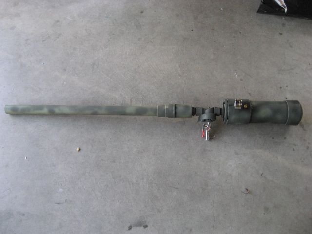

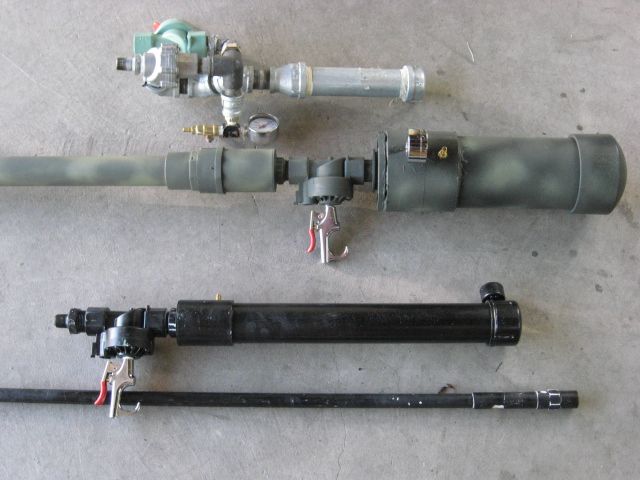

This is my last gun I bought parts for in America, it completes my American Spudgun stock pile :P
All three guns I've made with American parts are relatvily simple and basic, that's what I was going for again because I feel like having some reliable, multi-purpose guns I can bunt around with without worrying too much about them.
This one is similar to the <A HREF="http://www.spudfiles.com/forums/viewtop ... 90">SGI</a> in terms of design.
It borrows my <A HREF="http://www.spudfiles.com/forums/viewtop ... 16">SGA</a> golfball barrel for the time being.
I also had three almost empty cans of spray paint, hence the quick camo job where I just layered all the colours on over about 15minutes.

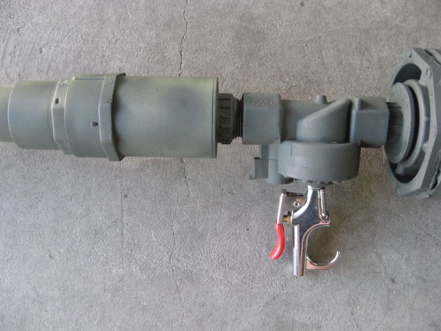

Specs:
Barrel: 40mm PVC PN18 Golfball Barrel/15mm PVC PN18 Paintball Barrel

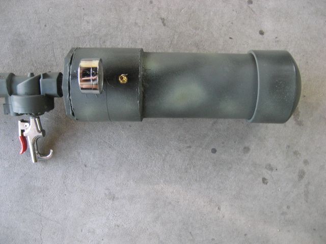

Chamber: 100mm PVC PN18 Chamber.

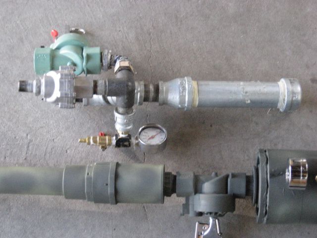

Valve: 25mm/1" Blowgun Modded Sprinkler Valve
Guage: 0-260PSI
Fill Valve: Schrader
Operating Pressures: 60-115psi

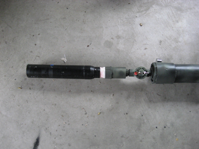

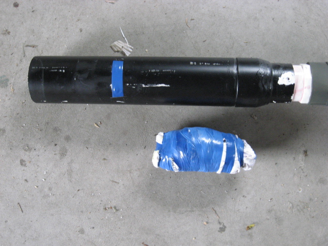

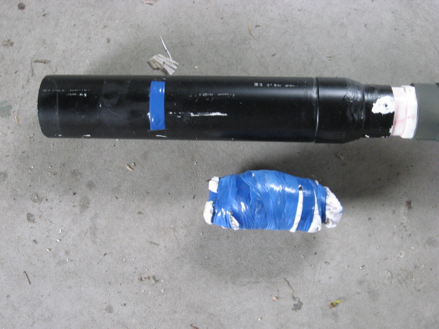

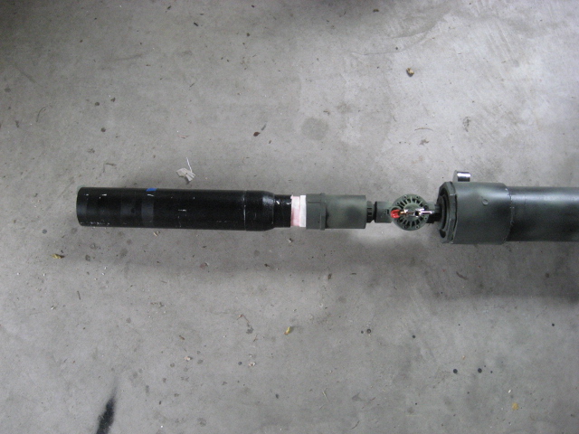

T-Shirt Barrel, was originally my 80mm DWV chamber from my very first combustion, which I decided did better as a T-Shirt barrel, so I cut it up and glued on a spare 2" threaded adapter.
I tape up old T-Shirts so they don't come apart when fired and they seem to go around about 60m at 70psi and have quite a bit of kick.
Maybe a video tomorrow :D

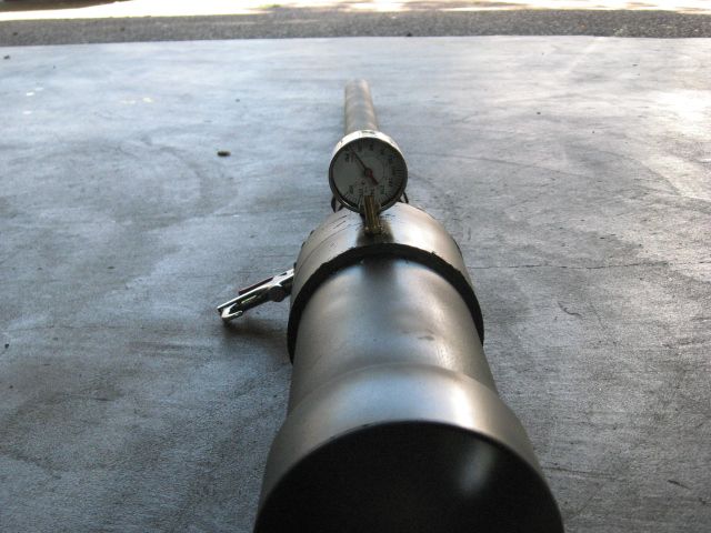

Over View
Over View
Over View.JPG (39.86 KiB) Viewed 6662 times
Down Sight
Down Sight
Chamber
Chamber
Sprinkler Valve
Sprinkler Valve

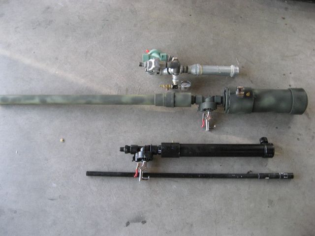

American Spudgun Stockpile
All Three American Spudguns
T-Shirt and Barrel
T-Shirt and Barrel
T-Shirt Barrel
T-Shirt Barrel

That gun looks hawt:O man, did u use krylonic fusion for ur camo?
