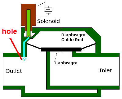

um i have a question about a sprinkler valve ok so, i have an orbit water master if u look inside were u attach the barrel (threaded part) you see a small hole there and when u put your finger over u can feel pressure coming out , thats only when your chamber is pressurerized. Can anyone explane to me what it is?

Doesn't a sprinkler valve exhaust through the barrel portion when the solenoid is used? According to the SGTC, it does.

That's the hole that the volume above the diaphragm exhausts through when the solenoid is triggered.
It should have been plugged with epoxy along with the rest of the area that the solenoid fit into.

PVC Arsenal's pic should show you were the air is coming from. Either re-attach your solenoid or plug the main solenoid hole with epoxy. Your problem should be fixed.
