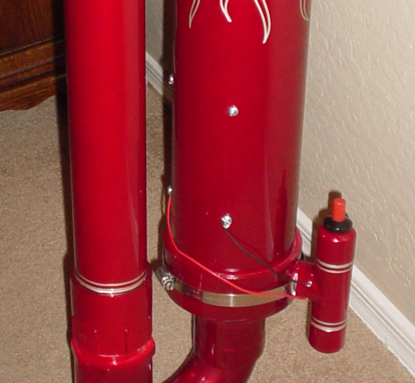

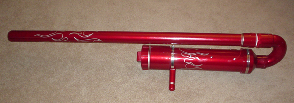

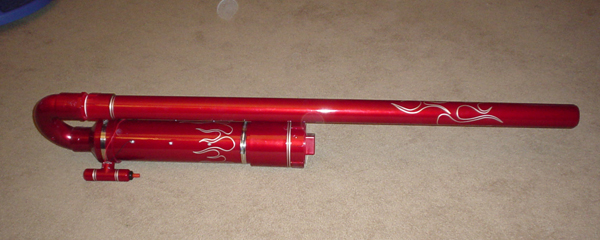

This is my most recently completed cannon. It's actually a Christmas Gift for my step brother back east. My Step mother asked me to build it for him and put a nice paint job on it. Hope ya'll dig it. This has become a pretty standard cannon for me, I've built a bunch of them, themed them in different paint jobs and either given them as gifts or sold them. Some of you may remember my Harley Davidson cannon. This was a gift to my uncle in Kansas.
http://www.spudfiles.com/forums/viewtop ... html#48198
Anyway, the cannon a 1.5:1 animal, 4"x18" chamber with a 2"x48" barrel with a barrel knife, dual spark BBQ igniter, internally wired, forward handle, and a threaded union. Very reliable and very powerful. This one is spray and pray with Static Guard because this is the recipient's first cannon.
Hope ya'll can dig it.

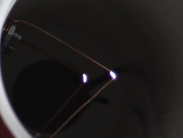

Well its fixed now. But i do like your ignition also. Copper wire is a good idea. Man i gotta try that sometime.

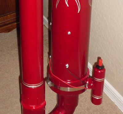

Now for the proverbial "stick in the mud. Just one little thing that i would "modify" if i may say so is to cover those exposed ignition wires, it seems as though they could be accidently ripped off easily.
That however is a drop in the ocean compared to the rest of the construction.
Very nice indeed
Very nice indeed
The ignition wires would at worst get pulled off the screws on the outside of the chamber. No biggie, just put them back on. Behind the holes in the T coupling the wires are knotted, they're not getting pulled out of the igniter assembly. Glad you guys like it. I always hate letting them go. I love every cannon I build.
