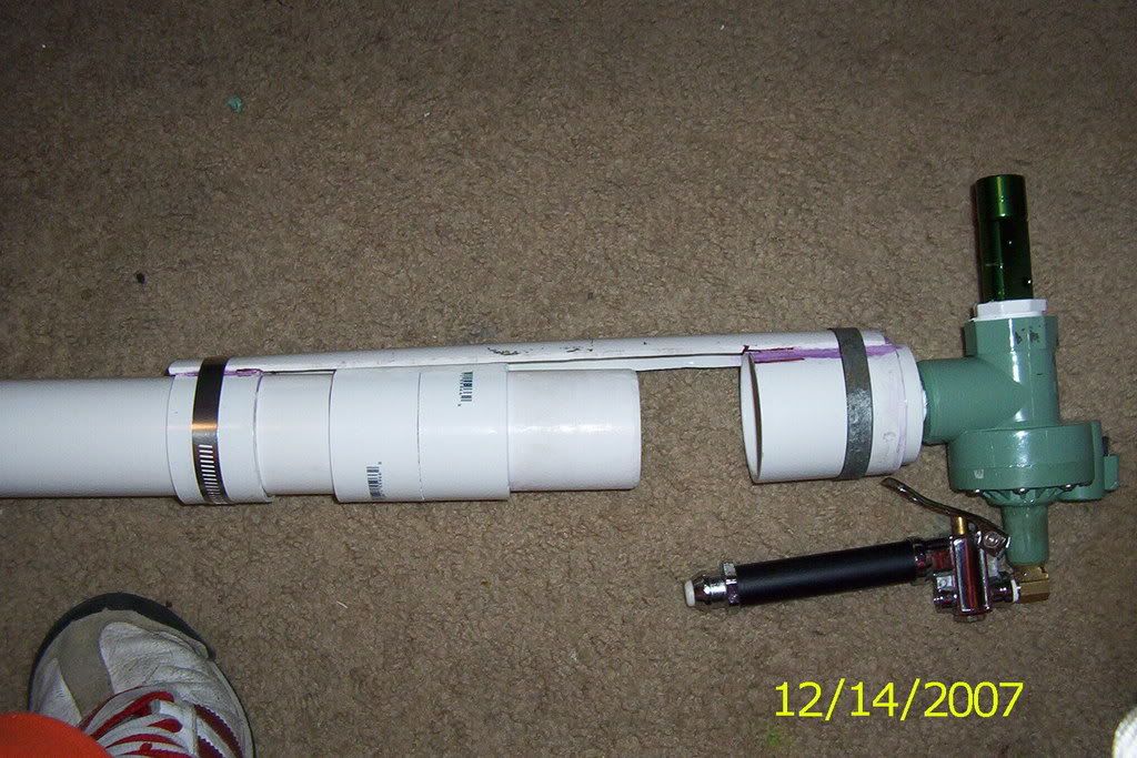

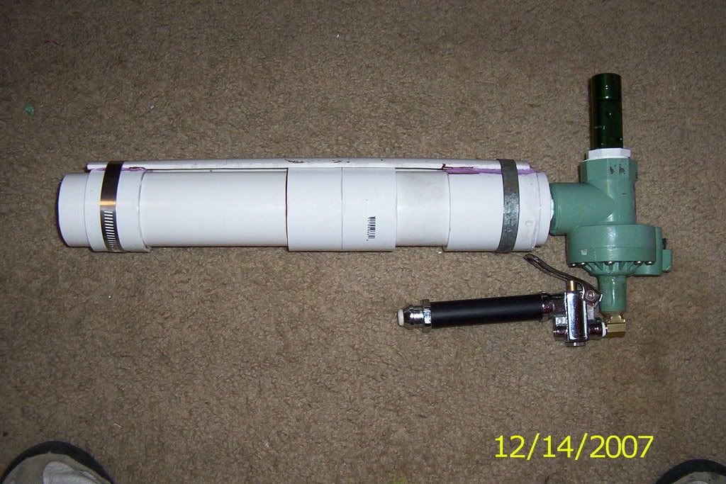

this is my new cannon for paintball it launches homemade devices that produce smoke without fire or paintball shotgun loads its breeched loaded and is powered by a co2 quik change adapter for paintball guns(not shown in pics) good
<a href="http://photobucket.com" target="_blank"><img src="http://i234.photobucket.com/albums/ee22 ... 1_8030.jpg" border="0" alt="Photo Sharing and Video Hosting at Photobucket"></a>
<a href="http://photobucket.com" target="_blank"><img src="http://i234.photobucket.com/albums/ee22 ... 1_8029.jpg" border="0" alt="Photo Sharing and Video Hosting at Photobucket"></a>
<a href="http://photobucket.com" target="_blank"><img src="http://i234.photobucket.com/albums/ee22 ... 1_8028.jpg" border="0" alt="Photo Sharing and Video Hosting at Photobucket"></a>

Very low chamber volume means less power and more pressure able to build up from the CO2. Be carefull...
i don't want to sound mean but, you know that sprinkler valve is not designed for the kind of pressures and cold that a 12 gram can generate, i strongly recomend using a metal pressure chamber that will 100 to 150 psi. you would als find out that with a pressure chamber the co2 will have room to expand giving it more power and distance. i also play paintball alot and have reffed alot, and no field i have been on would allow you use your launcher the way it is currently set up. and for your safety and the safety of anyone close to you please DO NOT fire it again till you make changes.

So tell me exactly how you got this gun to handle the 300 psi, or so at the very least, generated by a 12 gram?Hate to sound mean but you are on a quick path to plastic explosion.
Second,how does the breach lock?I would assume friction?

That's a very interesting design. As said before though, there are some things that need changes. I know that sprinkler valves such as that are only rated for 125 psi (the can be modded for 175 I think however). If the CO2's regulated however, I don't think you'll have any problems (of course, I've never worked with CO2).

i have been trying to design a grenade lancher for airsoft/paintball for the last week or so, and the breech loading system you got there will definatly inspire me for my design, nice launcher, it would look great on a m4/ar-15 assualt rifle
thanks for the feed back ill redesign the chamber safety
its friction lock for now until i can think of away to lock it better
grumpy how big a chamber would you say i need and take into count i want to stay as small as possible once again thanks for all the feed back its just helps me make a better cannon
it was originally desighned to go under a gunit would look great on a m4/ar-15 assualt rifle
