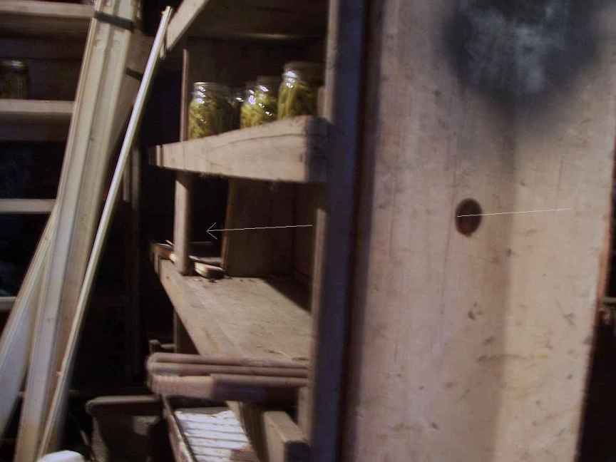

I tried 5x a few times, embedding a lead ball into a tree and blowing though 2 1/4 inches of wood planks in the process, and so I finally did a couple blank fires at 6x (indoors :)).

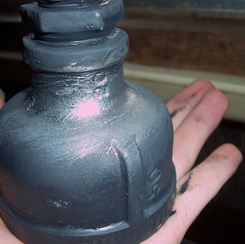

Getting to the point... I put a coat of primer on the valve and found this after it had dried.

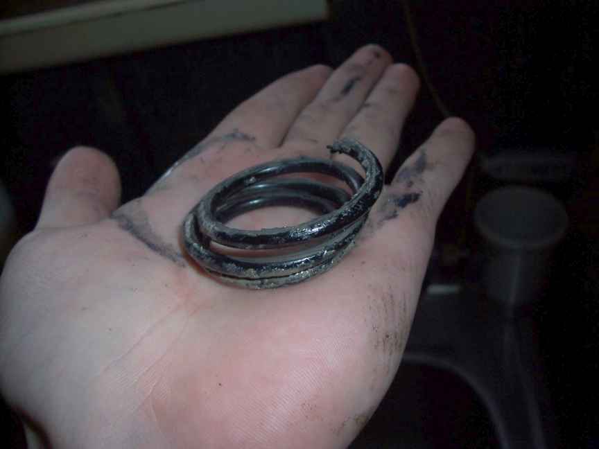

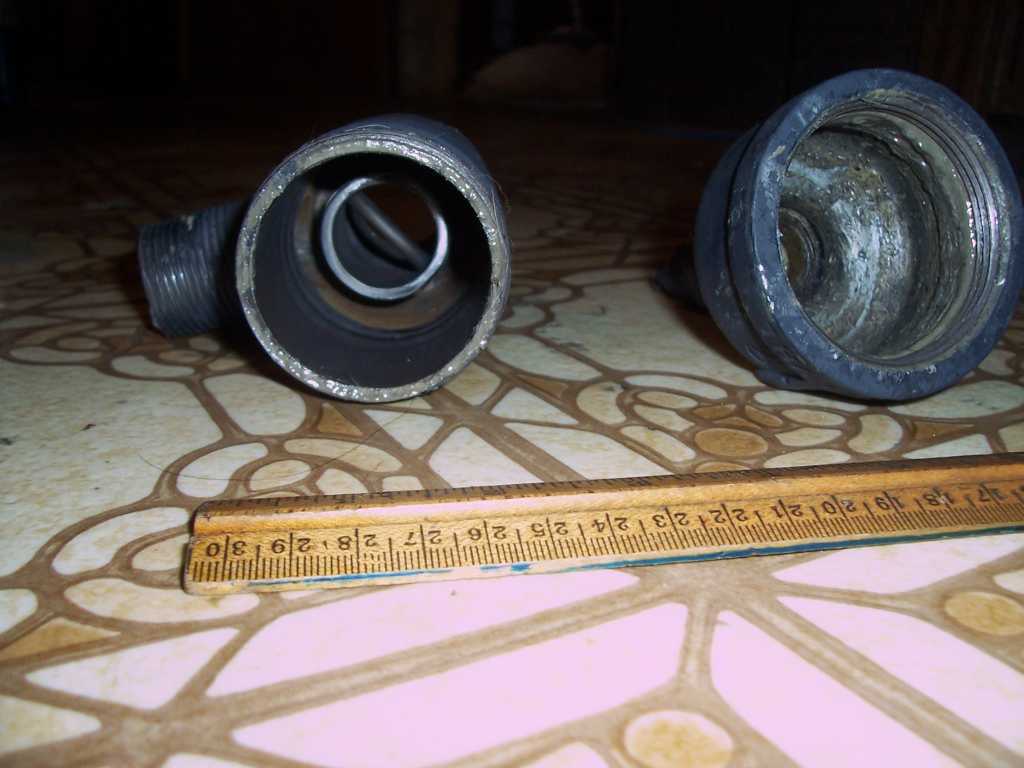

A crack had spread around the reducer from the piston impact. I put a big heavy spring in there as a bumper, but it did no good. Unless "good" is being smashed into a spring-shaped pancake.

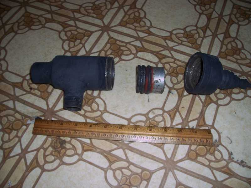

Pictures. The uploader managed to put every single one in a different order than I uploaded them in.
The crack goes all the way around...<br />Easy fix, but it probably would have hurt a bit if it flew out and hit me.

Is that a metal piston? A lighter piston would hit the endcap with a good deal less force.
Secondly, I think I see a scar on the endcap where the corner of the piston hit it. I am prone to think that the piston hit the endcap directly.
Any bumper is better than no bumper; you might try a ring of polyethylene or rubber. (solid rubber)

Wow that is actually kind of scary how flat that spring got.
