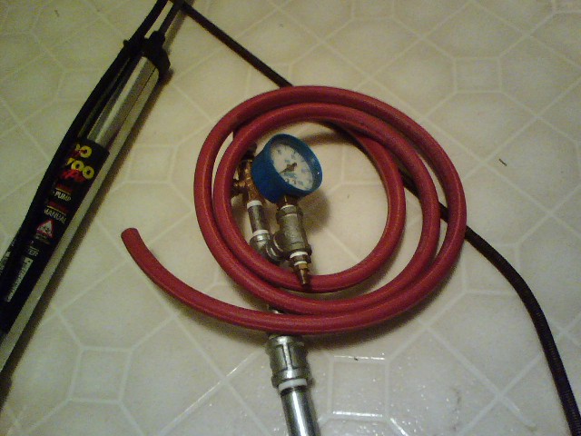

Last week, I had a sick clog. I tried a plunger, Drano, Liquid Fire, a snake...everything except calling a plumber. I was starting to get discouraged, having to deal with this in my tub for three days. Then, I remembered the thread posted not to long ago about someone using their pneumatic to clear a clog. I figured I had nothing to loose so I went to the shed and a few minutes later, I came up with the Klog Killa.
Stats
Barrel: 6' 1/4" pressure rated hose
Chamber: 1/2" x 12" galv pipe plus fittings

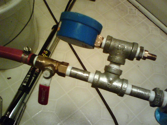

Valve: 1/4" brass ball valve

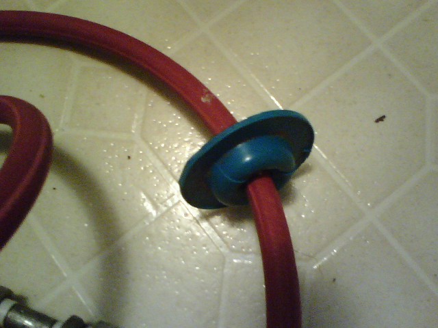

It didn't work on the inside of the house. I went outside and found the drain line and cut it. I stuck the auger in the pipe and found the clog but it would not break it up. I then placed the Klog Killa in place and secured the back flow stopper. With an 80psi burst, the clog was flushed out!
This is the stopper I used to keep back flow down
The valve and gauge setup
Pic of the barrel
Pic of the barrel

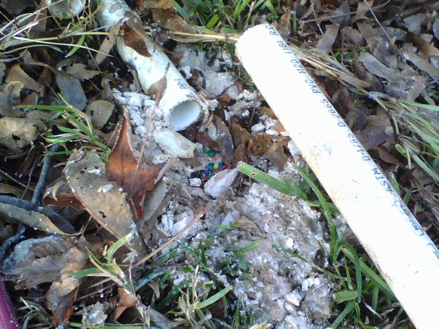

This is what came from the pipe. It includes, but is not limited to, hair, grease, grits, fish aquarium rocks, some legos, a dead fish, and anything else that is drained.
This is the only picture I have. I wanted to take one of the sludge coming out of the pipe but I was too disgusted to do so.
May be graphic.
The former clog
The former clog
