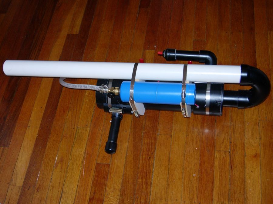

as a kid i always toyed around with the basic combustion cannon, nothing special. but after discovering spud files a few weeks back and seeing where these things have gone over the years i knew i had to build a bigger and better one
it consists of

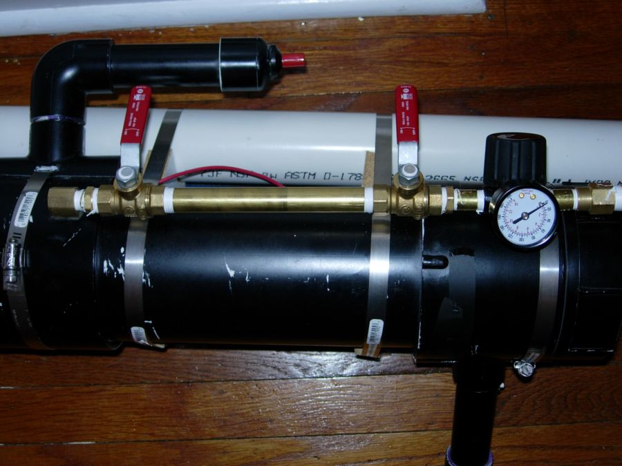

metered propane injection, meter pipe is cut exactly to length to get a perfect 4.02% in my chamber (@ 90psi)
dual ignition via bbq grill ignitor

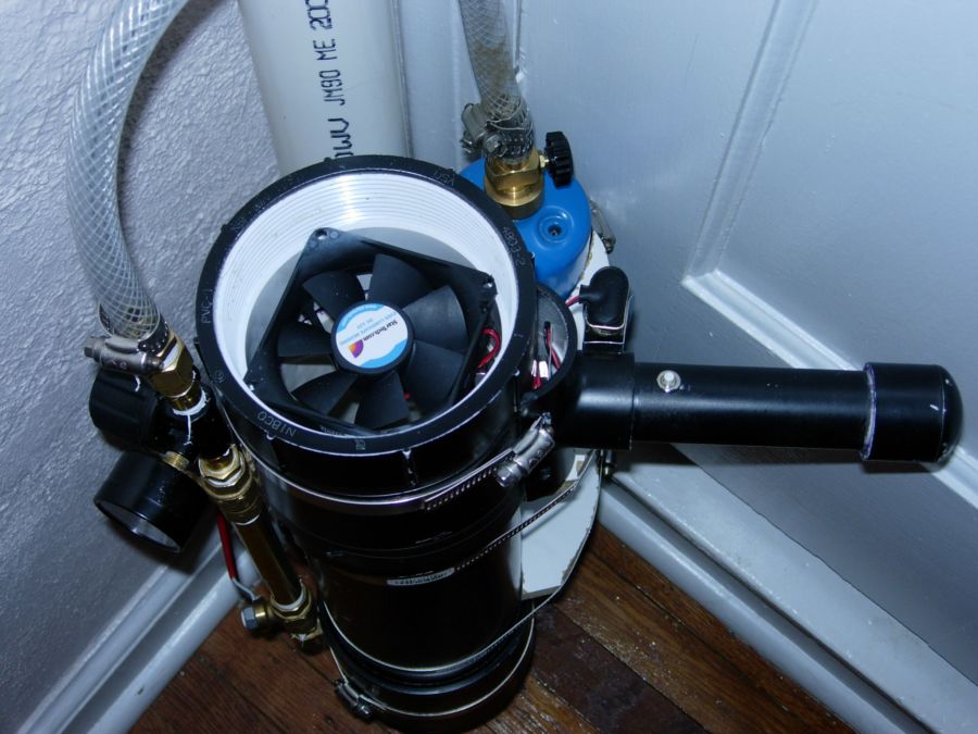

80mm pc chamber fan powered by a nine volt and a momentary switch mounted on the forward grip
so far the thing has been working great, fires every time. i had at first started to paint it but after scratching the hell out of the paint during assembly i decided to just get it together and worry about paint when the summer gets here

You do need pictures to go in the showcase. It sounds good, but I'd like to see that myself.
I should also point out that the perfect propane percentage is 4.19%, not 4.02% or 4.03% - which I see hanging around a lot.
