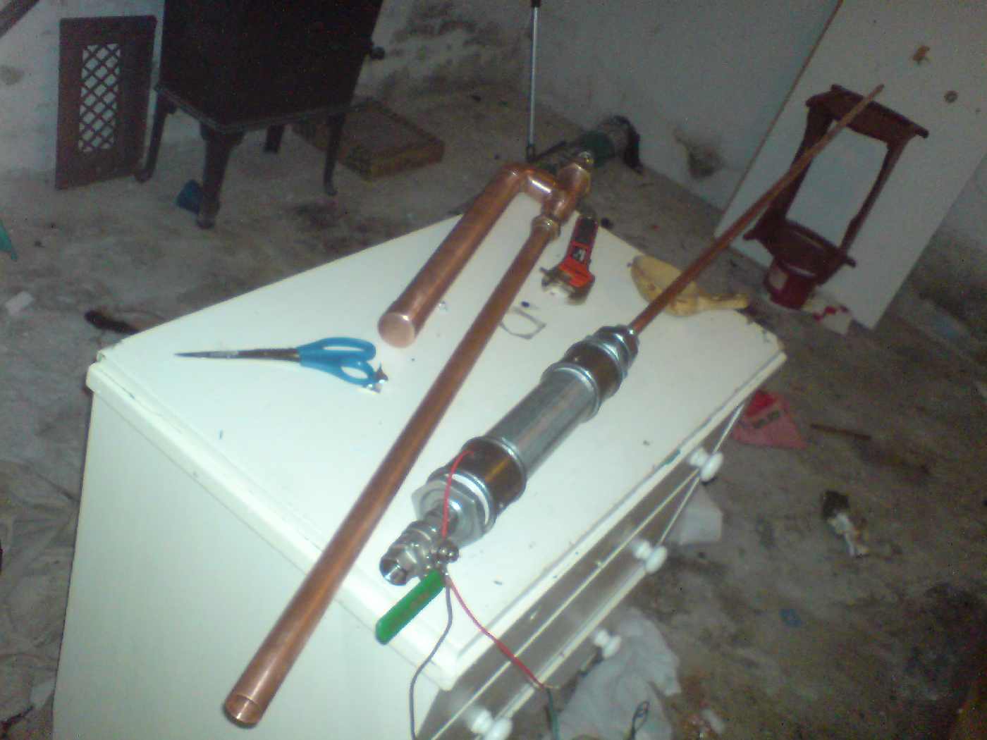

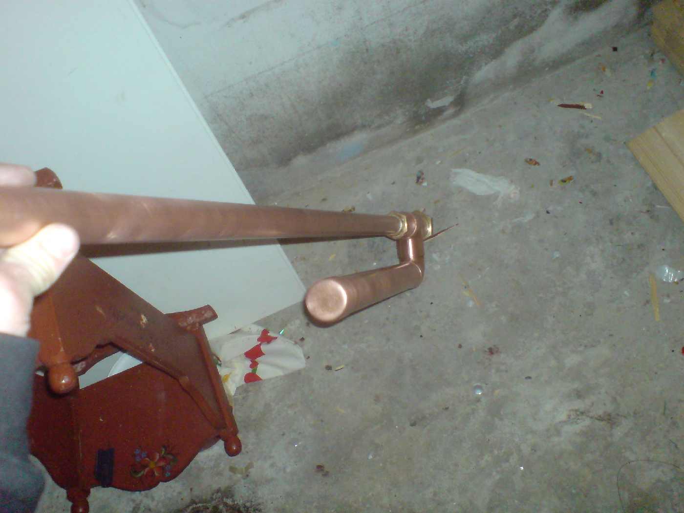

first off i want to tell that the copper pneumatic is galfisks construction but the piston that was in it cracked so i made one new.
yeah. pneumatic: the chamber is 42mm copper pipe 1.6 feet long and the barrel are the same as on the hybrid. one for marbles (6 feet) and one for small spuds and big marbles 1" copper (3feet).
the pneumatic runs on 150psi now but would be 270psi soon. the piston are made from a screw with a sealing face bacicly. i cut a piece of steel plate to fit the diameter of the chamber and put in the back of the sealing face. there are no o-rings or something the sealing face fits perfect and it is enough (pilots really well)! it has a fairly easy bumper system too. i just cut a piece of rubber hose that fits the screw and push it on. (pics to come)

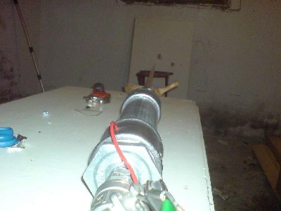

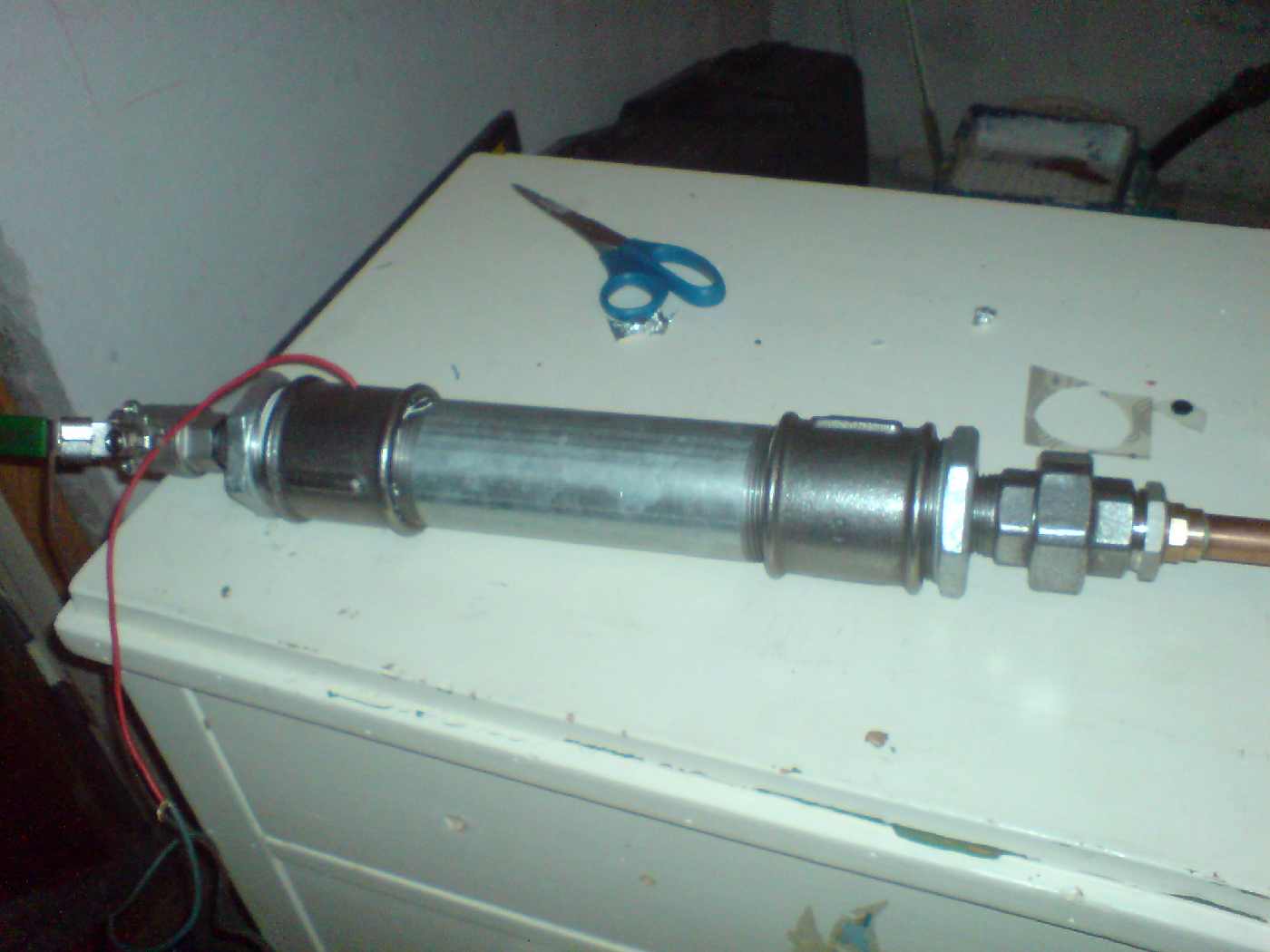

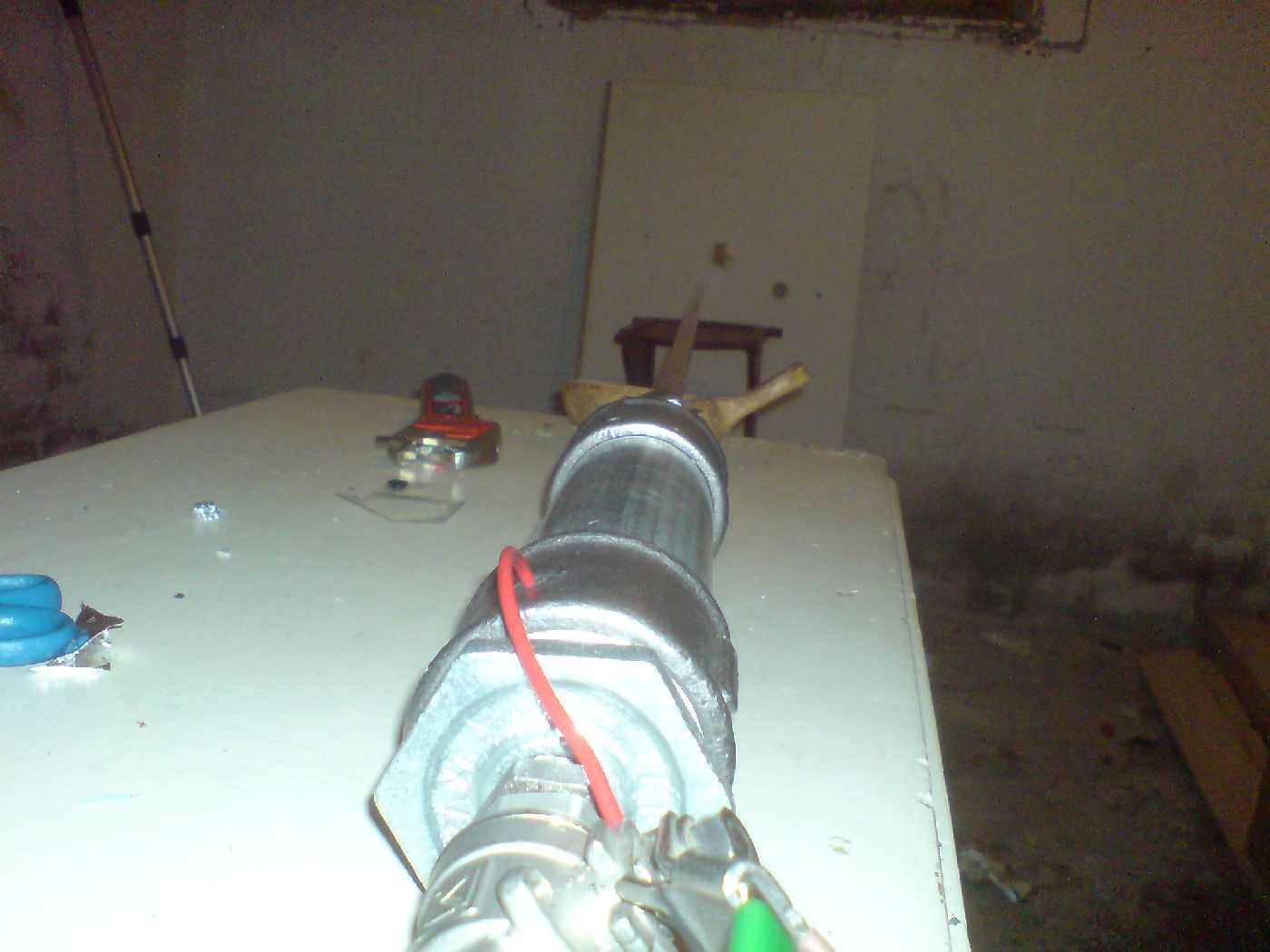

hybrid: the chamber is made out of 2" by 8" steel pipe. i used couplings to connect the bushings(?). the valve you can see is a 1/2" hydraulic valve 15000psi or so and the union is 1". it uses the same barrels as the pneumatic. the propane meter is on the way in the mail but takes a while :(

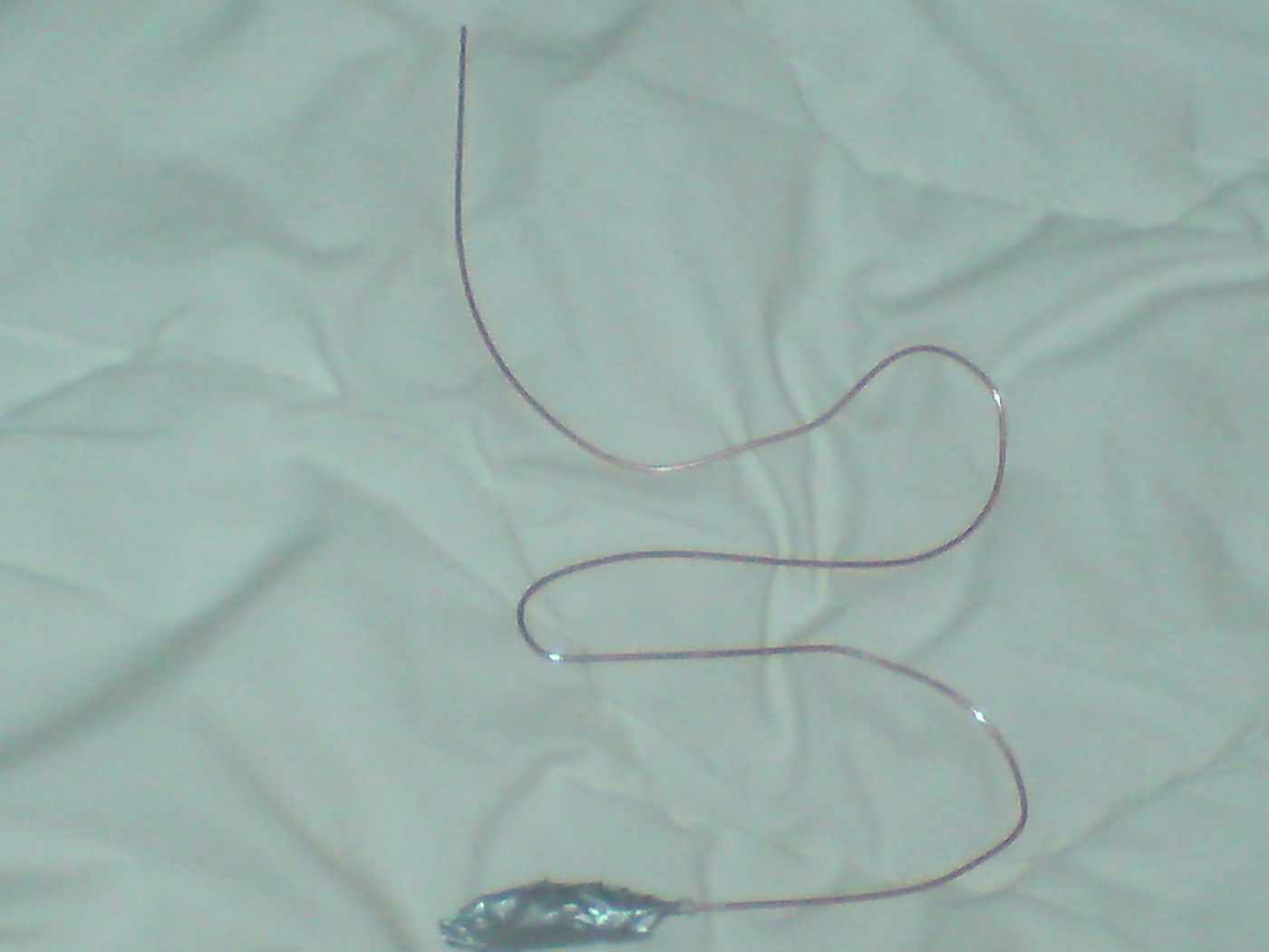

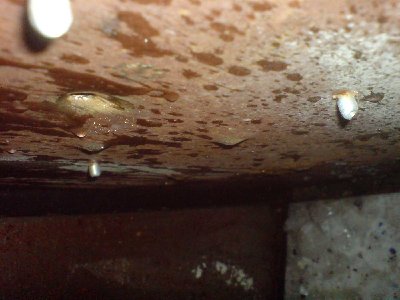

strange effect its a welding rod shot in the snow (it was hard snow)
as you can see it hit sideways

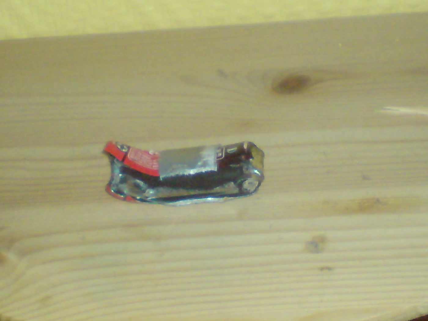

a battery shot at a steel plate (pneumatic)
size comparission
size comparission
hybrid from the back
the hybrid
the hybrid

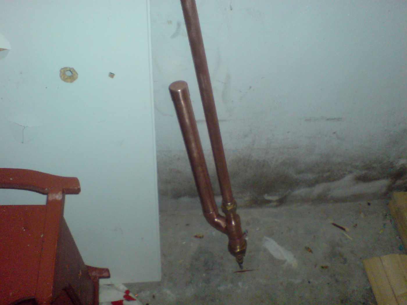

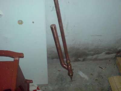

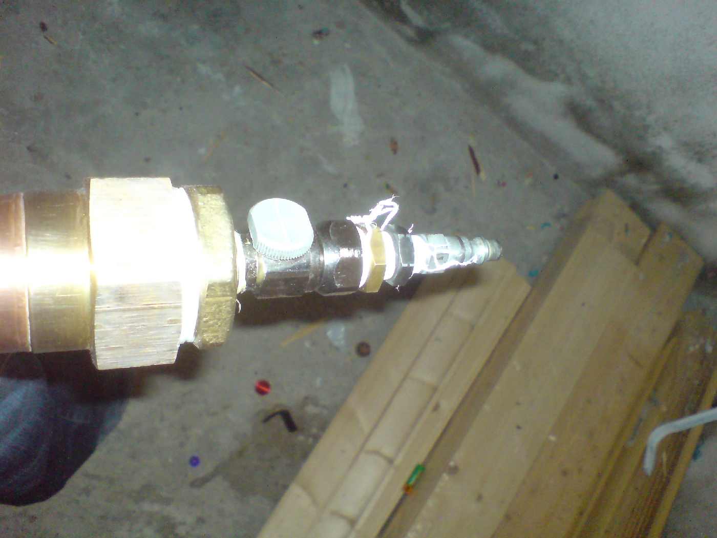

pilot (used a water valve because it has a sieve(?) in there so no dirt and stuff gets in)

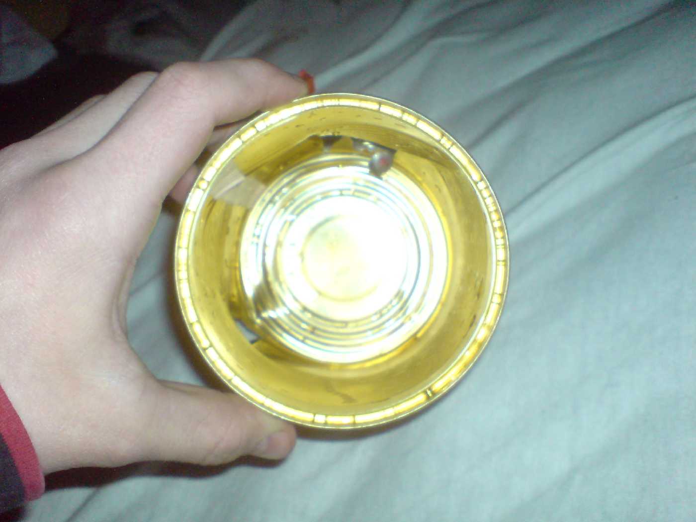

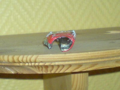

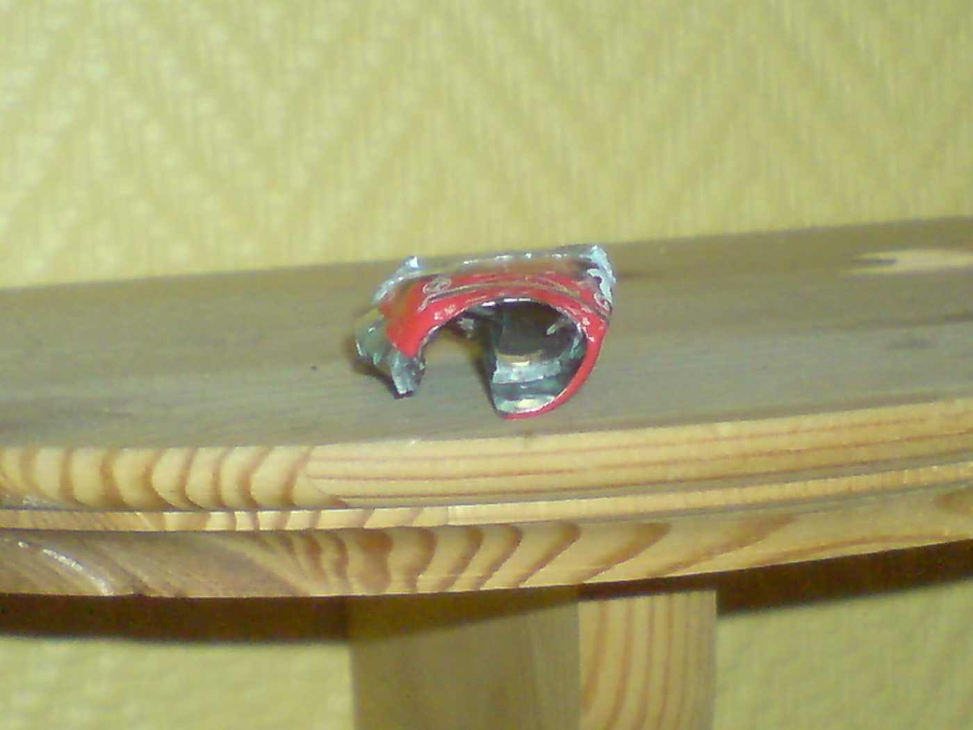

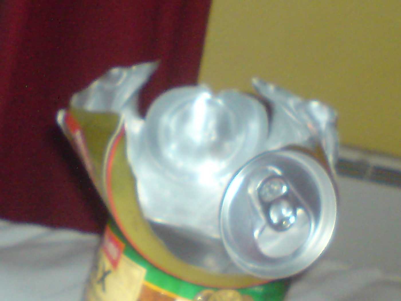

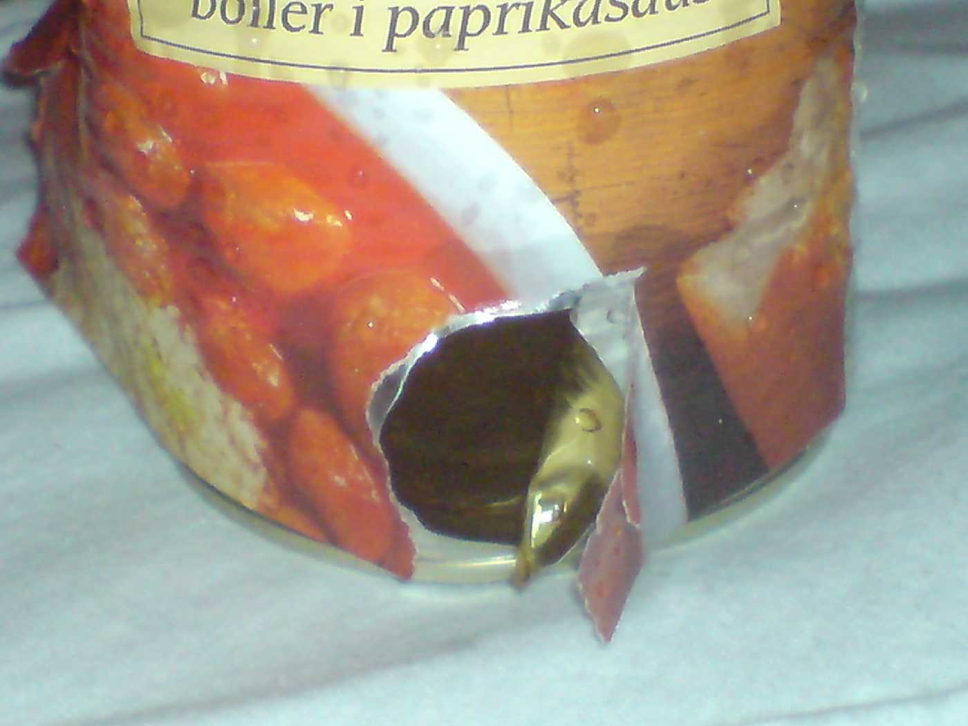

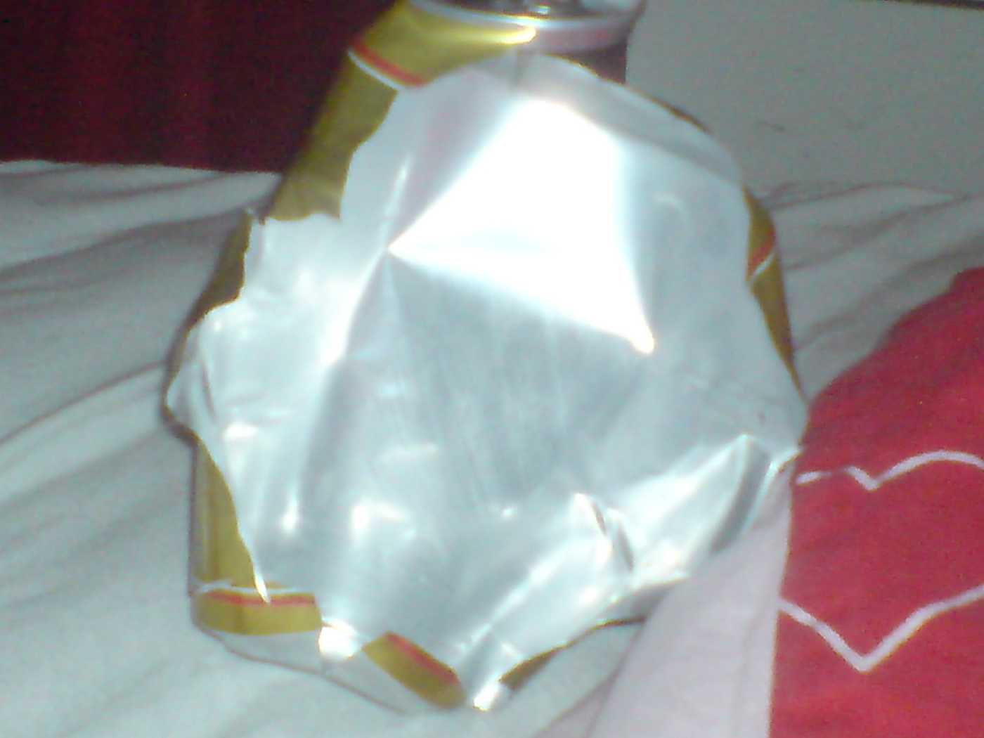

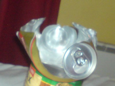

i shot a tin can filled with water and two beer cans with water!

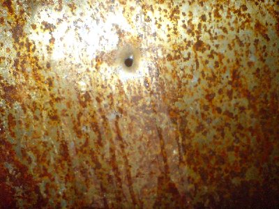

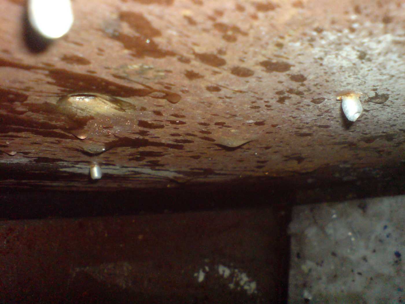

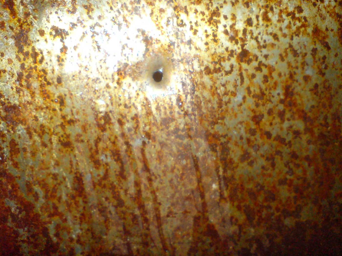

hole in steel plate!
look carefully and you can tell there is dents by marbles in the steel plate
can from above!
can from above!

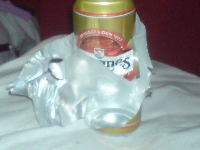

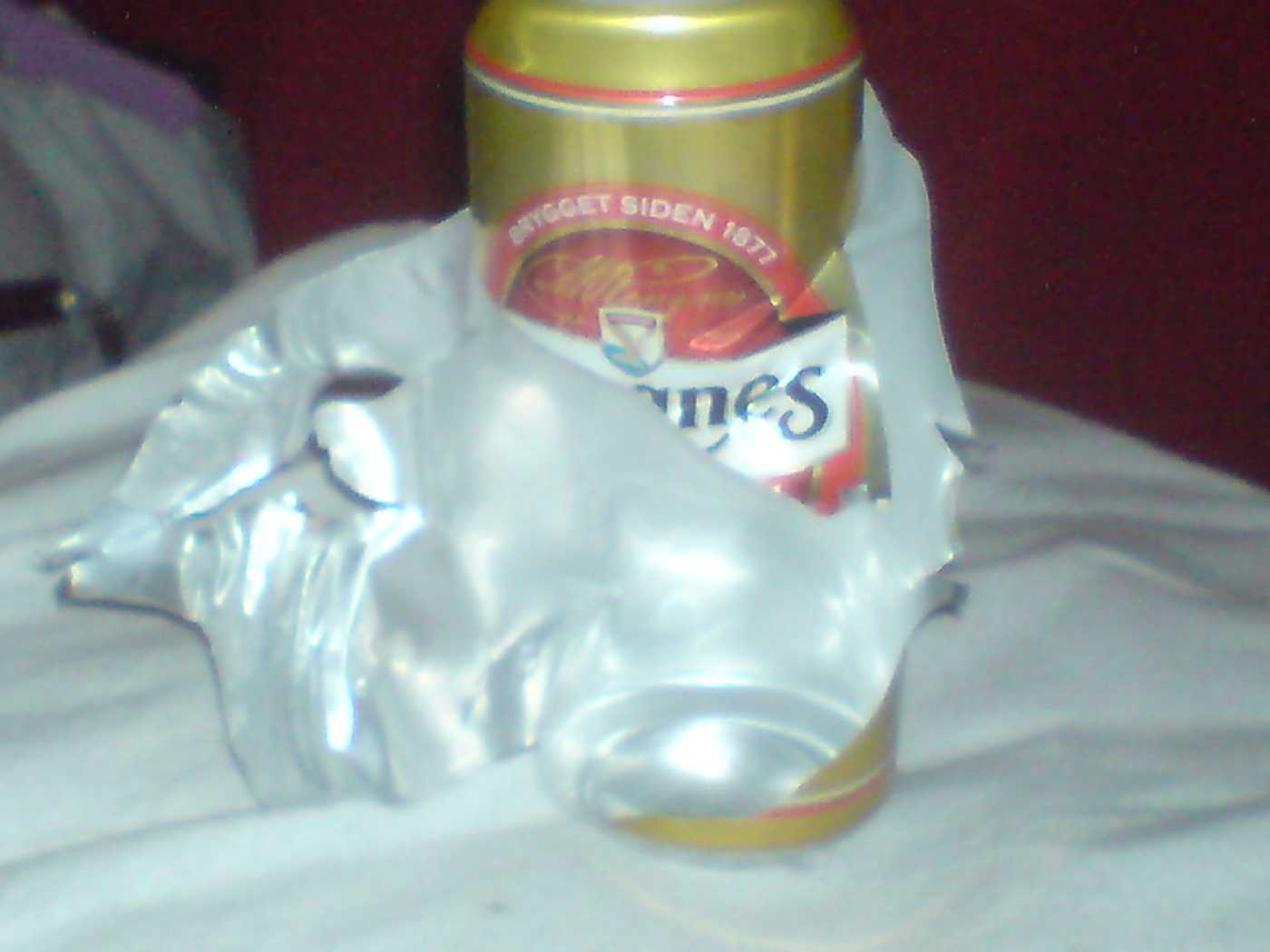

beer can shot with a loose packed aluminiumfoil ball with 1" barrel (weight 2 grams)
beer can shot with 16mm marble
exit (i like to tel when it is exit holes)
entry
entry

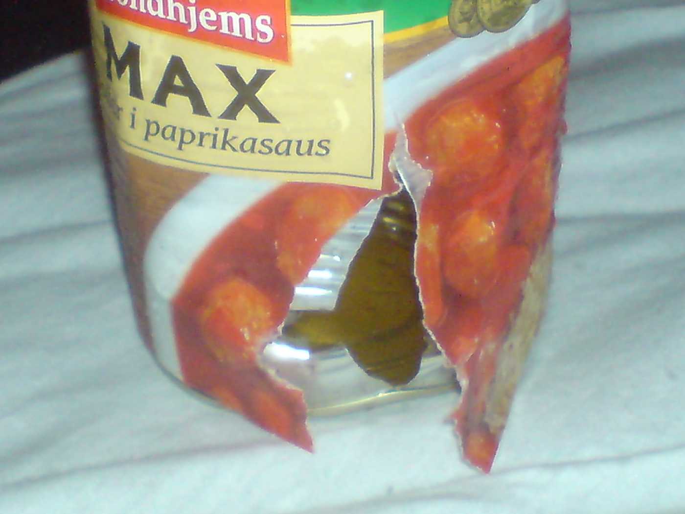

this is the tin can when shot the lid went 20 feet in the air and got cought by the wind!

Dang! what did you hoot that steel plate with and how thick was the plate? That is some impressive damage.
SpudFarm
Posts: 2571
thanks th3 and big!
the plate was a thing to hold snowmobiles up on drag races so there was a licence plate on it on the other side so i shot on the licence plate so it dented a licence and a 3 or 4 mm thick steel plate :lol: spuds also dent it but thats more like bending it! BTW it was a 16mm marble i think i could have got penetration with a 1" marble and 270psi

How is it being piloted? It looks like theres just a schrader valve the end and I'm not seeing the 'water valve' or I am seeing it and not realising how it's working.
