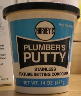

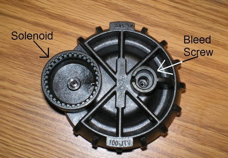

Rather than starting a new topic with close to the same title, I just revived this one, if it upsets anyone I give full permission to hunt me down and shoot me with your canon. :lol:
I got a sprinkler valve, rainbird 1" jar top. My question is should I drill into the direct middle and seal up the bleed screw hole or could I just drill were the bleed screw went?
And will this work to seal it?
daberno123
Posts: 594
Location: Ohio
I have no experience using plumber's putty but it is generally best to use epoxy. Go to your local hardware store. It comes in a dual syringe like bottle. Use that seal the solenoid port and the bleed screw port. You can probably drill the hole in the center but if there is anything in the way like a spring or a guide rod (not sure if that model has one).
