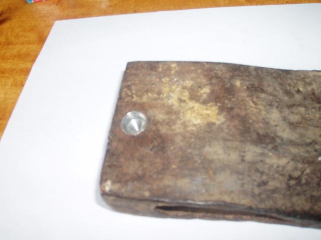

1.First of you are going to need to make your shaping die,which is important to get the initial shape of your rounds.I used an old axe head to make my die.Drilling a hole in your piece of metal till the head of the drill bit has disappeared you only want this to be about 1-2millimeters past the cutting head.

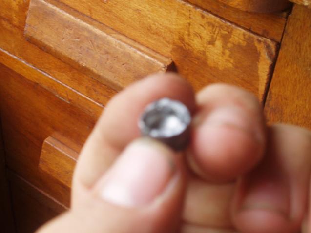

On the left,good slugs and on the right some ones that were not so good,but practice makes perfect.
Nice look into the Base.

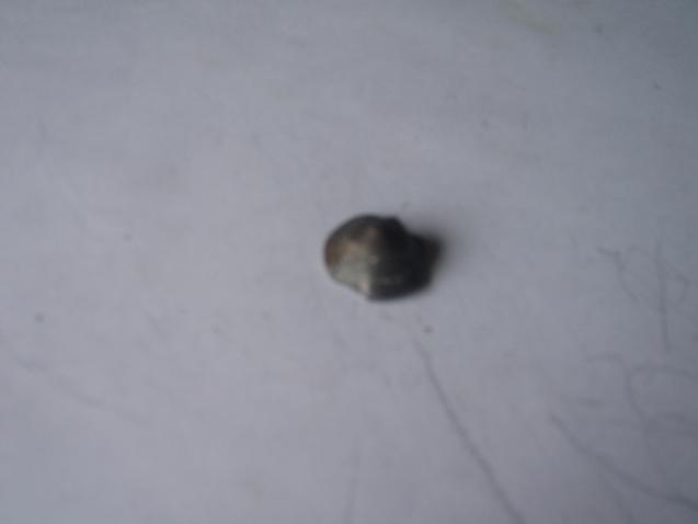

Flowerd looking round before it goes through the pipe

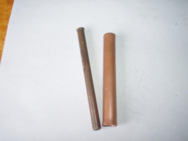

My Metal Rod and Tube

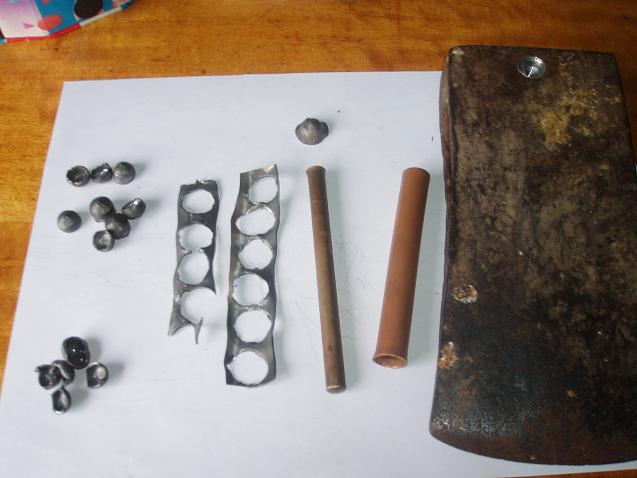

All of my things,including some cut out sheets.
My Die,the hole is a little to deep though.

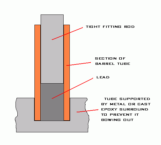

I think you're going to need them a bit longer than that to be effective both at sealing in the barrel and for stable flight. If I could make a suggestion as per the diagram, first hammer the lead into a cylinder that fits the bore exactly, then drill out the base for a hollow tail. A simpler way of doing this if you have the facilities is to just drill a calibre sized hole into a chunk of metal.

jackssmirkingrevenge wrote:If I could make a suggestion as per the diagram, first hammer the lead into a cylinder that fits the bore exactly
Lead doesn't bind to itself through hammering, has to be a molten lead job for a good cylinder.
But yeah, having a cylinder and then drilling it out is what I'd back for making a hollow tailed lead slug.
