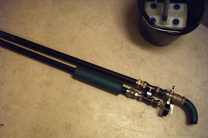

I built a pneumatic riot gun I sleeved the steel pipes with rubber inner bike tube.Very effective against scratches and such on a metal gun.Makes it look cool too.Satin black.

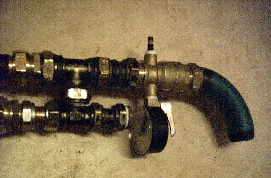

Reservoiris stainless steel, the one that holds the piston and the barrel aren't because the steel pipe is'nt smooth on the inside so I had to use copper.That curved piece came from an ab-roller as well as the foam grips.
I planned to rent a pipe bender we have down here as a simple plumbers-tool to bend copper pipes.( hand held thing)The ab-roller was just collecting dust so I thought it might be cheaper just to use that.It turned out better that I expected because the diameter is also 28 mm.No pipebenders are available in that size.
At first I wanted to get he sawed-off look but I won't get a lot of power from a short barrel.might lookawesome though...
I modded some of the couplings to fit into one another in order to get it this slim.If you look at the middle picture you might see that the bottom tee is fitted into the top one.
