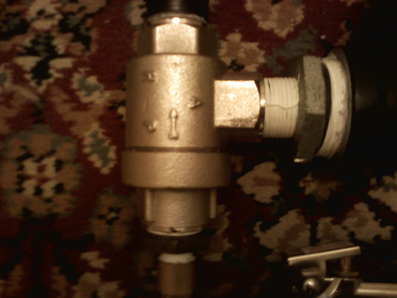

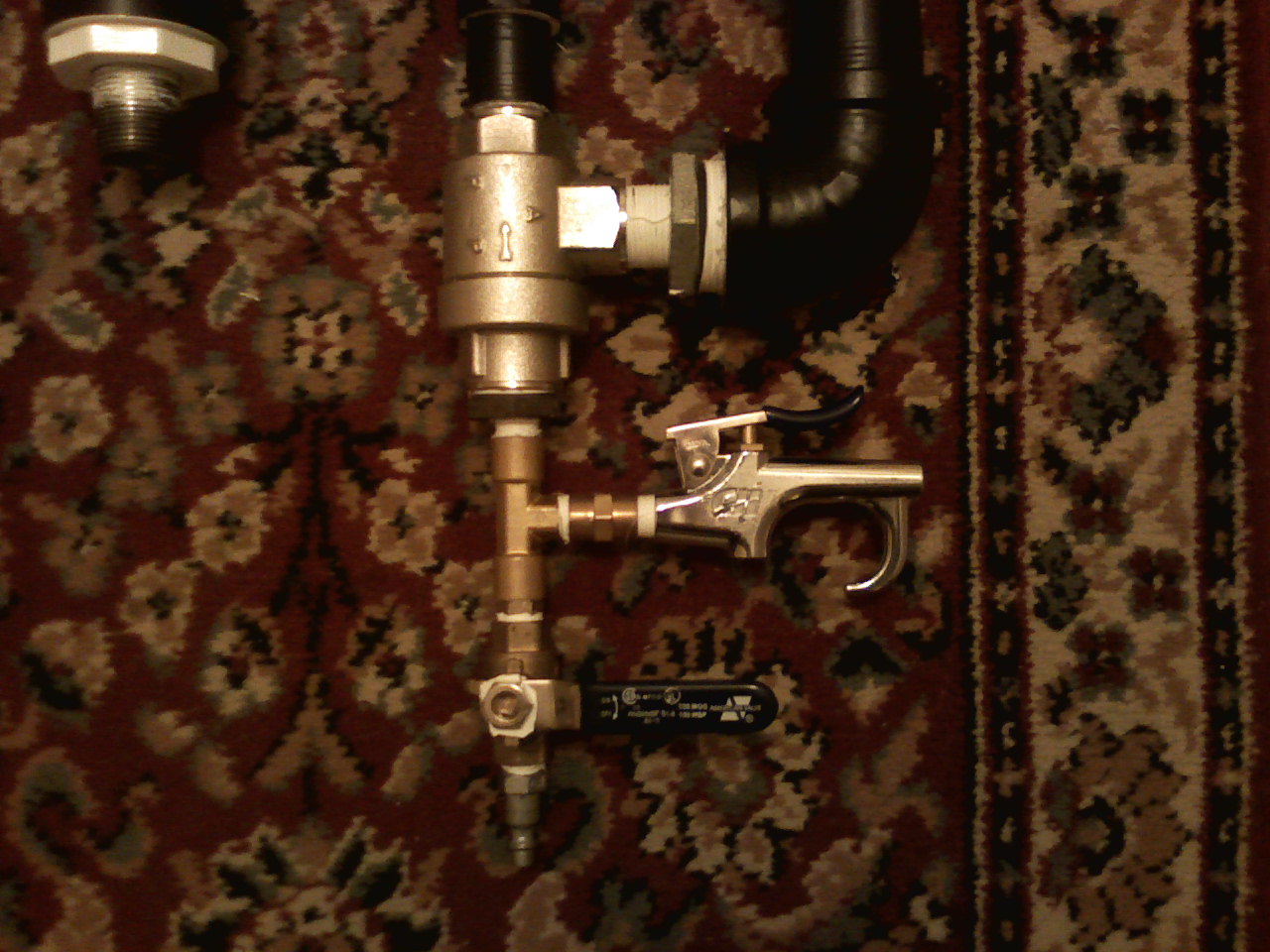

The valve/pilot/fill assembly
The valve
The valve

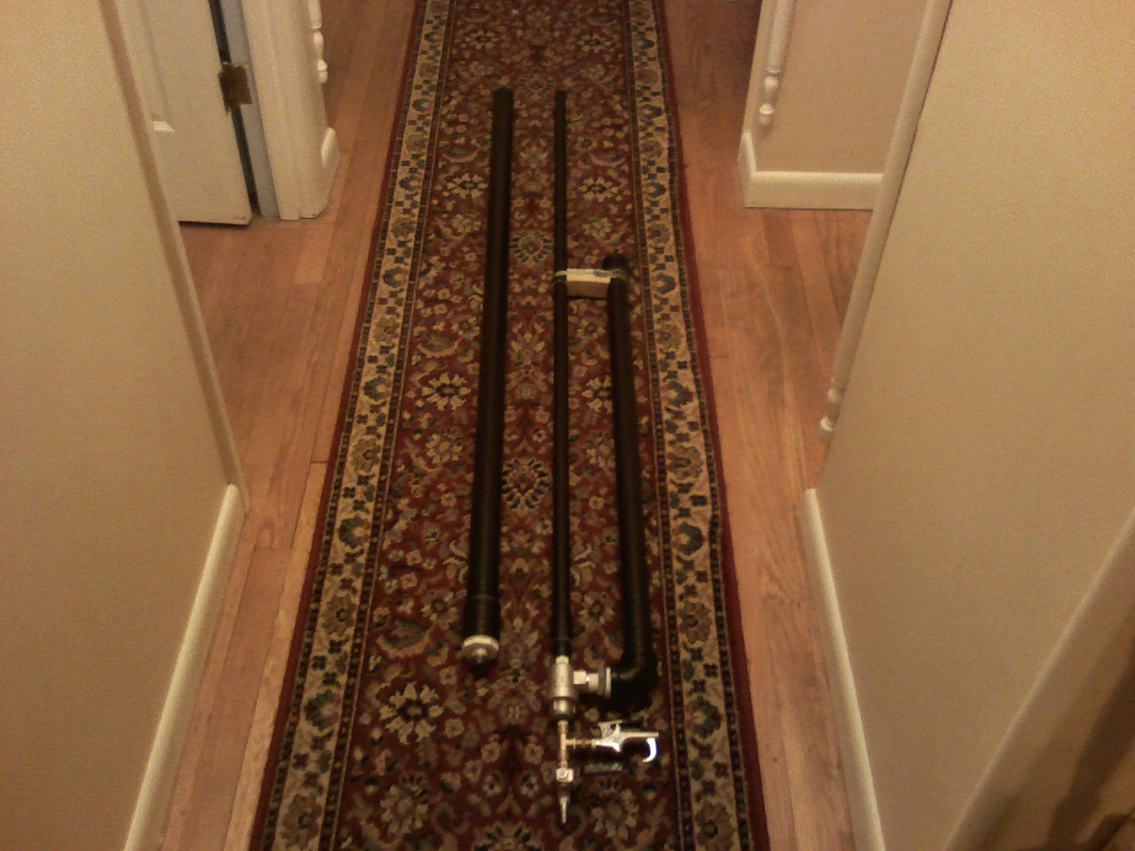

The gun with both barrels
The rifled .75" barrel

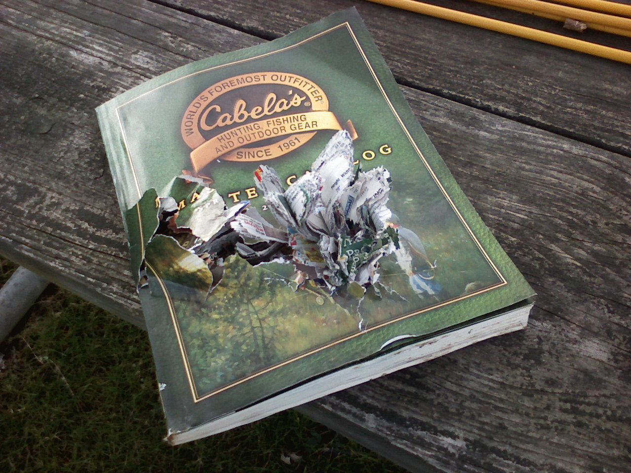

A video will come soon, I have most of it finished already, but I do have one damage pic, it's not that great, but it's all I have. I may get a shock pump soon, but I don't think it would be fun to pump the chamber up past 200 with a shock pump. The rifling seems pretty effective, I shot a metal slug at a magazine, and the slug has streaks of color on it (I'm guessing that it's from the print on the magazine) and the streaks are twisted down the side of the slug, which would mean that the slug was spinning when it hit the magazine.
Where a metal slug went through a magazine

to make the rifling more effective i would put some more grooves in, other than that its a cool launcher, also to make use of the rifling you should try it with non-spherical projectiles that will grip the rifling (a similar shape to an air rifle pellet) :)

Now why would you do that to a Cabela's catalog? :lol:

How did you rifle the barrel? Did you apply the good old dowel and nail? Also, I'm also curious as to how well the rifling effects accuracy. Nice job by the way.

@pvc arsenal: The magazine was a little outdated, so it had to go. (plus there's always the Cabelas website)

@noob of noobs: I did use the dowel rod/screw method, except I sharpened the screws at an angle so that they would twist themselves when they went down the barrel.
