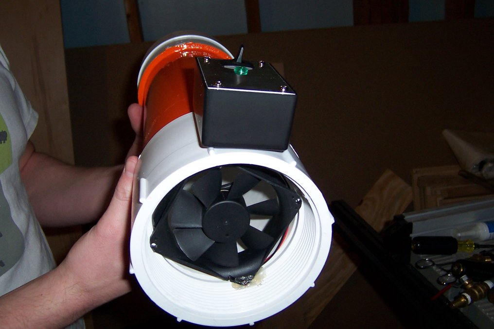

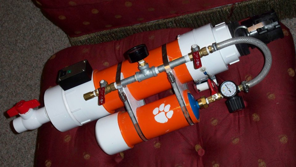

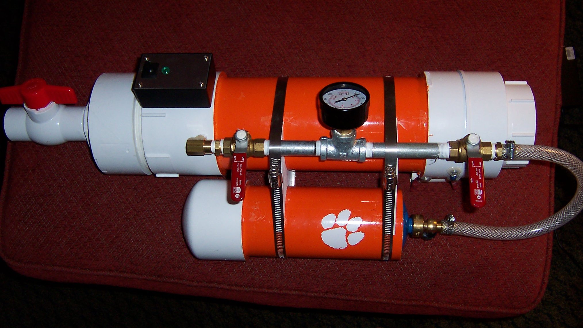

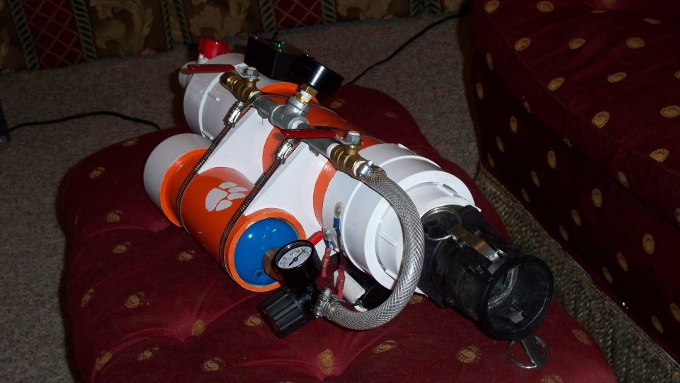

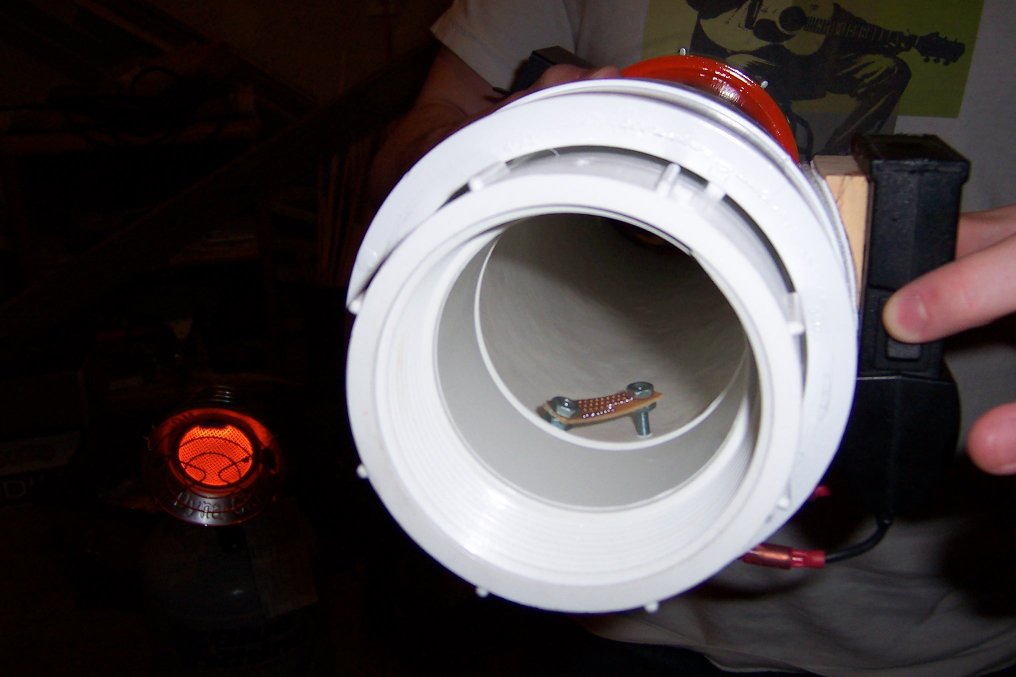

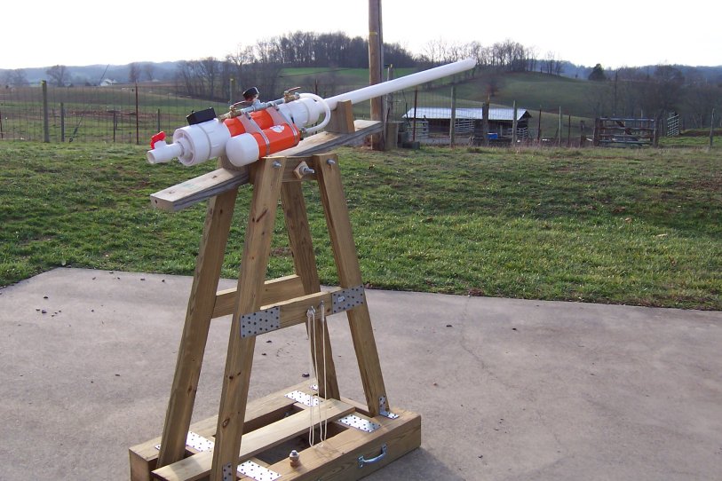

My son and I decided around Thanksgiving we wanted to build an advanced combustion gun over the Christmas holidays. We had built a couple of the basic hairspray models in the past years so we thought it was time to move up. The outcome was basically a slightly large Latke model L3 with a few personal touches. Nothing really innovative here, but a pretty nice presentation, if I do say so myself.
Features are:
- All "pressure rated" parts (please spare me the noob smackdown)
- 3800 CC chamber
- Standard ball valve propane metering
- Magnetic propane tank holder
- 3" combustion chamber opening with screw on interchangable barrel feature
- Stungun ignition, with multigap circuit board for spark source
- 80mm computer case fan, with 9v battery and switch mounted in project box
- 1" Ball valve rear air intake
Everything else is pretty much self explanatory in the pics. I've built a 3.5 ft, 1.5" general purpose sharpened spud barrel, a 3.5 ft slit 2" sched 40 sleeved in 2" sched 40 golfball barrel (man that was a job), a 5ft 2.5" tennis ball barrel and a 26" 3" tee shirt barrel. The only one of these that is optimum is the 2.5 which is roughly .8/1 ratio.
Shooting this thing is a little awkward in that we almost totally ignored human ergonomics in the design, something that won't happen next time. However, because the meter pipe is so well anchored down, it became a handy right hand holder with the left operating the firing stungun underneath.
While I haven't been able to do any performance testing, both golfballs and potatos exit Out Of Sight very quickly. Given the area we were shooting, I would estimate around 250-300 yds for the potatos and 350-400 yds for the golfballs. Tennis balls about the same as potatos. Haven't tried the tee-shirt barrel yet.

Oh yes that little spud barrel is only 2.5/1, so I figure I'm only getting about 1/2 of my ultimate performance out of it. However, a 1.5/1 barrel is 87" and a .8/1 barrel is a manly 164" long...definitely special setup to test. This was purely for wowing the family which it more than did....yes it was nice and loud, about 16 gauge shotgun loud, not quite 12 gauge loud.
The golfball barrel obviously needs to be longer as well...Oh well that's what I get for going with a big chamber....

One slight niggle with it is that I can't see any pressure regulator in the metering system, which will mean that the changes in propane pressure from temperature changes will affect performance on different days. On warm days, your mix will be overly rich, and lean on cold days.
But, it will still be a lot better than the old spray can, which is very imprecise.
And I'm sure you and your son will get a lot of fun out of that.

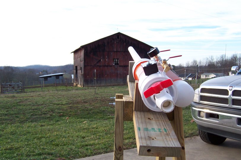

The stand was actually a trebuchet this time last year...one of those engineering week "see who can chuck something the furthest" kind of things. We just adapted it for artillery this year..MrCrowley wrote: Love the stand too

Yes very true. We were running out of time...I couldn't get my propane adapter threaded...Lord knows I tried hard enough. I have the regulator on the shelf awaiting next project.Ragnarok wrote: One slight niggle with it is that I can't see any pressure regulator in the metering system, which will mean that the changes in propane pressure from temperature changes will affect performance on different days. On warm days, your mix will be overly rich, and lean on cold days.
I finally gave up on the absolute precision and clamped the hose directly on. My ideal gas load is 73 psi for this meter/chamber, which I can easily get if the temp is 55 F or above. Just have to quickly diddle the ball valve on loading... Its been far too cold of late...

You should get spark gaps in different places in the chamber.
(like one in the front, one in the back and one in the middle.

Thanks! Yeah I was running out of time on that as well. Rather than quickly rig something up I would be unhappy with, I kept it solid and simple. It's actually very reliable.psycix wrote:Nice nice!
Very clean constructed!
One suggestion:
