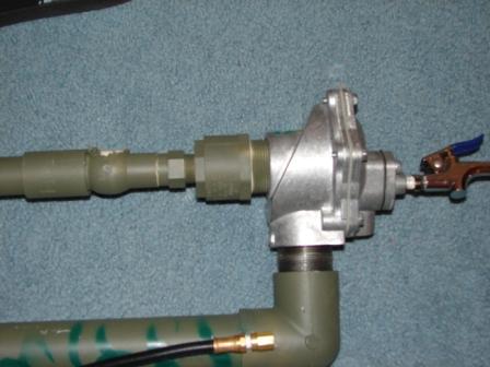

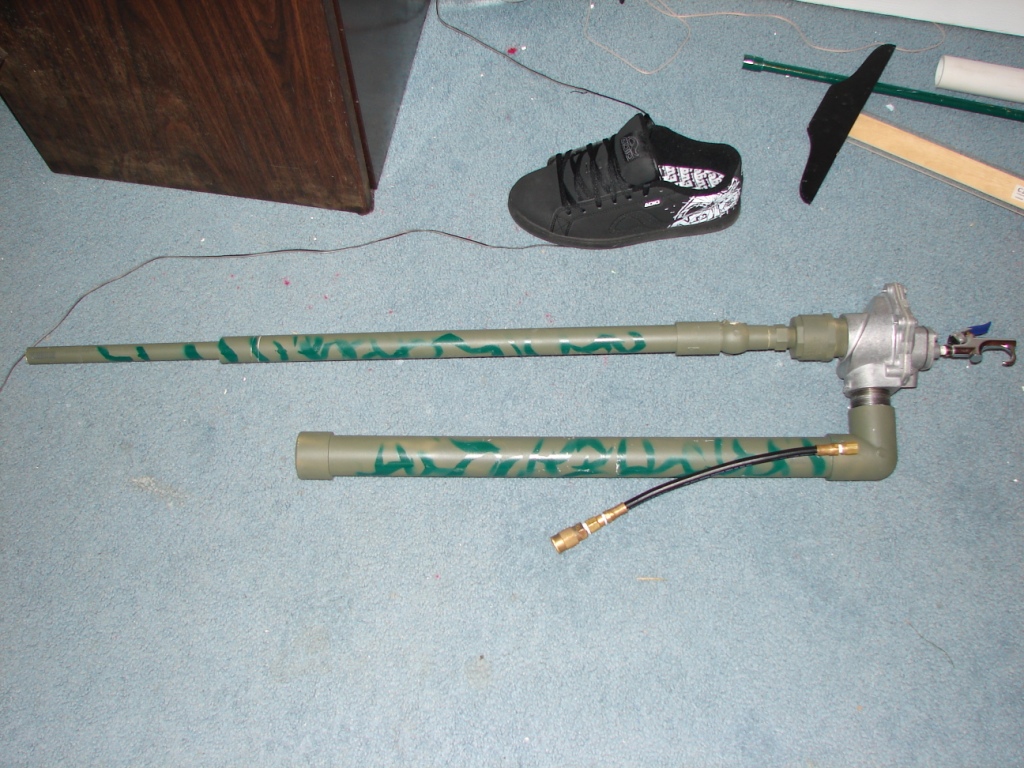

This cannon was built for the sole purpose of using the new valve which I got off ebay. Its a 1.5 inch porting Asco QEV. The barrel is 3/4 CPVC and it uses a ball valve as a breech and the chamber is 1.5 SCH 40. Charged to about 100 psi, paint balls do all sorts of crazy things. Sometimes they shoot left, other times they go up or down. So this gun's accuracy is miserbale basically, as of now it is to cold to test it outside so no damage pictures.
- Close up of the valve and fill port.
- DSC01460.JPG (24.31 KiB) Viewed 5087 times

Very nice but, again, why the shoe?

Your launcher looks good, but it could use a barrel support. Try using some saddle tees.

Don't expect to get any accuracy out of a 6/8" CPVC barrel.Especially with small paintballs.Try using the really cheap stuff and it might help out.White box will be your best friend for large bores.

Yea I am trying to be one, and yea my calculator does everything. And yea someone mentioned that before but I am using pretty cheap paint balls anyway so who knows. The cannon itself is hard to aim so most of it is probably me.

Don't feel bad about inaccuracy.My piston gun wouldn't shoot a paintball worth a flip.Ever think about using an old spyder barrel or something?And like PVC Arsenal said;barrel supports help out alot.

Try something that isn't a paintball or for that matter, spherical, I'd expect an increase in accuracy
