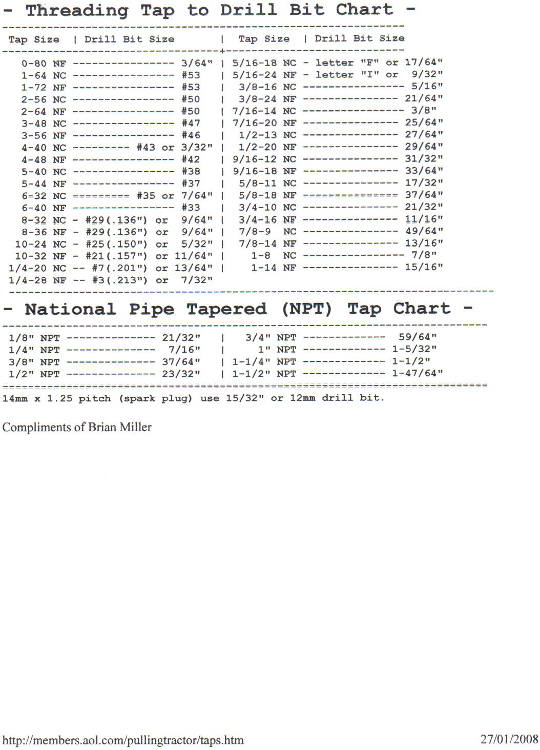

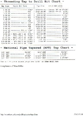

Gippeto
Venezuela
Posts: 2504
Been thanked: 17 times
"you'll need a half inch drill bit for a 1/4" barbed hose connector. "
The correct drill size for 1/4" NPT is 7/16" not 1/2"
