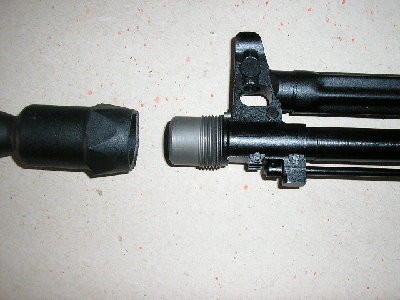

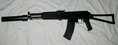

I've done this before to make the silencer for my CO2 AK, make sure all the contact areas are greased well, but not too much or the thread cast won't be deep enough:
