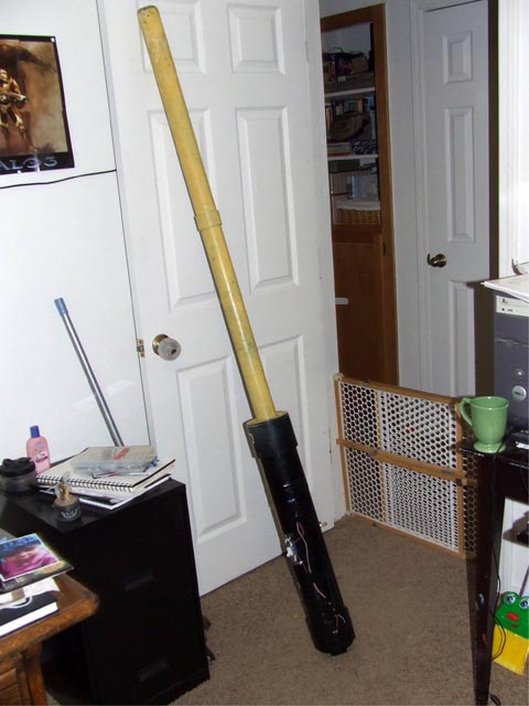

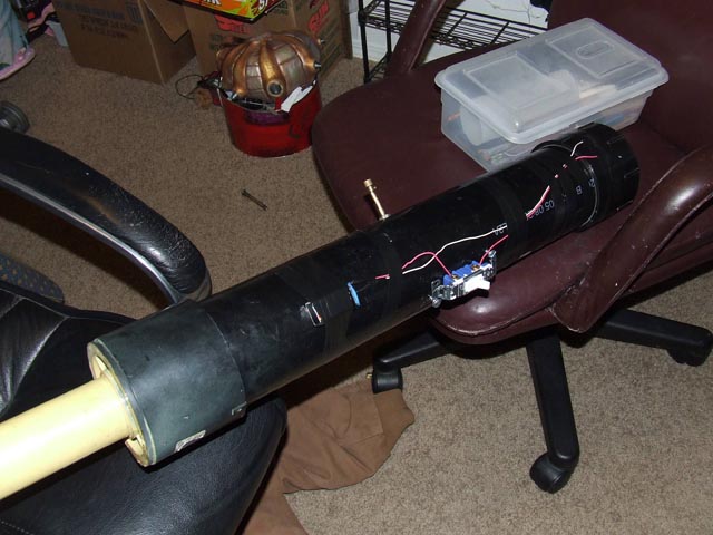

Hey all... my first cannon. first post too. I built this about 2 years ago after remembering a cannon that my friends dad had. It was around ten years ago, but I remembered the basics of how it was put together so I decided to build one. It has a 2 foot by 4 inch chamber and 4 foot by 2 inch barrel. I use a lantern flint thing I got at a local hiking store for ignition (works great, twist and fire). for fuel I found this stuff my mom uses called "nail polish dryer" by beauty secrets. I know its sold at a sally beauty supply store here ($2.90 a can). The stuff works great, better than any deodorant or hairspray I have come across (its top 3 ingredients are butane, propane, and SD alcohol 40-B)...

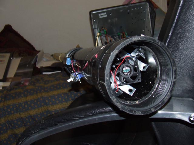

I recently found this site. After reading over it for a good few weeks, I decided to put a computer fan in my chamber (complete with ugly exposed wires and a 50 cent generic light switch, but i am broke and I find sexiness in good results from ghetto solutions). I must admit, I am glad I put that fan in, it cost me about 5 bucks to implement. Now it shoots more consistently and noticeably more powerful. Last time I took it out I put a potato through a 5/8th piece of plywood no problem and some ammo I made out of washers did a lot more damage than that. I love it! (next time I go out I will get some pics and maybe video).
